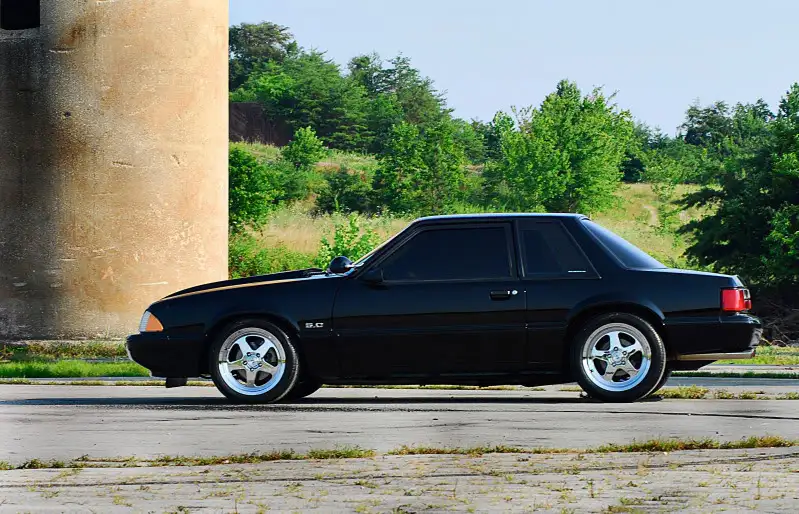

  16. This is my car with B springs, I have no complaints.
  17. Oh my....:nice:
  18. That notch is just... :drool:

  20. Looks great!! :nice: I really like the rake it has!
