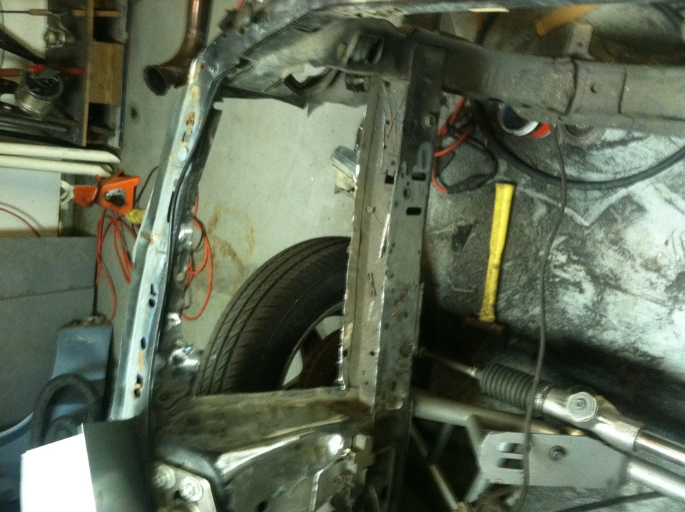

    @madmike1157 the holes took 10 mins to weld up... or it just seemed like it, but they were numerous. The '87 LX that I dissected was sold for scrap and I picked up the '85 coupe for $700. The body is straight and it's a 4 eye coupe - less work in a better looking car. This happened about 6 months ago.

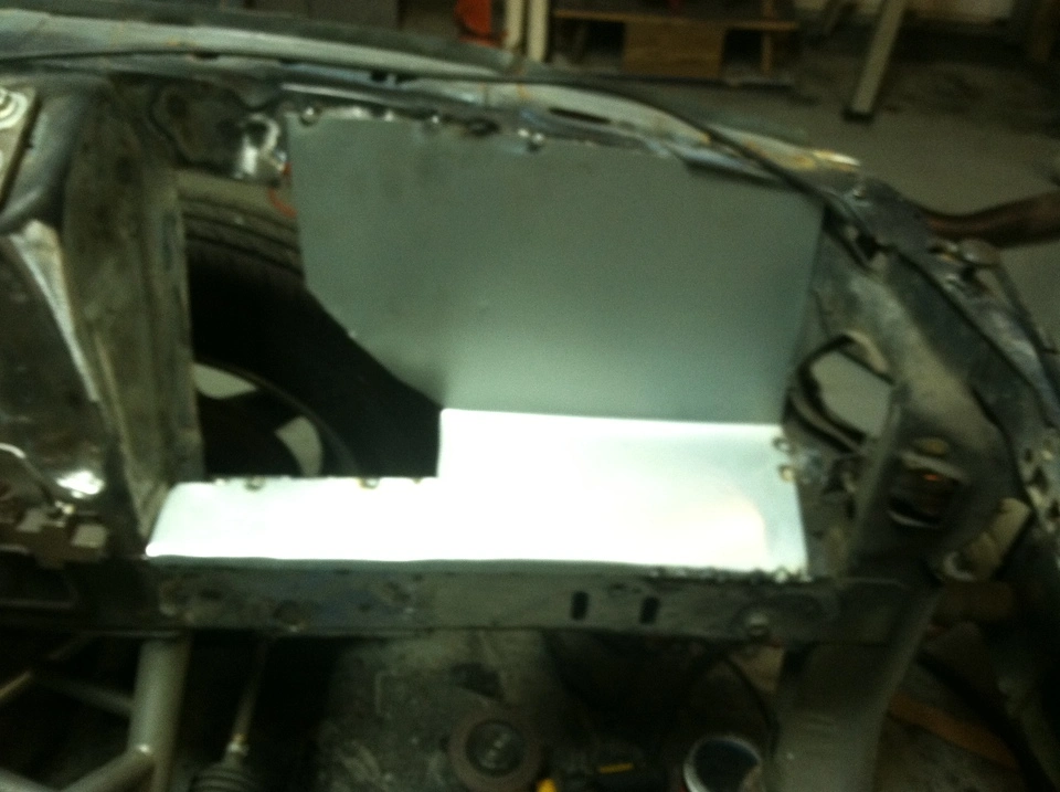

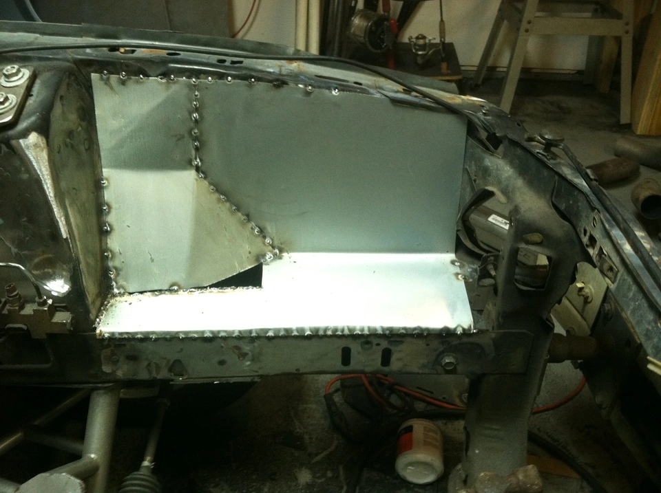

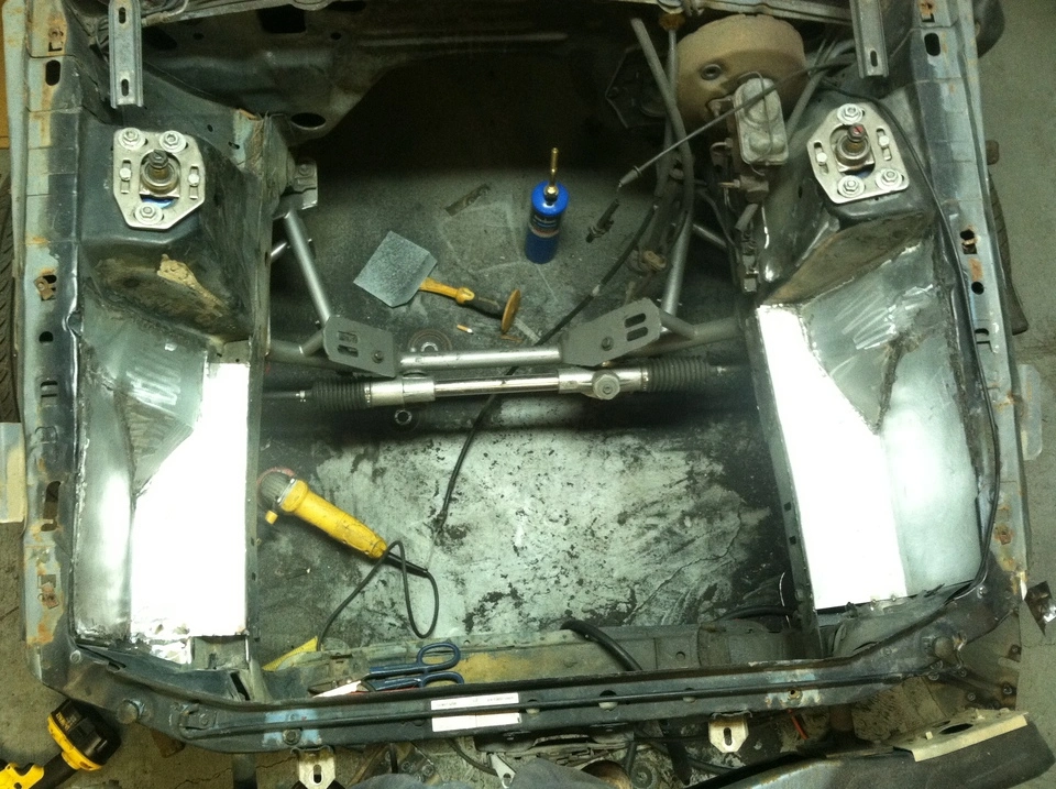

  6. I simultaneously gave up on filling holes and buying Scott Rod panels. This is what tonight netted me:
    stangboy likes this.
  7. Good work... That will look great when finished.
    hoopty5.0 likes this.
  8. Looking good!
  9. Get to work with the grinder, I want finished results!! Looks like a nice job!

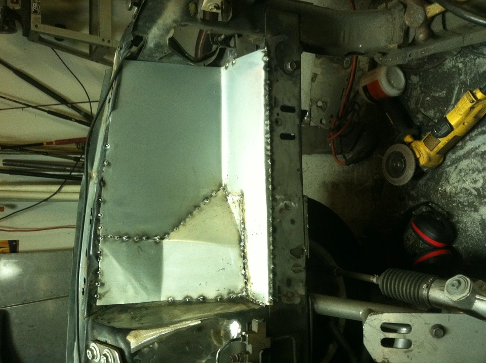

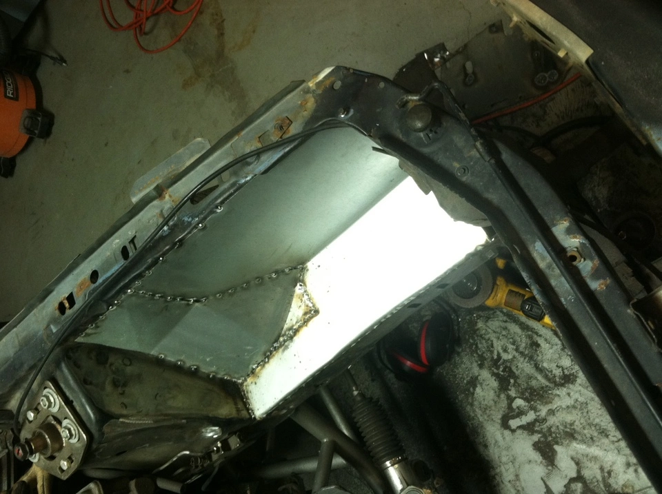

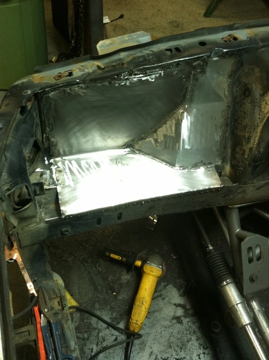

  10. First round of welding and grinding out of the way:
    And of course, I ground the sheet metal too thin in a couple places. I decided it was time to stop instead of getting frustrated and in a hurry. I think I have 3 hours total in the inner fenders, so I think it was worth doing this versus buying the panels. Will it look better? No. But I never claimed to be building a show car.

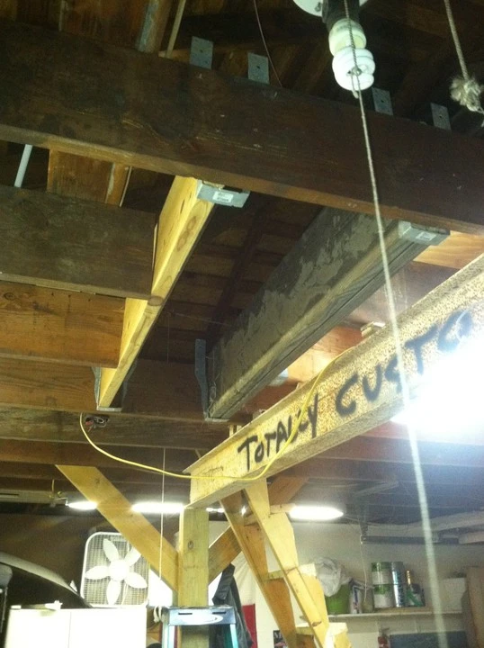

    A couple of years ago, I hung an I beam in the garage from the underside of the rafters. I hung a trolley and a hoist from that to lift and move motors and such. Unfortunately, it wasn't high enough to lift a motor over the core support of a mustang.
    Today, I swiped some leftover joist hangers and 2x12s from the job site and made an opening in the ceiling. Once I finish making the garage structurally sound again, Ill cut the beam down and move it to the top side of the rafters. With this setup, the hoist will be about 2' higher and since I cut out 2 rafters, Ill have 5' of lateral movement with the trolley. Now I can easily and safely put a motor in.
