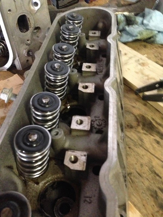

    I borrowed a pneumatic valve spring tool from a friend last night. Holy crap does it make life easy! I did and entire head in the time it took to use the el-cheap-o tool on one spring.

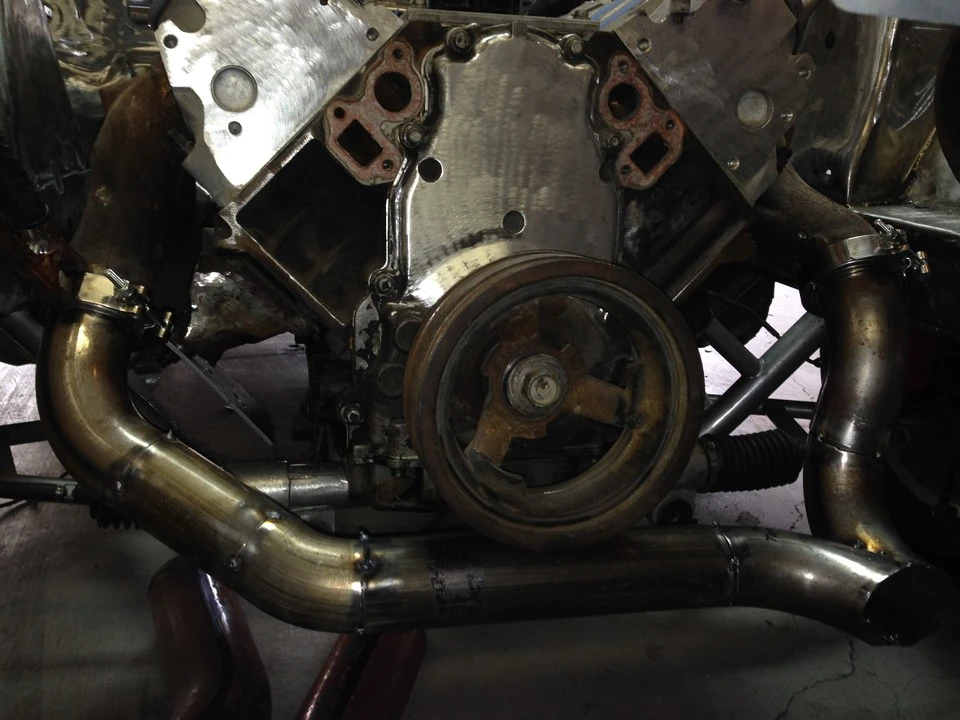

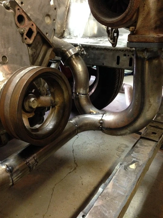

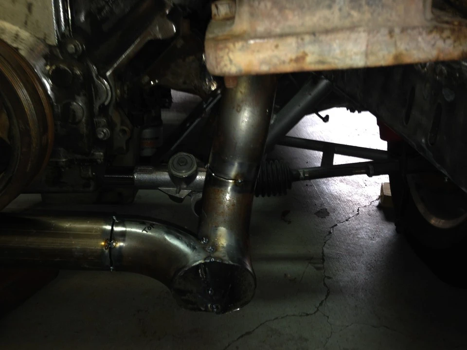

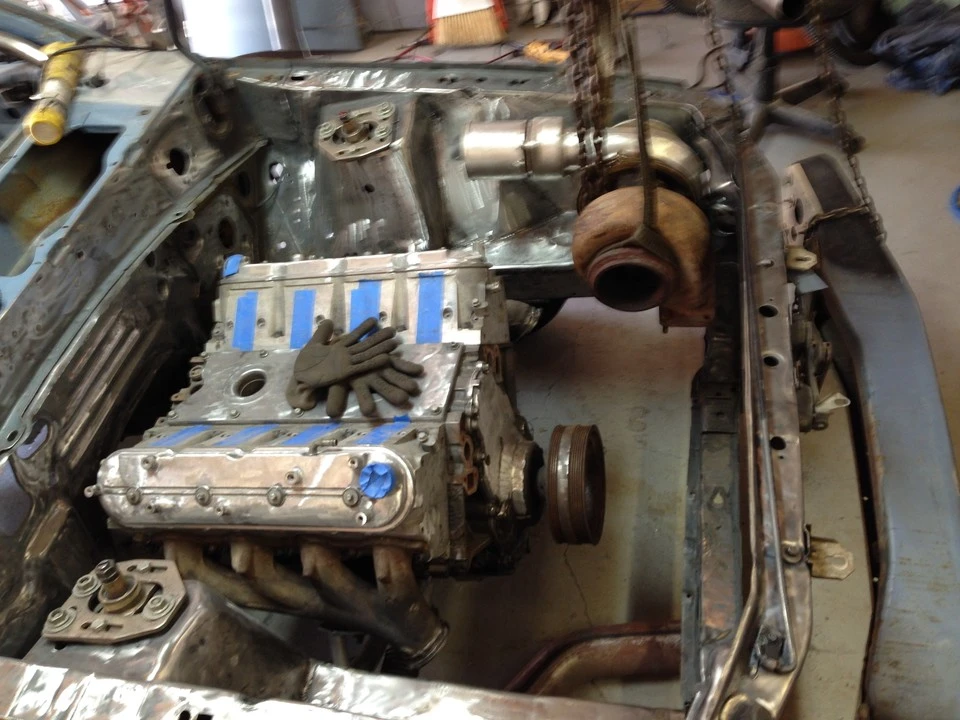

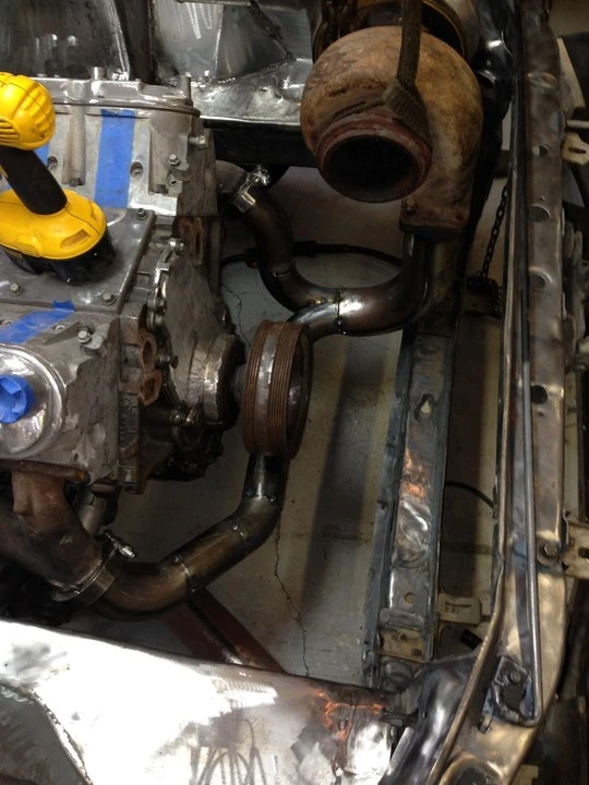

    Yesterday: Valve springs in, motor assembled and installed, hot side mocked up. BOOM.
    [​IMG]
    [​IMG]
    [​IMG]
    [​IMG]
    [​IMG]
    [​IMG]
    A5literMan and stangboy like this.

    Do you plan to mount the turbo off of the rad support or frame rail some how? I don't like the thought of all that weight hanging off the headers. Looks good by the way!
  13. hoopty5.0
    hoopty5.0 Mustang Master
    Joined:
    Dec 14, 2010
    Messages:
    2,203
    Likes Received:
    510
    Trophy Points:
    134
    Location:
    SW Houston
    Definitely making a support. Those things are waaaaay to heavy not to
  14. stangboy
    stangboy Founding Member
    Joined:
    Aug 31, 1999
    Messages:
    3,514
    Likes Received:
    90
    Trophy Points:
    69
    Location:
    New Orleans, LA
    :jaw:What size turbo will you be using? The one in the pic looks like a 101mm or something HUGE like that!! I know you're just using it for mock-up but the one you're actually gonna use must be the same size or close to it, right?
  15. 84Ttop
    84Ttop They make new pistons every day, so why worry? SN Certified Technician Mod Dude
    Joined:
    Jul 3, 2009
    Messages:
    3,184
    Likes Received:
    1,276
    Trophy Points:
    144
    Location:
    South Jersey
    I think something about this big should do....
    stangboy, hoopty5.0 and A5literMan like this.
  16. hoopty5.0
    Joined:
    Dec 14, 2010
    Messages:
    2,203
    Likes Received:
    510
    Trophy Points:
    134
    Location:
    SW Houston
    It'll be a Borg Warner S400 series, just haven't made my mind up on a 75 or 80mm yet. I need to call and talk to Mike's guy. The last salesman I talked to was just that - trying to sell me something I don't need. Either way, they are big units, and won't be much smaller than whats in the picture.
    With that said, the merge to turbo pipe will probably end up getting cut down to fit the turbo under the hood. We shall see!
