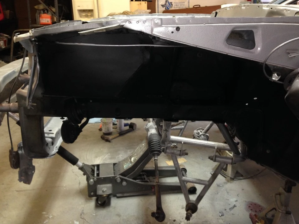

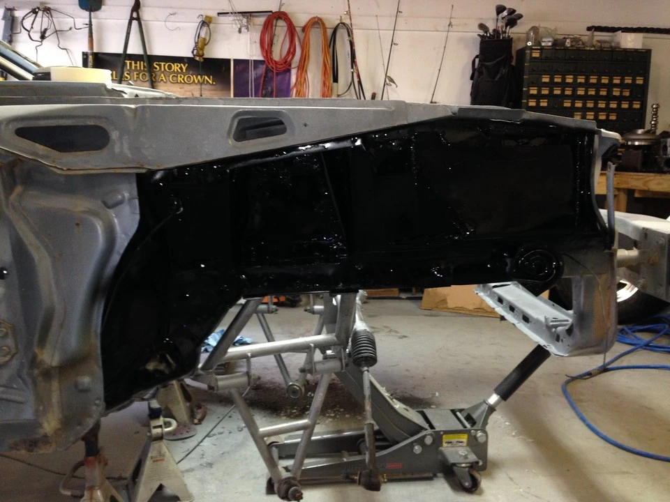

  1. Thanks for the bump, I actually did do some work. The engine bay was finally resprayed last night, and it looks terrible. I'll redo it at some point in the future with the Scott Rod panels.

  4. Seriously??!! What is the major malfunction? The fender aprons? Do yourself a favor, and Google pics of the guys that have riveted ScottRod panels on. Get a set, trim them to fit ,drill them for the rivets (use screws or Cleco's to hold in place so you can drill all the holes) paint them, cut out the offending stuff and rivet those bit ches on.

  6. Nah I've accepted it for what it is. Moving on with it and I'll redo it on a rainy day.

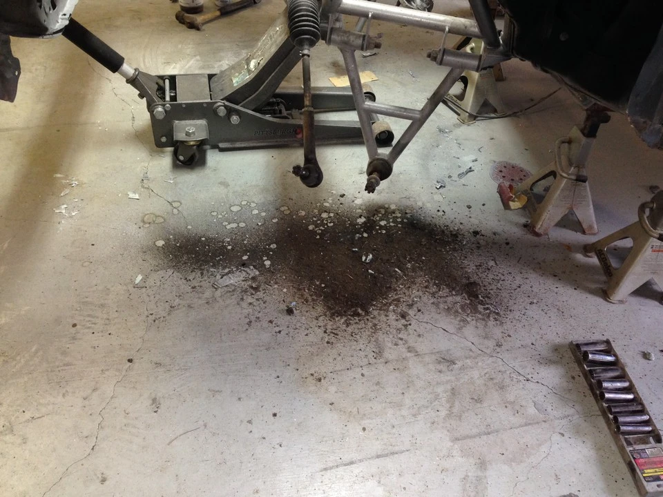

  7. Well I got the K member bolted in and I got to looking at the fender wells... They were disgusting. So I spent the evening cleaning them up. The driver's side was the worst, covered in years of oil and dirt. That took about an hour just to get it clean enough to paint! I didn't get as far as I'd hoped, but it's something.

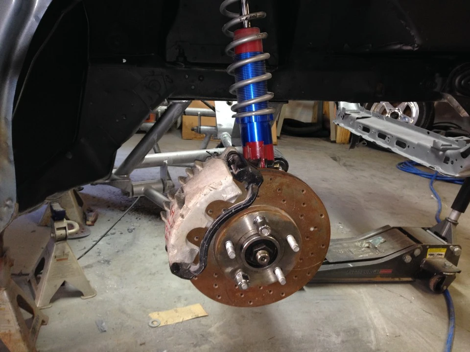

    - Reassembled the front end, ended up going to Tractor Supply for some bolts for the struts.

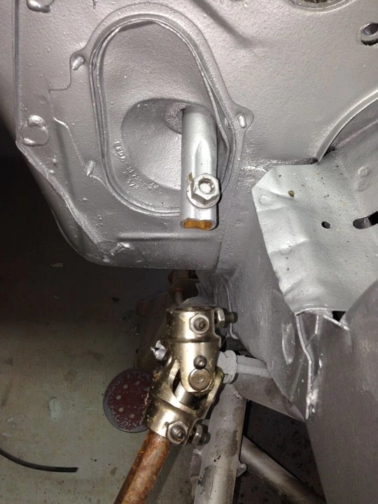

    - Found out I don't have the piece that connects the flaming river steering shaft to the column

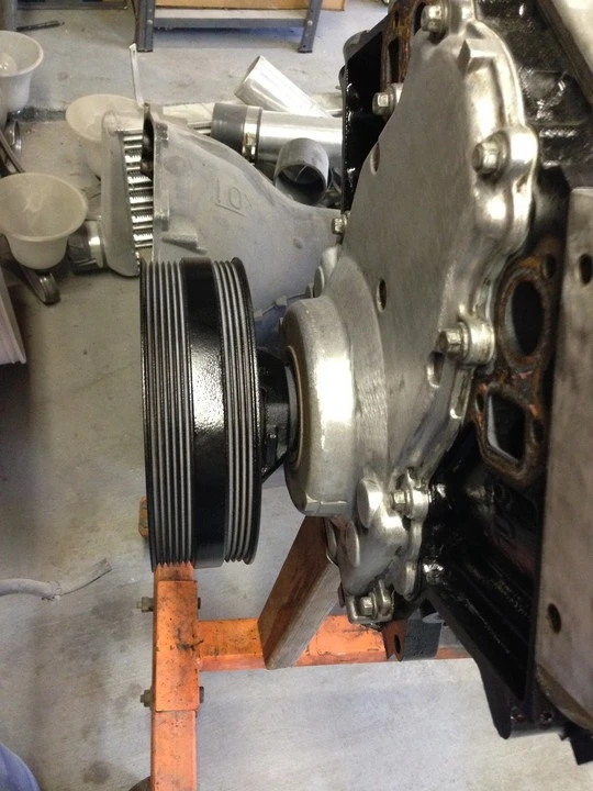

  9. - Fixed the balancer bolt issue and installed it last night

    - Found the missing piece of double d bar for $20 at Speedway Motors

    Also ordered the DD bar for the steering shaft from Speedway for $21. Much better than $98.
