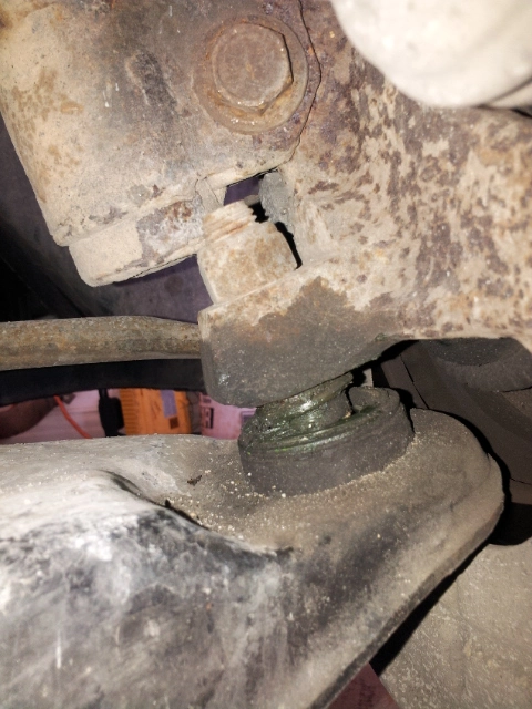

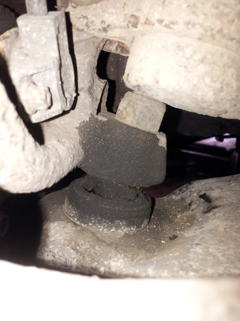

  16. pulled the wheel off and noticed this on the passenger side control arm. Could this be the cause of my sound?
    front side
    back side
