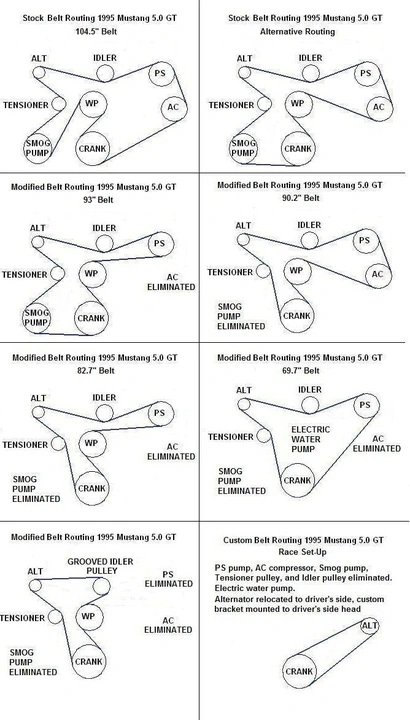

  8. OK then ..looks like Im going to get block offs then...Any Idea the size belt I need?
  9. hmm type 94 gt 5.0 belt routing into google and there will be some pics somewhere wish i would have saved the place i found mine at.
  10. Thanks.. found it
  11. Here ya go. As the original author, here's the one from my site:
  12. Sweet man thanks:nice:
  13. Yeah Thanks!!!
