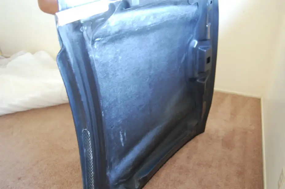

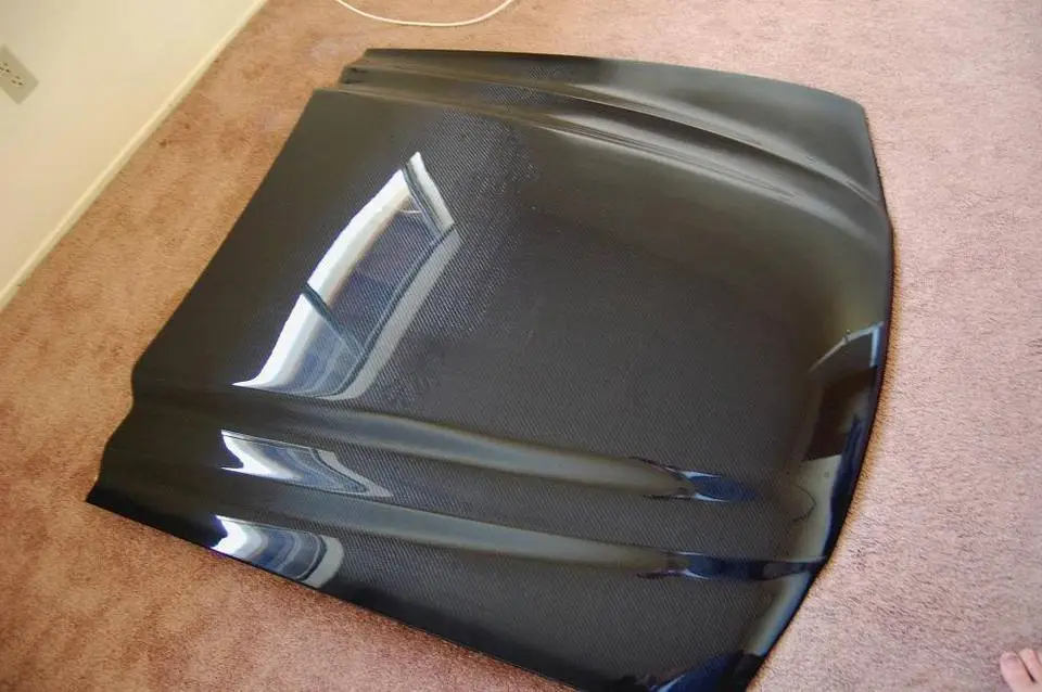

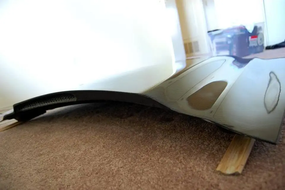

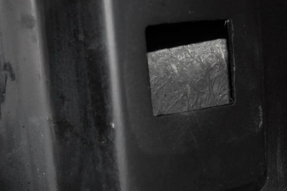

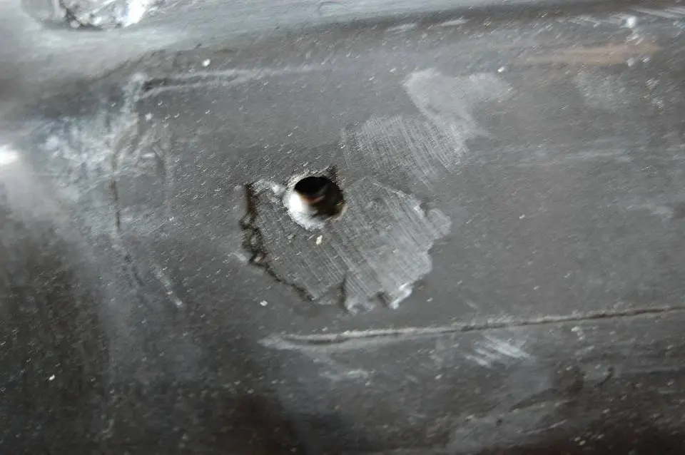

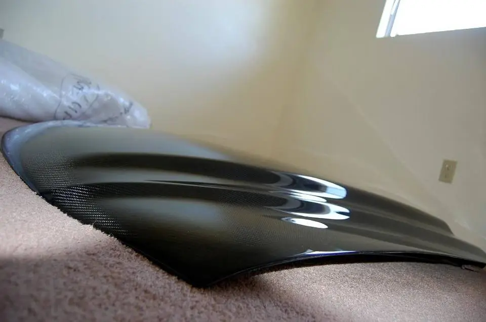

    Picked up my hood today. Keeping it unpainted for now cuz im lazy/cheap and dont really care, so rice it will stay. The latch and hinge areas aren't reinforced with steel, can you use the stock latch in there? Can you run without?

    I would do pins, because anything not named Kaenan or Cervini or Ford Racing will probably shoot up when you least expect it to.
    I have seen some places do inverted pins that dont force you to drill through the top of your hood, rather use the hood to attach it to the core support.
    With a nice CF hood like that, some research may save you from making holes that you may not like or need.

    nice cf hood though. where did u pick that up from

    Nice looking hood!!!To nice to paint LOL!:nice:
    I agree about the latching part,since there is no metal reiforcement there,i wouldn't even leave the driveway.
    My steeda hood came with a nice thick,large metal plate that is between the top portion,and bottom portion of the hood,and is riveted to the bottom portion.
    Definitely do some web search to see your options.;)

    get some aerocatch hood pins :nice:
