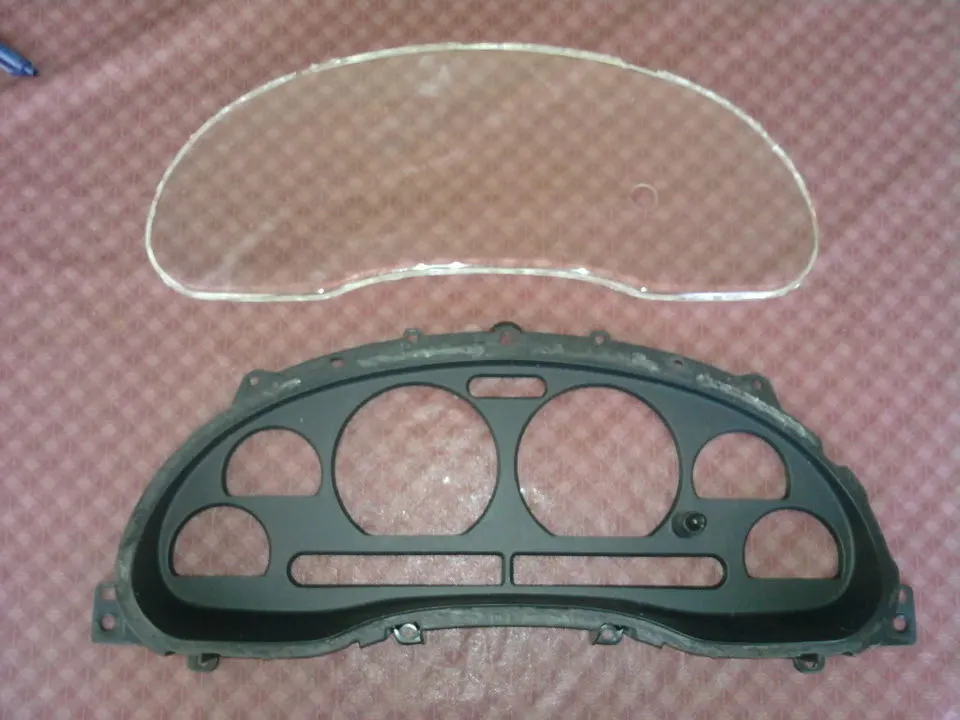

  2. Yes and no to your question. Some companies say that the trim rings can be installed without cutting. You can do this if you have a drimmel and a steady hand, just be sure to use silicone to put it back together. It won't be as strong as factory though.

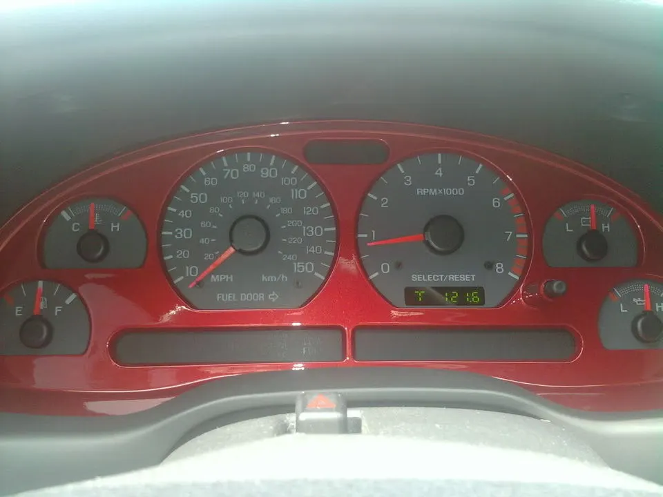

    This is why I did this:
  3. That looks SWEEEEET!
    Did you have to take the plastic apart like shown to make that happen? I assume yes.
  4. Yea I had to take a drimmel to it, I might try a heatgun to see if it will pull apart but I doubt it will. It's not as bad as it sounds actually, just take your time and cut as close to the seam as possible. I choose to do this because it's different than what else is out there and I thought it would look good (which it does). Might want to wear a mask actually as gay as it sounds, the fumes from cutting the plastic were pretty good.
  5. Wow, that cluster does look good. Nice job.
