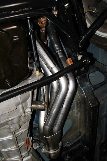

  3. BBK is designing some 1 3/4" primary long tube headers for the swap. They will be building these after SEMA week, hope to have a set here before the end of November!
    I saw your original post about the stock K-member. We took a stock K-member and had to modify the heck out of it to make it fit. On the passenger side a lot of material had to be removed. The structural integrity was compromised in our opinion. You might be able to modify it and then put some plate steel back in to add strength, not sure. You can see the attached image for where we had to modify.
