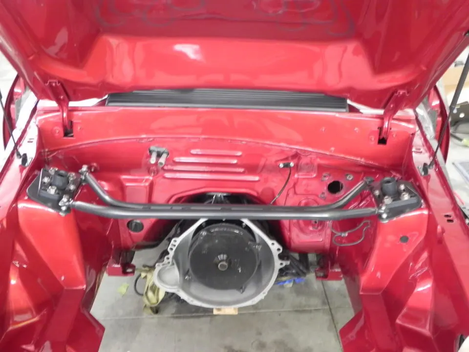

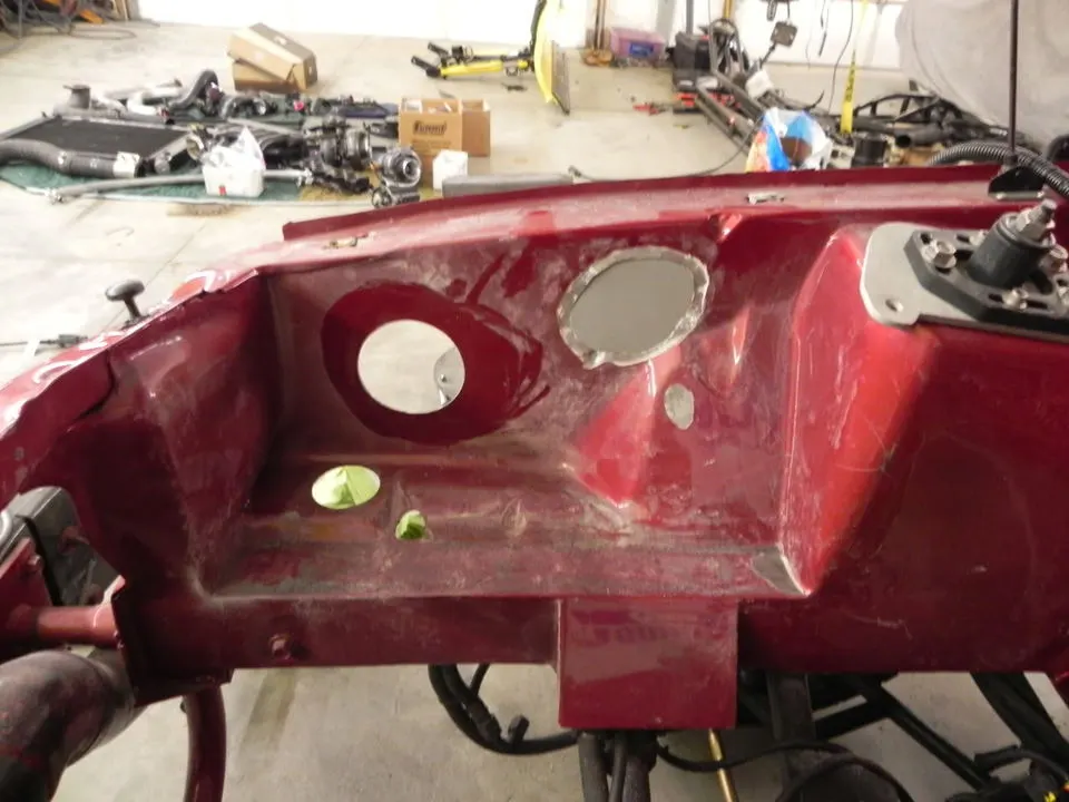

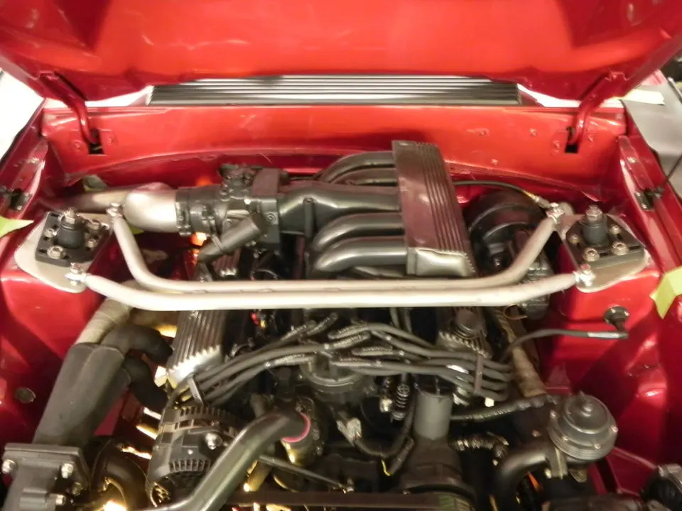

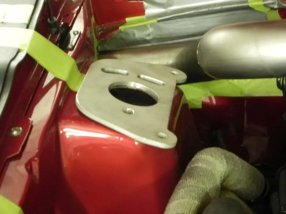

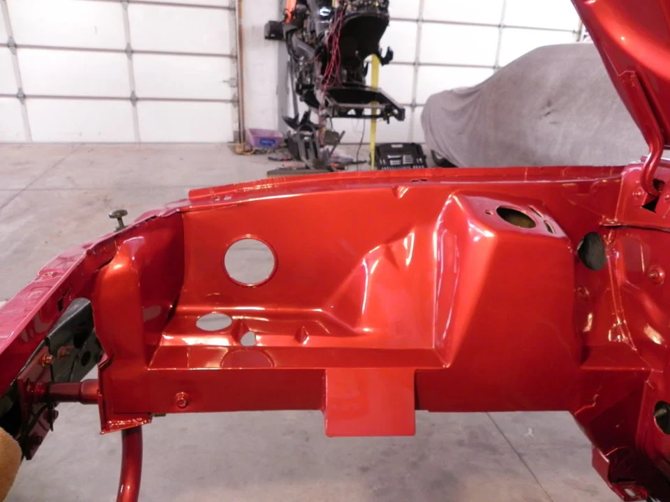

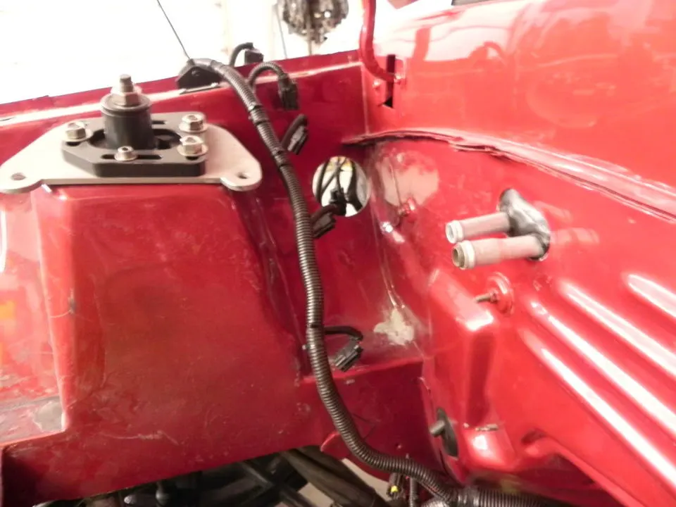

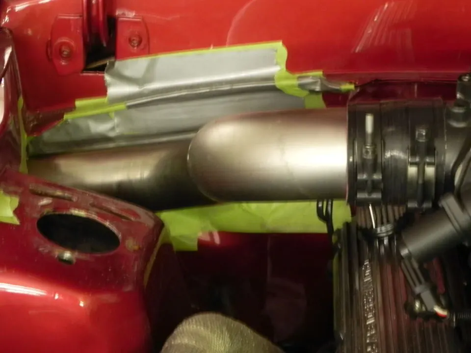

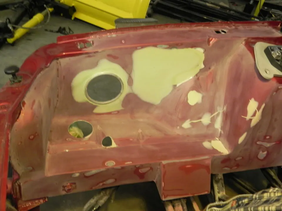

    I have been hating the look of my intake pipe and also i have really wanted to get an engine bay brace in this car, cause I think that with this combo I'm probably gonna need it. So I finally have got a plan. Here is the new intake pipe
    Of course this means filling the old intake hole, the round hole is where the turbo tubing goes through.

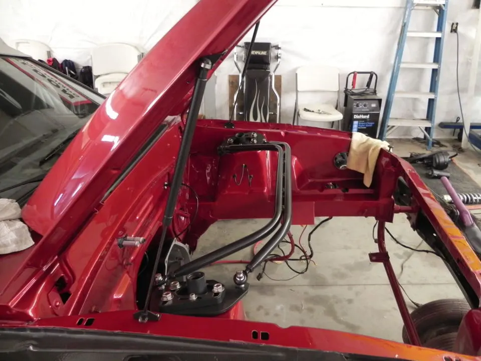

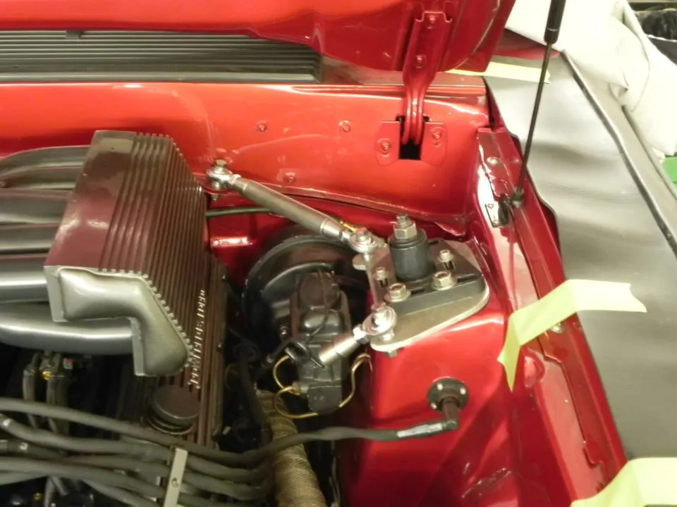

    I really did not want to mount an engine bay brace directly on the shock tower of a smoothed engine bay ever again, so here is my solution
    Of course now I'm looking at redoing most of the paint, but I think it's really gonna be worth it. All the new peices will get powdercoated as well.

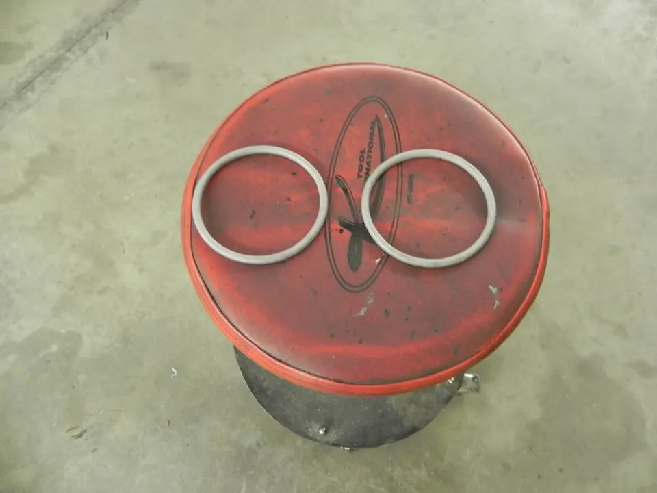

    Decided to finish off the holes where the turbo tubing goes through, so i fabbed up some rings and got em welded in. Just a little bodywork and I'll be painting again.:shrug:

    wow you're kidding, that brace is crazy.

    and I didn't think this car could have gotten any better after drooling on it at the American Muscle show, wow just wow

    Was going for a retro look to fit the 4eye theme, can't wait to see it after I powdercoat it.
    Thanks, man.
    Thanks.

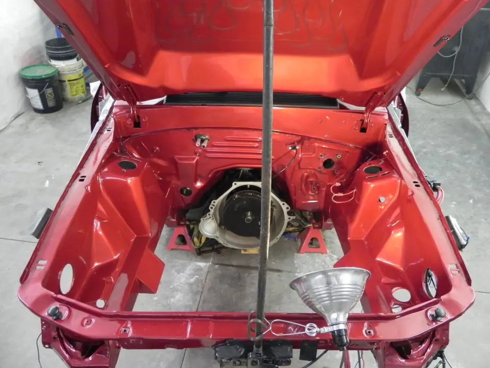

    Good feeling to have the bodywork done again and be back in paint

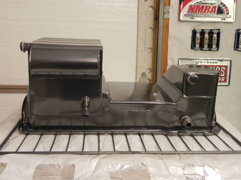

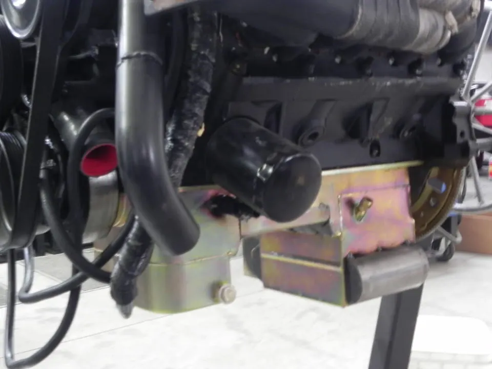

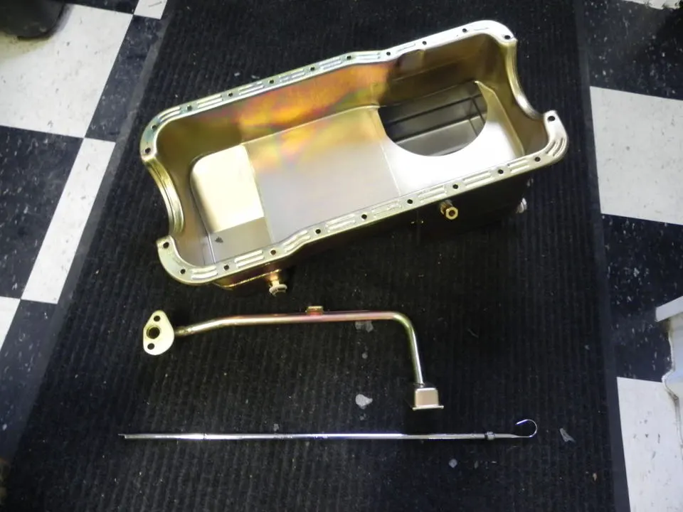

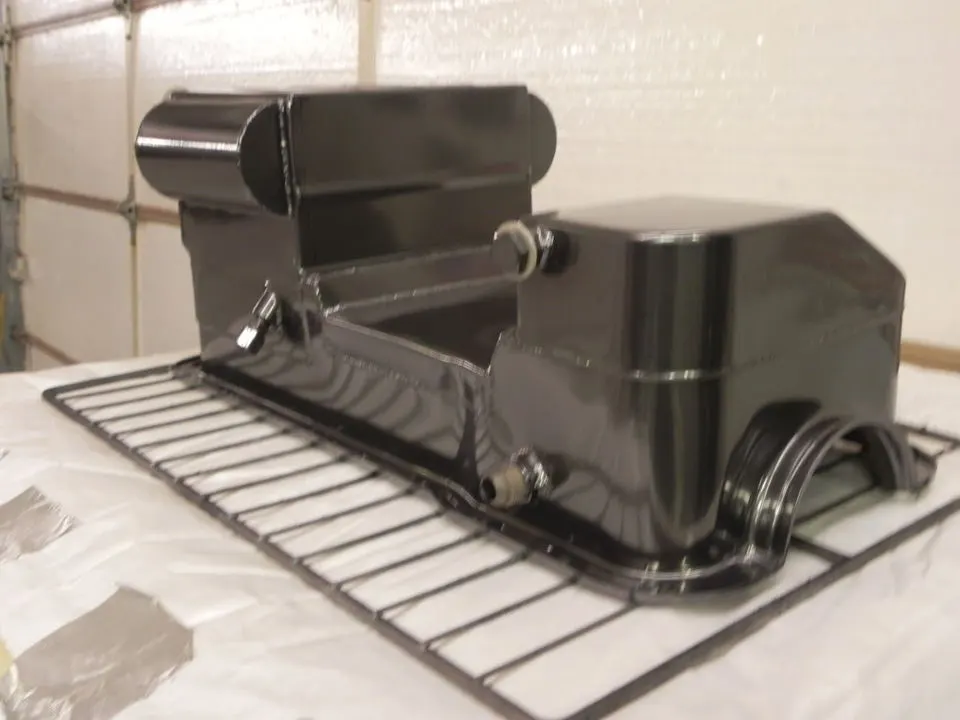

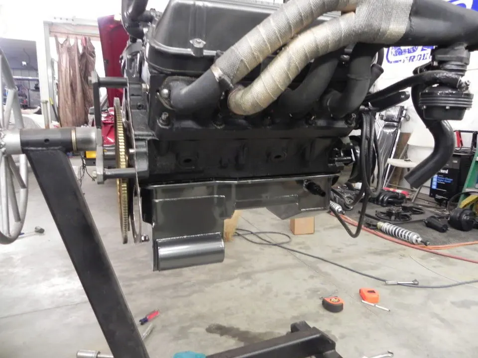

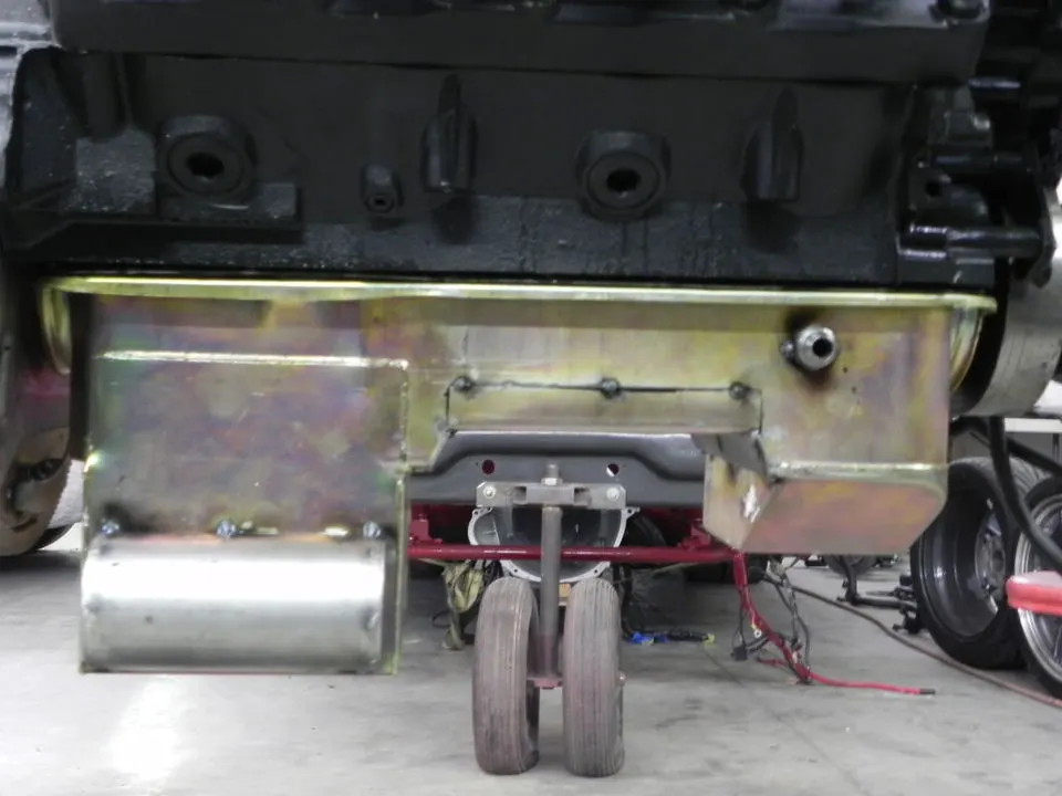

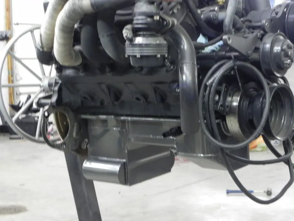

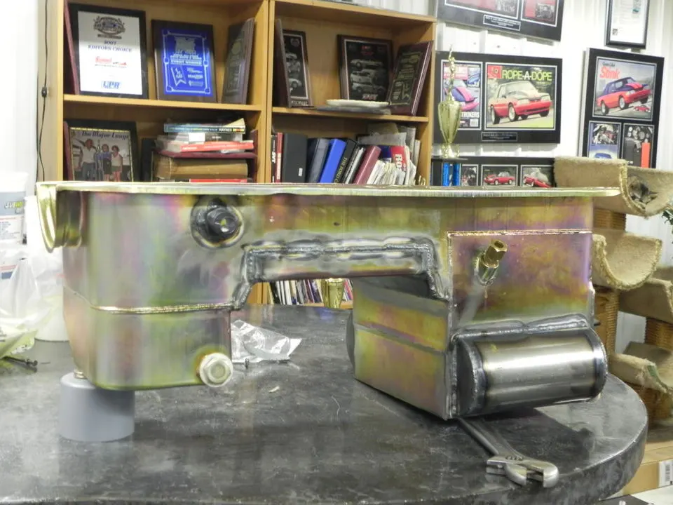

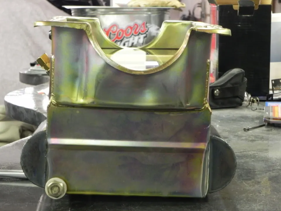

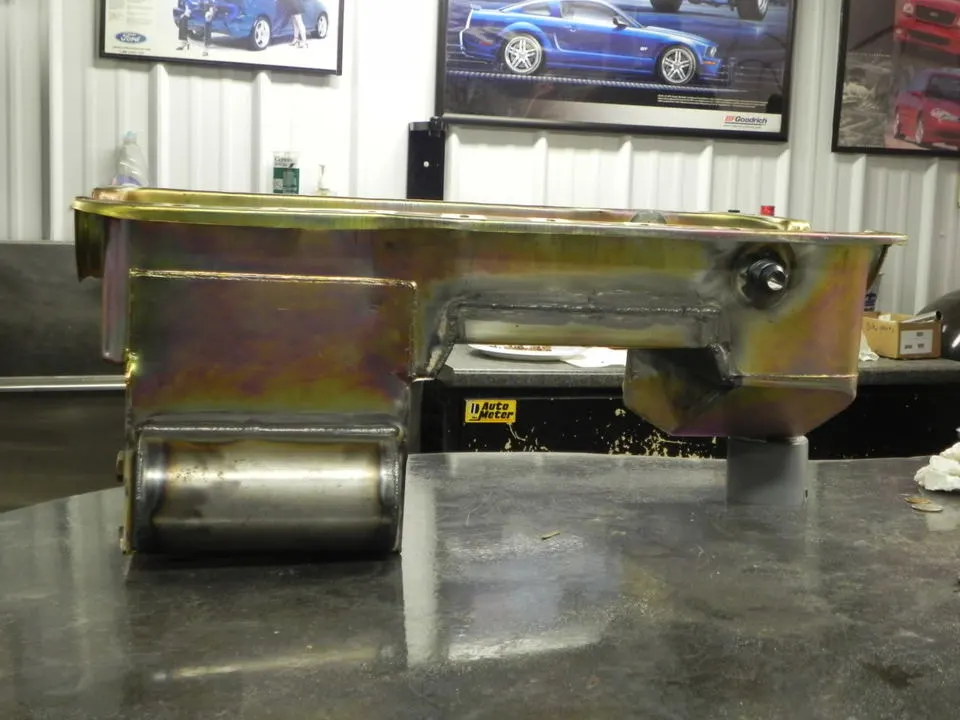

    Picked up a CFR oil pan , really wanted the larger capacity with the setup we're running, DSS also recommends it. The bad part is it doesn't fit. We had to lower the engine position in the car because of those HUGE Ford racing Z heads, so the new pan hits on the steering rack right in the center of the pan. After a few days of massaging, we got er, added kickouts to make up from the volume loss when it got shortened.
    BEFORE
    AFTER

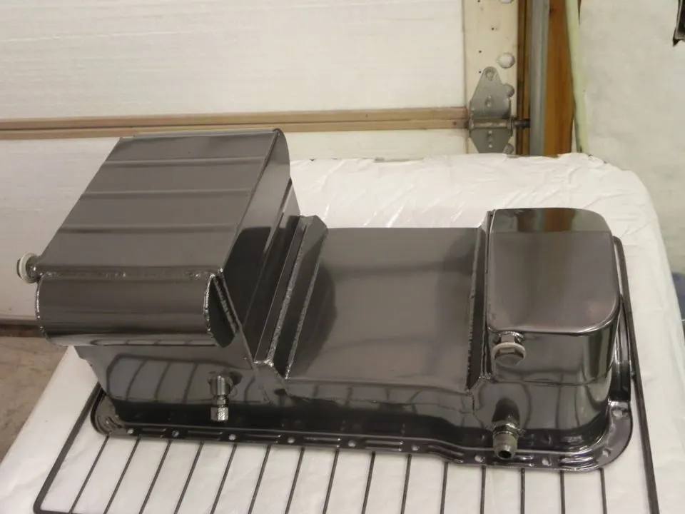

    powdercoated in black chrome to match the underside of the car

    Your brain is apparently missing the "half ass" portion that the rest of us have, because you seem incapable of doing anything half ass.
    BTW, were those the as-cast or the CNC Z heads?

    Thanks, I guess. :rlaugh: They are just the as-cast heads

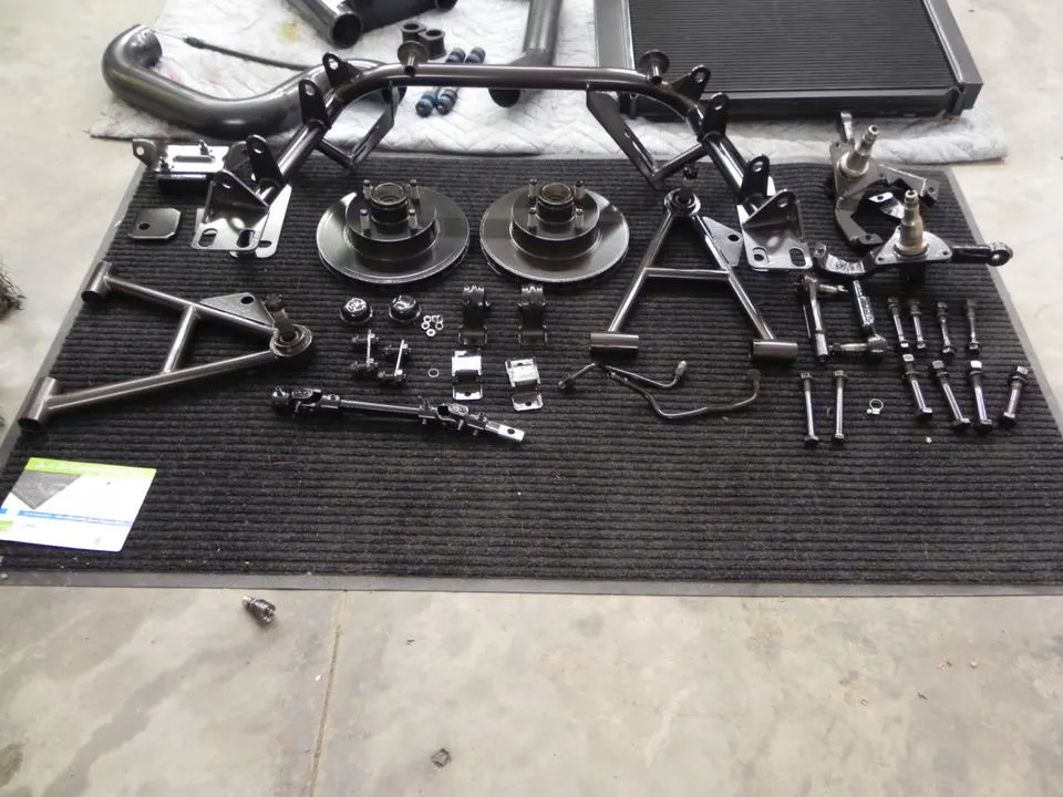

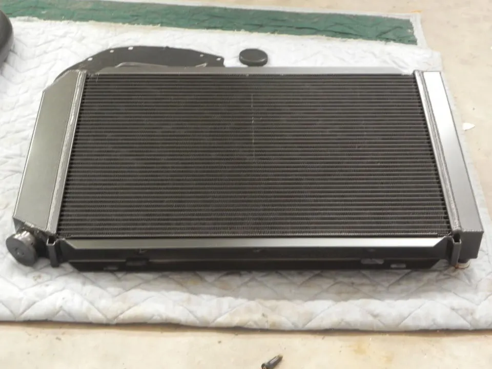

    Powdercoating crazy, blasted a bunch of stuff in between doing bike jobs.
    Did the radiator
    got the pan on
    Put the engine bay brace in, just for fun

    Did you make that engine stand?
  17. Trbofox
    Trbofox Member
    Joined:
    Oct 26, 2004
    Messages:
    217
    Likes Received:
    Trophy Points:
    Location:
    Erie,Pa.
    Yes, when neccessity calls I fab it.
    Went crazy powdercoating, I have alot larger oven capacity now.

    did you powder coat the rotors???????
  20. BlownRed5oh
    BlownRed5oh Member
    Joined:
    Jan 2, 2011
    Messages:
    47
    Likes Received:
    Trophy Points:
    Location:
    wisconsin
    it looks like just the centers were done!
