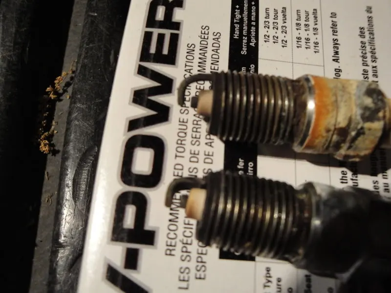

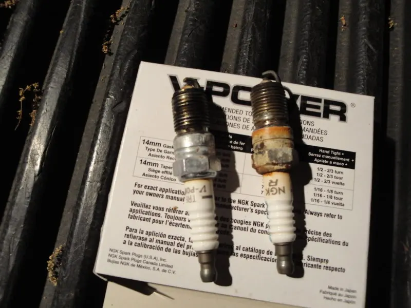

tag4car Member Nov 21, 2005 0 0 16 Birmingham AL Apr 17, 2010 #1 Apr 17, 2010 #1 So i thought it would be fun to change the plugs on the cobra, No issues changing but the back passenger side plug looked like this

tag4car Member Nov 21, 2005 0 0 16 Birmingham AL Apr 18, 2010 #3 Apr 18, 2010 #3 new plugs in all 8 and that plug well got a cleaning, seems to idle smoother
BurningRubber 10 Year Member Dec 6, 2004 1,865 24 58 Apr 18, 2010 #4 Apr 18, 2010 #4 The part of the plug that matters is fine. Looks like you got some moisture in the well though. Did you wash the engine or anything since you had it? You may want to check that coil as well and see if the spring inside is corroded.

tag4car Member Nov 21, 2005 0 0 16 Birmingham AL Apr 18, 2010 #5 Apr 18, 2010 #5 i cleaned the boot also, I have washed it in the past but this has me thinking about future cleanings..
