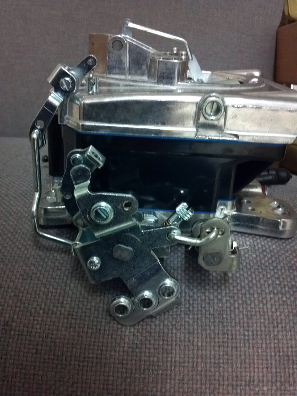

  1. I ordered the new Street Demon carb from Summit to try on my stock 289, and eventually on a mildly-built 302/AOD combo. However, while reading through the owners manual, I found the disclaimer "will not work with AOD transmissions" in bold print under the Ford kickdown section. Is this a standard disclaimer for new carbs, or can you guys see any reason that I can't fab up a bracket for a TV cable on this linkage (see pic) or any other AOD-related issues? I need to send it back if it's going to be a problem down the road.

  4. Took a little while to get someone on the phone, but the guy was helpful and seemed knowledgeable. The Carb is the same as any other; must be modified to work with a TV cable. Otherwise, no issues.

  6. Backfire did u ever set up the demon carb with aod i was just on the demon web page and it has a hole on the linkage for the gm700r it should be the same as the ford aod

  8. Holley (which Demon and QFT seem to have ripped off the design, what patents?) has sold an arm adaptor or extension for Ford. If Demon does not offer one, I would start with the Holley bracket.
