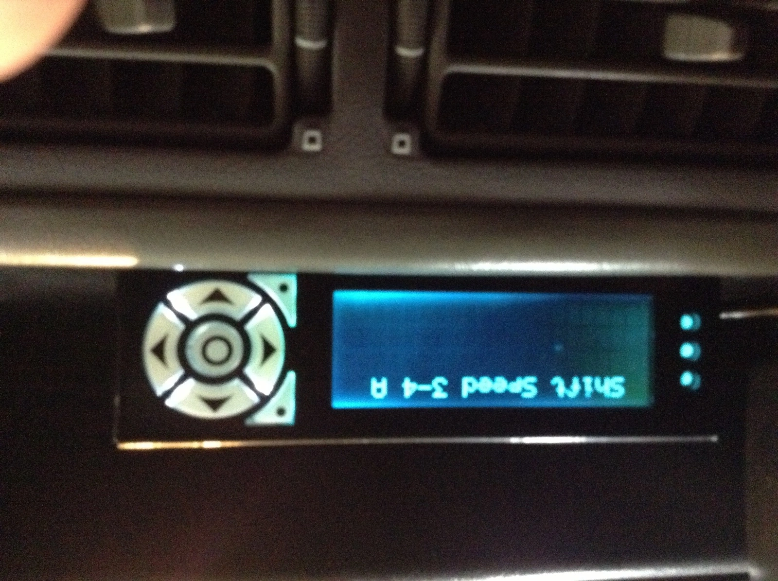

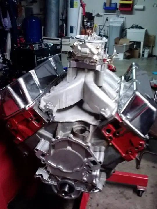

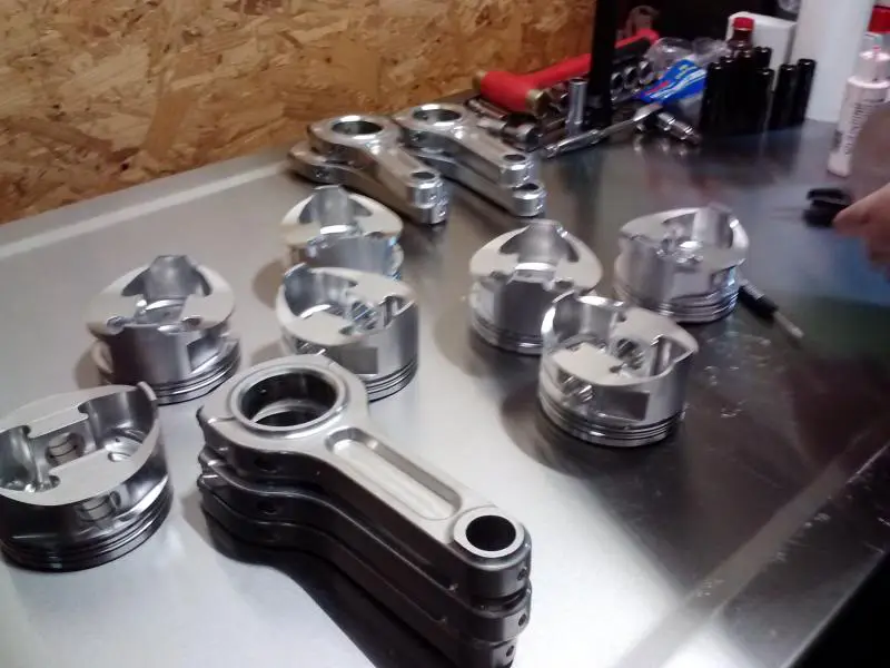

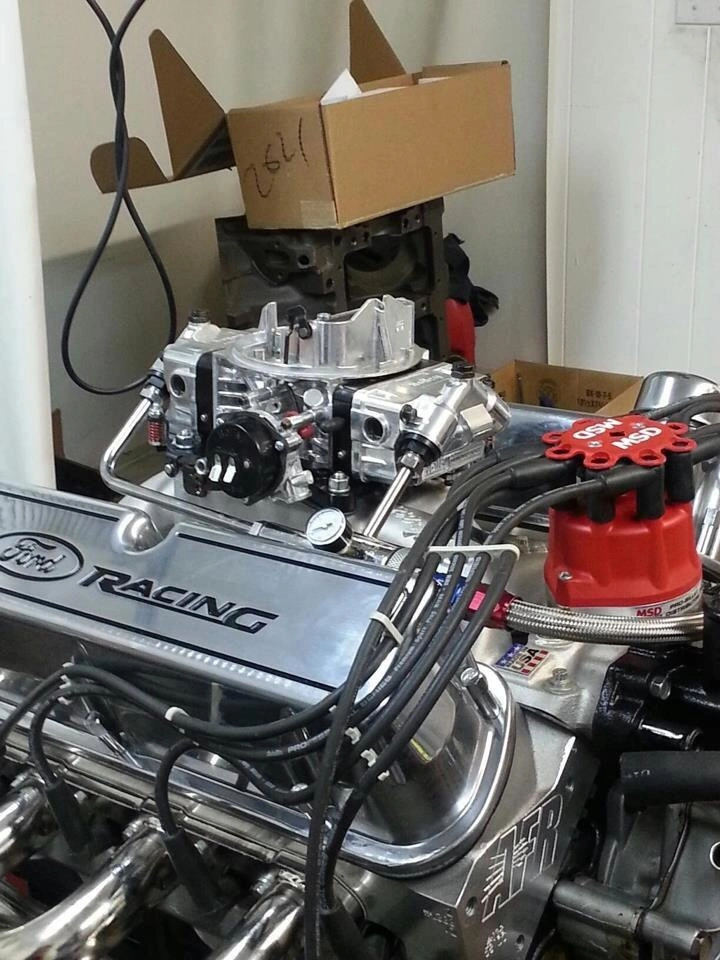

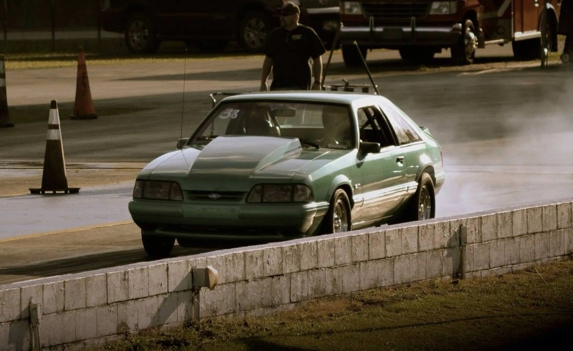

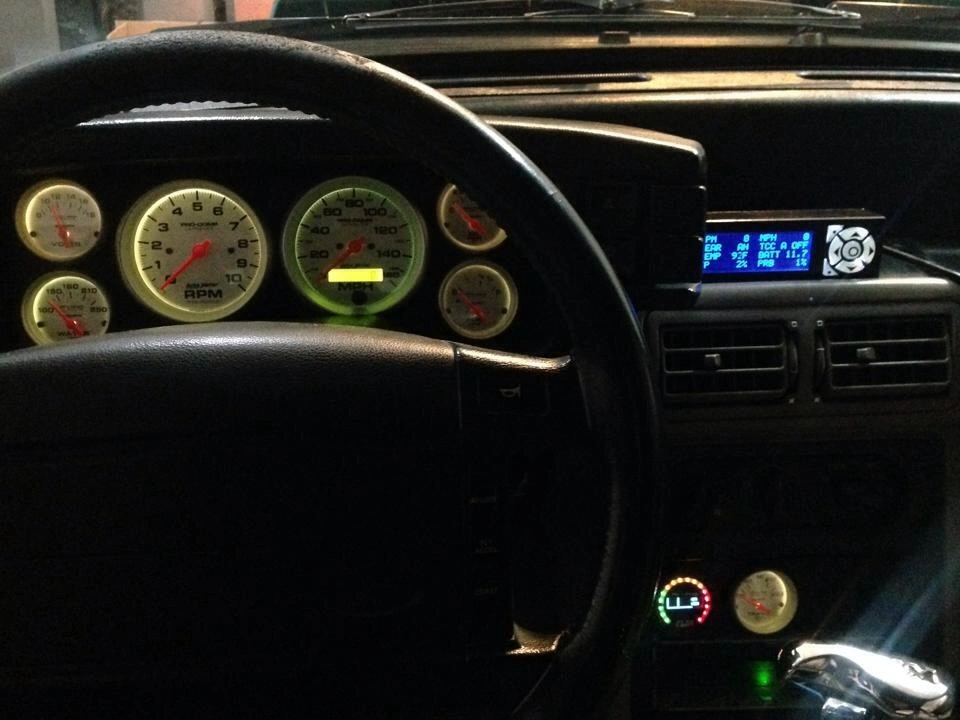

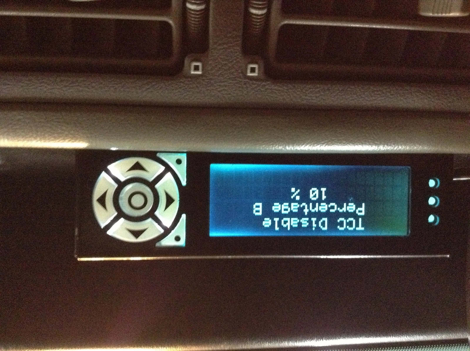

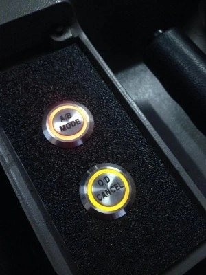

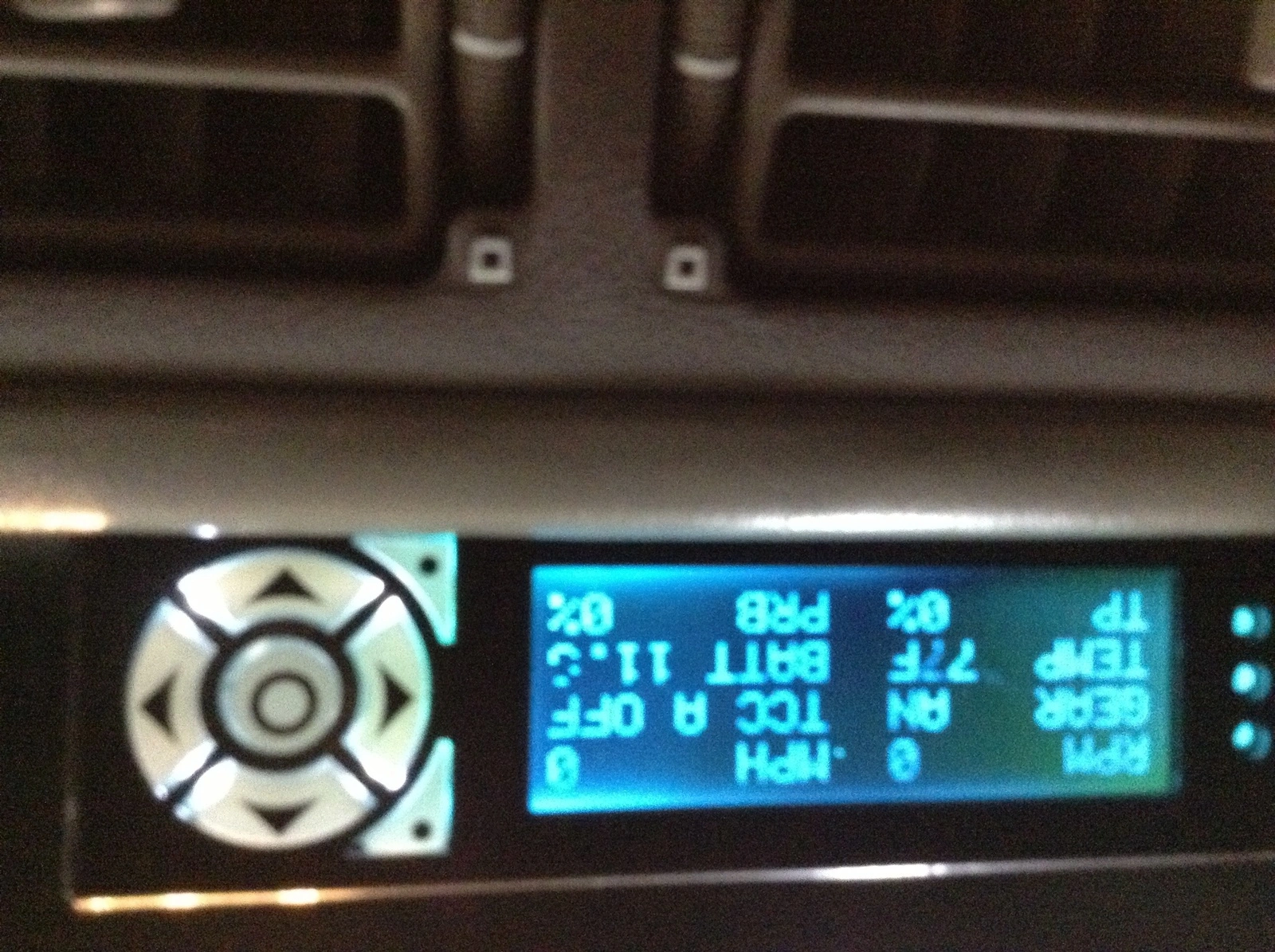

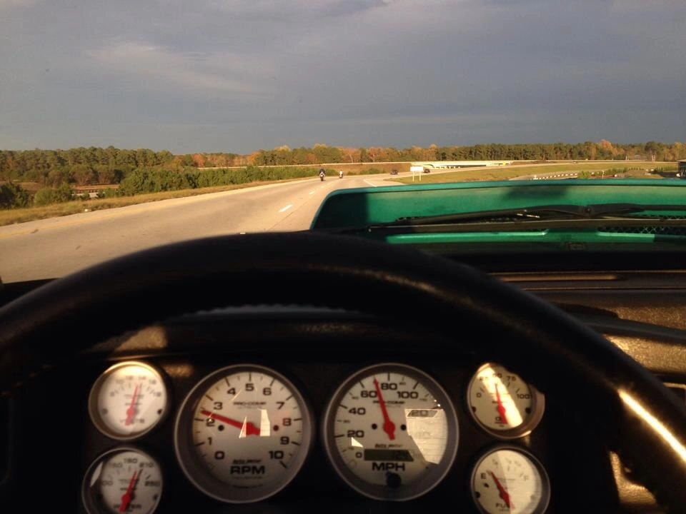

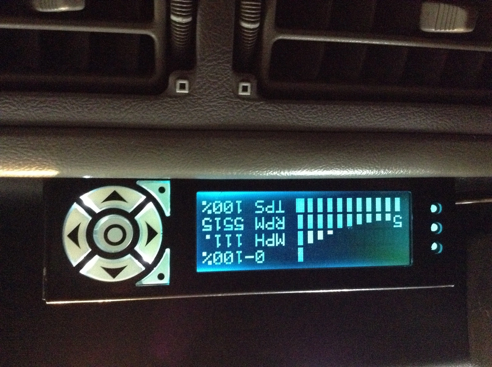

  8. image.jpg image.jpg image.jpg image.jpg image.jpg image.jpg image.jpg image.jpg image.jpg image.jpg image.jpg image.jpg image.jpg image.jpg image.jpg image.jpg image.jpg image.jpg image.jpg Just to add on to what I was originally trying to say. Everyone has a different set up that they like. I used to want the tallest gear possible and a radical cam that made power way up in to the 6600-6800's. Over time I learned for what I do with my cars and what I enjoy that set up is awesome to squeeze every last mph in the 1/4 mile and get that extra few tenths of a second out of your ET. But my god did that suck driving 17 miles each way to the track. I take pride in driving my car to the track and beating the pants off some Chevys and Mopars that are trailered in formless then 15 miles away. Over time my "likes" changed for my setup. In my personal opinion I don't care for 4.10's or higher with a high stall like 3500+ on the street. I think for a driver car 3.73's and 2750 stall and maybe just maybe 3000 rpm are enough. Let me explain why. I live Just out side the city limits and have to drive in 60mph zone (everyone does 10 over so cruising at 70) for 12 miles just to get in to the 45 and 35 mph areas. I have a 4r70w (so I have a nice overdrive) with a comp-u-shift 2 computer for the trans with a 2750 stall and 3.73 in the rear on a 26" tall tire. So cruising at 70mph it hangs around 2200-2400. If I'm down around 55-60 it sits right at 2000 rpms. Just nice so it's not pushing crazy rpms for a long period on the highway. Some people say "well who cares what rpms it spins on the highway. A well built motor can handle cruising at 3500 RPM all day long". Yea im sure it could but why put your motor through that and shorten its life. I have a lot of money in my motor and would prefer NOT to pay any more on rebuilding it any time soon. Also I do a lot of driving in and around town in my car and with dual electric fans with a good aluminum radiator with the trans cooler built in and a Long true cool transmission cooler run in series it can still get a little warm if I get stuck in a 25-35 for a long period of stop and go and I don't use my trans computer to make the converter lock up vs it slipping all that time. I have zero trans cooling issues,at the track but in NC on a hot summer day 95+ degrees getting caught in slow moving traffic it has shown she doesn't like it. I just couldn't imagine a 4000 rpm stall 4.10s and a c4 with no over drive and having to cruise on the hwy at 65 mph, that works out to a 3750 rpm cruise!!! . Hey some people may like it but I like knowing for certain I can at anytime go do a 500 mile road trip with no worries. Done it before to FL2k. If anyone had a fox that has some serious HP and they truly like to drive on the road and put down some miles beside just to the corner store and back you need to check out a transmission stand alone computer. I use the compushift 2. It had a button for o/d off so no worries of burning that little guy out, you can have multiple profiles or modes. Mode A my car shifts nice and smooth, no kicking or cherp of the tires when your just trying to cruse like if you put a hefty shift kit in a c4. On each profile you can adjust your shift points and pressure for each shift along with when the convert locks up at cruising and when you get back in to it when you want the lock up to dis engage. Also you can make it lock up on the top end of the track to gain a few mph. So basically I set it up like this. Shift at 100%throttle at 6255 rpms or you can do it by mph, and shift at 100% trans pressure. Then you work your way down 95% throttle shift a X rpms, and you can leave the pressure at 100% or dial it back. It helped a lot at the local track when the prep isn't that good it will break loose on the 1-2 shift to the point it wants to slide out(sideways and crash) so I dialed the pressure back to 93% and it's a softer shift, it slips the trans for a fractions of a sec (less then .07 sec) and it just hooks and goes. There are so many other things you can dial in and the list goes on for ever. Greatly prolonged the life of my trans and shifts smooth and easy for cruising but is a gear banging beast in mode b .heres dome pics of my motor and then of the compushift controller in the car
