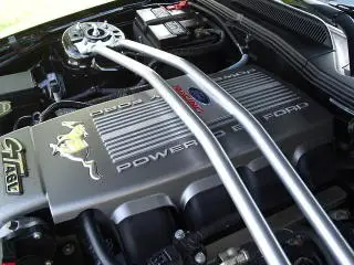

Are there any Strut Tower Braces out there that clear the plenum cover that comes with the GT Appearance pkg? I really like the way the planum cover looks and would like to keep it installed if at all possible.
The Bullitt STB will clear it by about 1/4-1/2 inch, but you'll need the updated hood blanket for the 08's. From what I've read, it will rub the 05-07 hood blankets.
the OEM brace is ford part# 8R3Z 16A200-A and retails for $174.55 which is the one that I have, the FRPP V6 brace is part# M 20201-F and retails for $195.00 which is the same brace as the Bullitt brace.
