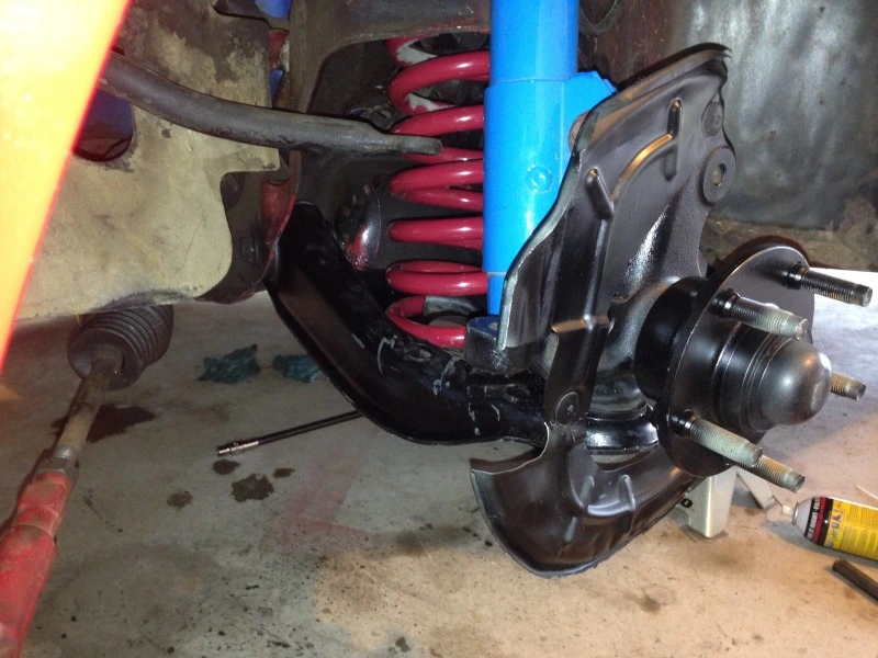

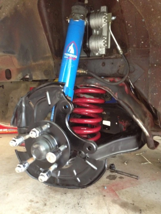

    Everything behind the wheel... as much detail as possible unless you'd just like us to use the SWAG method?
    For example, I just replaced pretty much everything on the front end of my fox, here's what it looked like when I Did it.
