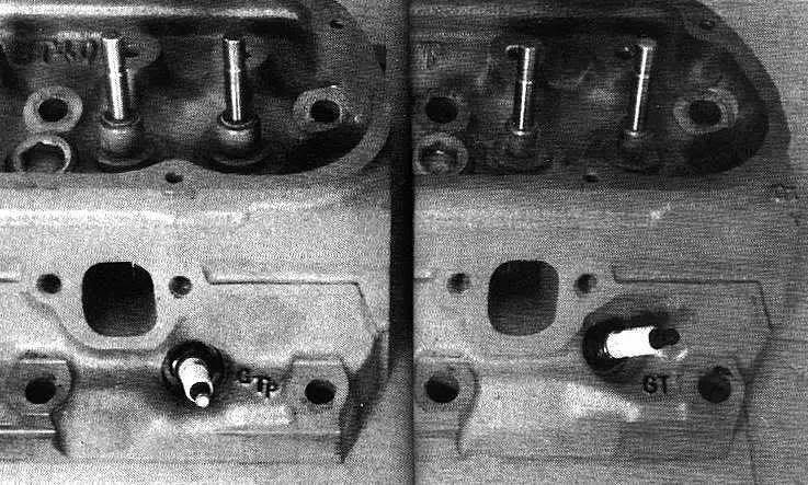

    GT40P heads have a different angle than GT40/Cobra/Standard 5.0 heads.
    images?q=tbn:ANd9GcS_d5ZkX-3BzkhLP1r3Zu3VRdKCQ2_0t80Idb1Ao2lB-1LDZGwi4w gt40andPheadsplugs.jpg

    Beautiful pictures! So helpful -thank you. The spark plug angle on the heads looks a lot more swept like the "GT" picture, but I will return once again to the car in order to check for a casting.
    Side note: Even after clearing the ecm (battery unhooked 30min) I'm still popping a code 564 (fan control circuit failure) even though the fan demonstrates 2 speeds. I wonder if this somehow plays into the mix.
    Question: should I look toward the front or rear of the head in order to observe the cast markings?

    Ok, On the passenger side head (front) it says "GT". On the driver side (front) it says "22".

    It sounds like you have GT 40 or Cobra heads. NOT GT40"P". That explains the spark plugs. The heads are the same L or R. The GT casting is in the rear on the other head. I have no idea on the code. Maybe google it.

    I went with your prior instructions/information and bought plugs to fit GT40 iron heads (i.e. 764's). I have not tried to install them yet because I was busy addressing a 411 & 412 code by cleaning out the IAC, fixing its 2 exposed wires, and making sure it was properly secured to the TB -which it was not =vacuum leak.

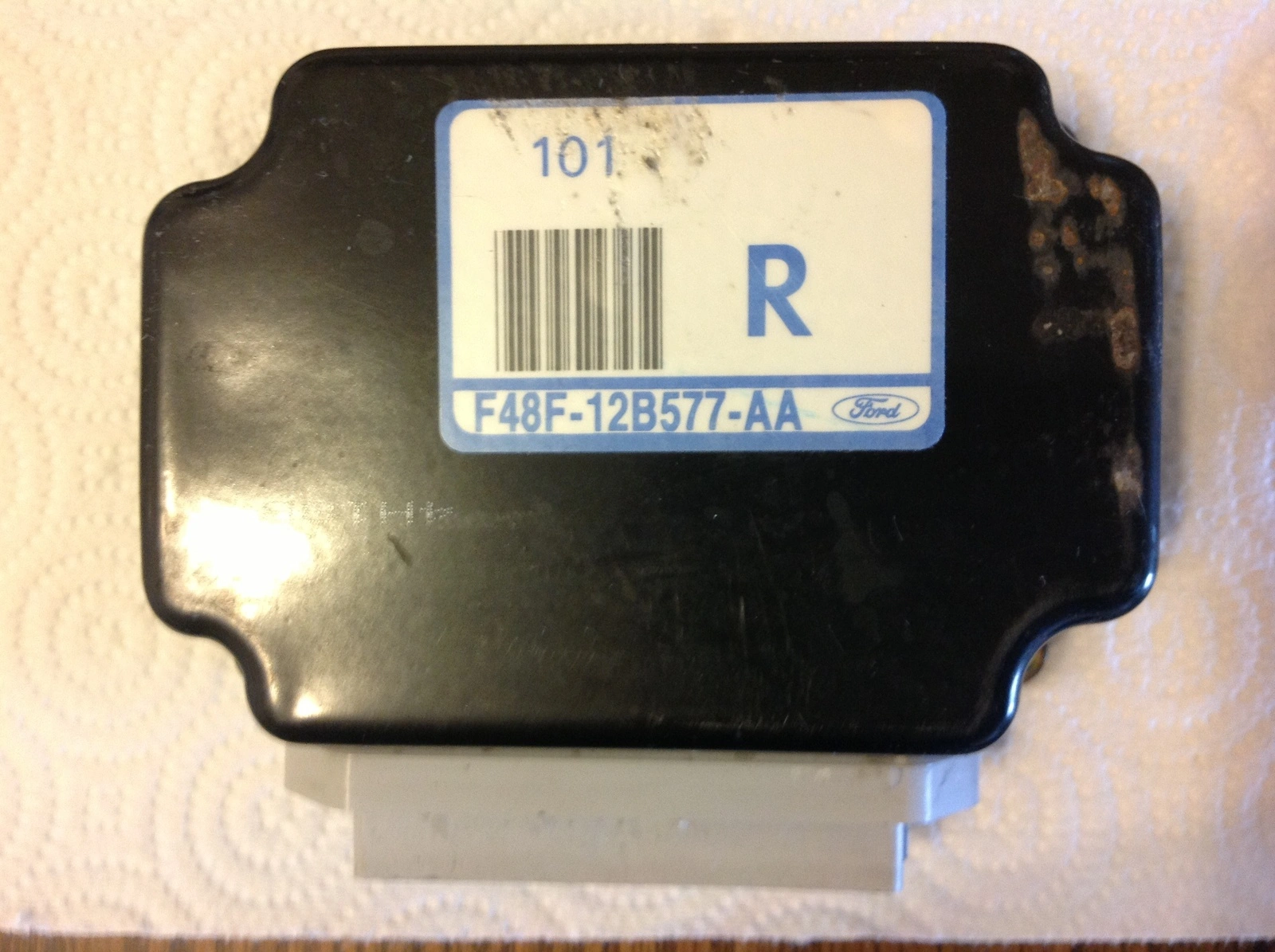

    I plan on pulling the CCRM today in order to get a part # and visual. I hear/read that when replacing the unit one needs to get the exact same one (e.g. part #, color of box, same large single letter code "R" or "S"). I'm anticipating your research results!

    Behold, the dreaded CCRM hath been pulled from mine car.

    I'm assuming that its at least "a" problem due to the code that I pulled. It lead me straight to the CCRM. I purchased another one with exact part number and "R" code as my current (it all must match up to function properly). A friend of mine works on electronics for a living. When he gets some time he will completely overhaul my old one. Then I'll either have a spare or one to sell on ebay.

    Maybe you were fortunate? I did a bit of research that indicated that the part is used in several models, but that it must be matched exactly. Moreover, the rebuilder I bought it from only warranties it and commits to its proper function if you buy the exact part.
    I could simply be wrong, but I didn't want to take the chance. Nonetheless, i'm glad that your replacement is working for you. I don't like electrical problems! lol
