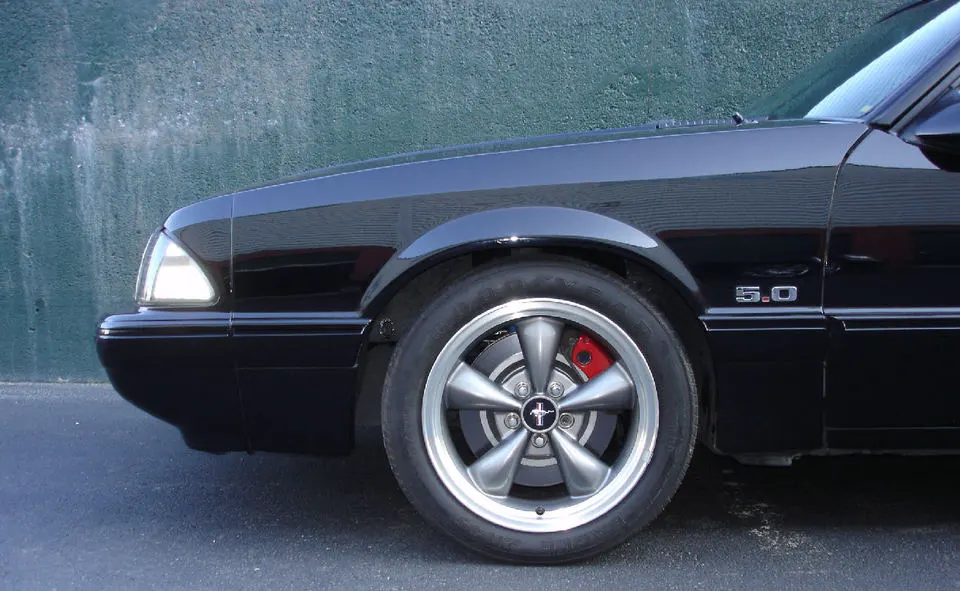

  10. 94-04 Cobra front brakes?
    Maybe i'm taking it for granted, but you know these work on Fox's right?
    pic.php?u=11130S5RAi&i=1146690
  11. That looks perfect! I was thinking Saleen SC or fr500... 17's
    Ok. Ya I was looking at something and they said requires 18s. Think was because of caliper size/shape. Guess I need to read some more, basically get the Cobra setup and you can pick your compatible rotor then ie drilled slotted etc...
  12. On some wheels the spokes will hit the calipers. On my old saleen American racing 5 stars which were 16's, they would fit over the brakes, but would need a spacer so the spokes didn't hit the caliper.
