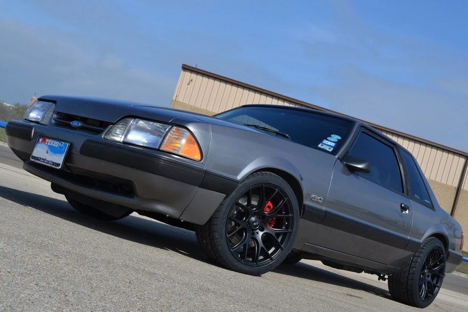

    I noticed that the tires are just behind the outer fender lip (after being rolled). If they're using the 96+ spindles, the wheel would probably stick out PAST the fender lip (18x9) but not by much, and depending on what tire they're using.
    This got me to thinking. Does SVE machine their branded wheels to work well with 96+ spindles so that its flush with the fender lip?

  5. Are you talking about this car OP? No extra machining is done to work with a fox body. These are off the shelve 94-04 wheels. 24mm offset.

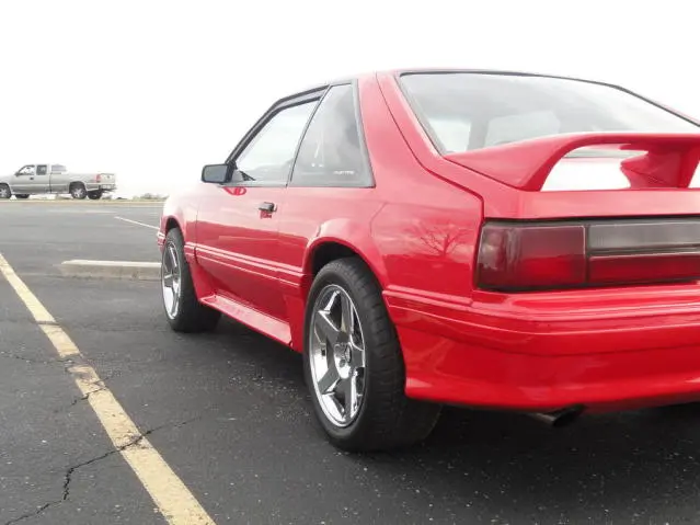

  7. 18x9 with a 24mm offset and 96+ spindles will sit right at the edge of the fenders. If you go with route I highly recommend a 255 tire with a rim guard lip on the tire. Certain brands have that and certain brands do not. The Goodyears that come on the GT500's have that lip. They are 18x9.5" from the factory with a 255. It's perfectly fine.
    My car below. I didn't have the lip on my tires, cause they were something I already and that means free. lol, but I woulda loved to have a tire with a lip guard.

  8. Yes, that was the exact car i was referring to. It looks so..perfect.
  9. I have 17x9 4 lug 2003 cobra wheels on and it has 255 tires on the front. BFG G-Force Sport, and sits pretty much flush with the rim lip.
  10. I agree, he should have never sold that car.
    Nothing extra went into that. We slapped on the brake kit, and then the wheels.
