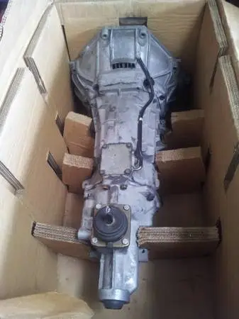

  6. I just posted a photo of the T56 I'm considering purchasing. Do you think the bell housing matches the T45 on my GT?
  7. Modular motors have the same trans bolt pattern on the back of the block. Since that T56 has the bellhousing with it you should be fine. I thought you wanted to know about bolting your T45 bell to the T56, and that won't work.
