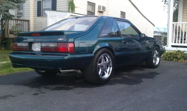

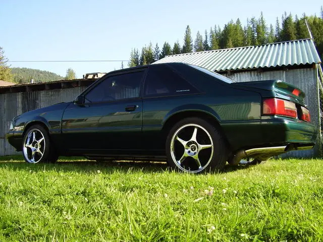

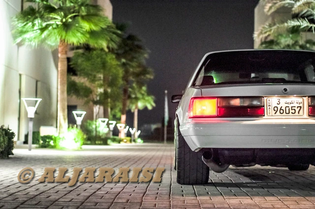

  1. I'm looking to run 3" mandrel out the back of my fox and have been seeing a lot of 3" cars where the pipe dips down and notches back up and out to the bumper like this:

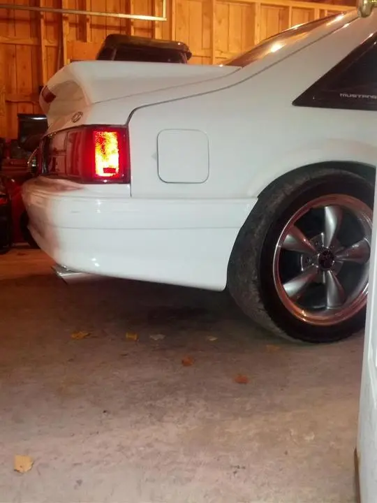

    I don't mind it, I think its unique, but I'm leaning towards the old fashion look where it is tucked up under the body with the tips run out, like this:
    I'm just wondering why people run the pipes differently. I can't see any clearance problems, but I assume I feel like it is just a preference or maybe it is just a lot easier to install...I dunno:shrug:

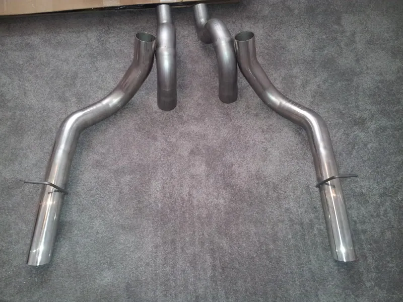

  3. The 1st 3 pics you have are the flowmaster 3" tailpipe kit. They are routed that way for clearance. Its pretty much the only way to route full-length 3" tailpipes. I bought my polished SS 3" tailpipes from VRS Exhuast through a group purchase on Corral. I haven't installed them yet but I always update my build thread.
    Here's a pic of mine. They will be routed the same way as the Flowmaster kit. And yes they are mandrel bent.
  4. I have that 3" flowmaster kit on my 89, and they do it for clearance. The part that bugs me is the advertise polished tailpipes, and yet you see considerable tail pipe by the tires that is not polished.

  10. my 3" tails are from Flowmaster. Normally they require you to add a longer hanger to them, but I kept mine as short as they came and the tuck up under a Cobra bumper real nicely
