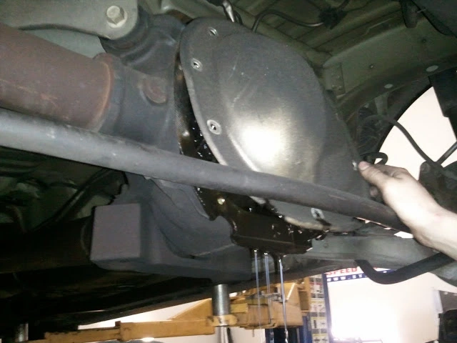

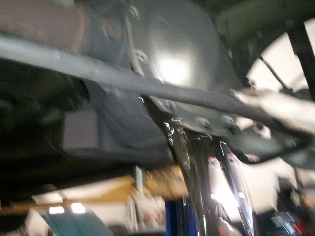

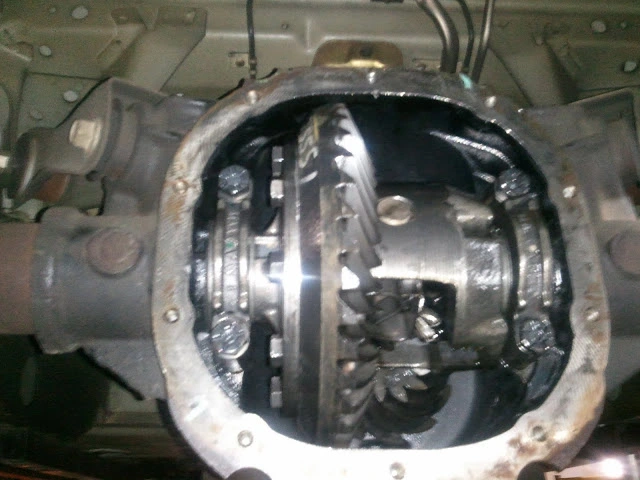

  7. Just cant get a break!! first it was the clutch, then the intake and now... the rear end:mad: Well I was pushing the car hard on the highway and started to feel a nasty vibration in the rear of the car, had my brothers shop check it out and the clutches are dead.:nonono: So next screen shots will be the install of a built rearend w/ 3.55 gears to help that intake.

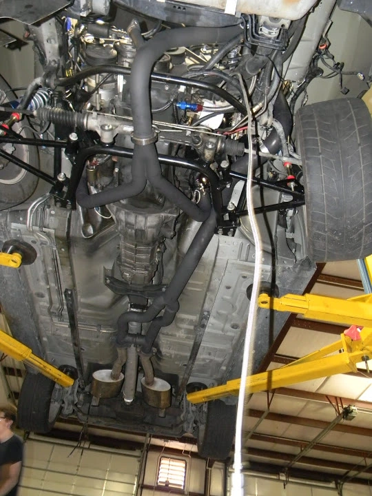

  9. How much ground clearance do you have with the downpipe underneath the K member?
  10. Not much its very tight, but it gets the job done
  11. The good thing though is that where the pipe is lowest under the k is even with the wheels so it raises up with the car when you go over bumps and stuff. My under k-member pipes are right by the wheels too, no issues.

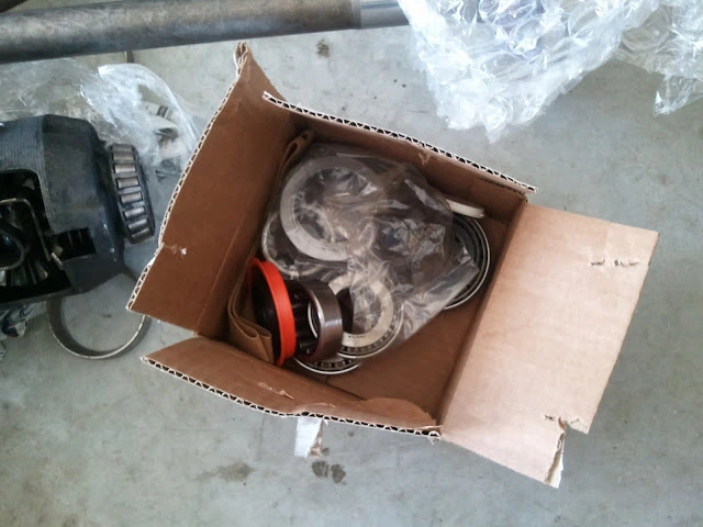

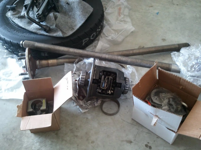

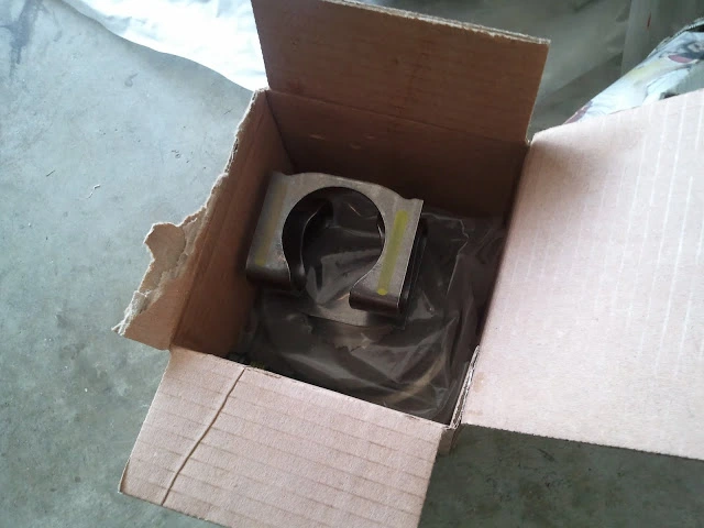

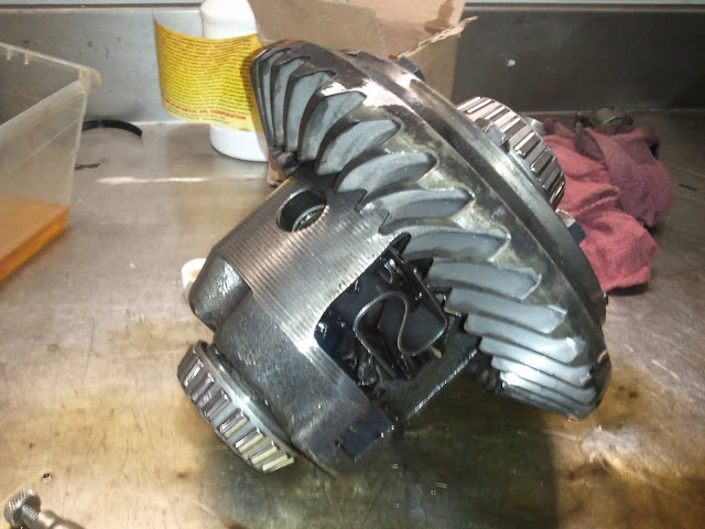

  12. Time to build that rear!!:nice:
    Parts
    -Moser 31 spline axles, with ARP studs
    -Ford Racing 3.55 gears
    -Ford Racing 31 Traction - LOK Limited Slip
    -Ford Racing Carbon Disk Rebuild Kit
    -Ford Rearend Rebuild Kit
    Coming Soon, 2v stock engine 10 second crusher...

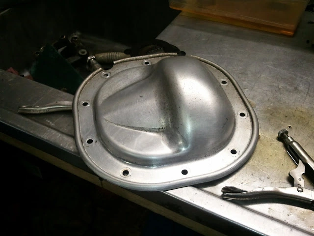

  13. REAR REBUILT:D Also added a 2-step to the car, I will post a video later today. Builds 4lbs of boost!

  17. :D I would love to but, IF it did go, forged bottom end (9:1 compression) , stock heads and cams, 14lbs of boost. Car is crazy fast already with an engine with 133,000 miles on it:nice: Working with my brother is fun, I rebuilt the diff and he installed it. Took a few hours to do.
