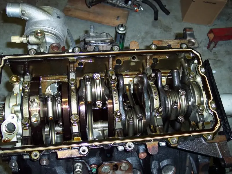

  5. Well to be technically accurate the Terminator block is a 4 bolt and the Teksid is a 6 bolt.
    Pictures don't lie.
    Teksid:
    Terminator:
    U.M.

  7. I dunno, Meat, I am looking at two bolt caps on the Terminator and four bolt caps on the Teksid, according to the pictures that you show.

  8. the teksid are 6 bolt, notice there are cross bolts on the mains. the 03/04 cobra block has the side bolts too.
  9. :nice: Correct! Both blocks utilize cross bolts.
    U.M.
