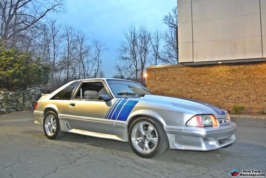

  1. I am pondering the top end kit on my 1991 GT.
    Has the kit been re-done since it was brought out? Basically in 2008 and 09 it seemed the kit wasn't living up to expectations. More recent reviews seem to be a lot better and more rewarding. My motor is stock bottom end on the Silver car and I hope to get it low 13's capable of the topend kit.
    Silver is 200k mile motor (iirc!)
    Has O/R Pipe
    Shorties
    70MM TB
    Stock MAF
    Stock 19#ers
    SR CAI
    SCT Chip
    3.73
    Car has run best in cool weather of 14.6 at 97MPH... 2.0 60 foot...
    Whattya think????
