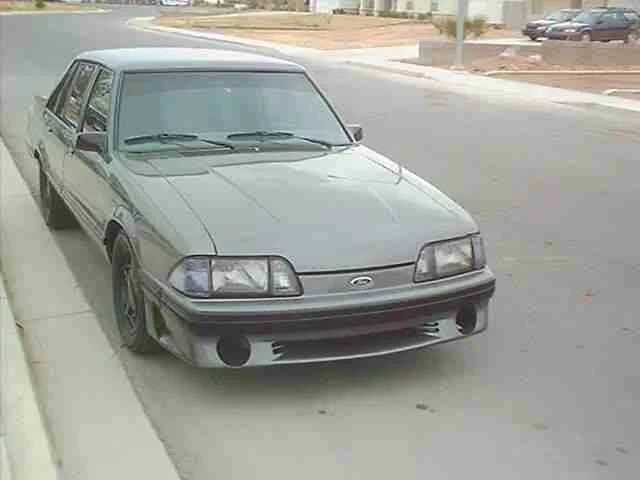

  6. jetmech807

    That Ford's new hi performance sedan? The Fairstang GT.

  7. RangerJoe
    RangerJoe Mustang Master
    Joined:
    Apr 26, 2010
    Messages:
    1,440
    Likes Received:
    277
    Trophy Points:
    94
    Location:
    Georgia
    Wow! It took me a second to realize that wasn't a mustang sitting there. I didn't see the four doors. Lol.

    Although that front end could be made to fit the car, (obviously) There'll be no references to Mustang with this car, new or old.
    The problem with Fairmont is there is no aftermarket for the things like tail lights, and T/S lenses. That means either I graft some other fox front/rear onto the car, or go with what I've got, and custom build what can't be bought new to replace the stodgy, broken old s hit. The plan for the tails has been 67 Cougar/Shelby, and I've had that stuff for a long time now. Whether or not I go with it requires some serious thinking, because I am having a problem trying to make the tapered tail lights fit a boxy rear end. I'm starting to see it work in my head, but haven't committed to any welding as of yet. I do plan to add a small little duck tail spoiler made from a single piece of 1/4 aluminum plate that will articulate. I also will have two honkin holes somewhere in the rear quarters w/ some form of scoop to feed the twin radiators mounted in the trunk for the A2W inter cooler. The front will be all fairmont, but with a marked reference to road racing with the bumper getting molded into the body lines more, with a small chin spoiler beneath, and a splitter w/adjustable clevis bars tied to the bumper. The un- obtainable front T/S's will become multi-led lit behind some kind of lexan lenses, and the hood will have a custom, steel "blister" molded onto it to allow for the high mounted turbo.
    There now,...that enough of a teaser for you all;)

  10. 7991LXnSHO

    That is like looking at a Salvador Dali painting. At least a Cougar/T bird front end would not be as mind bending.
    "madspeed, post: 8796576, member: 8969"]Are we going to see an aero front end?
    View attachment 87038 [/quote]

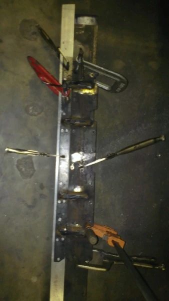

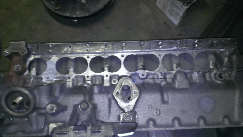

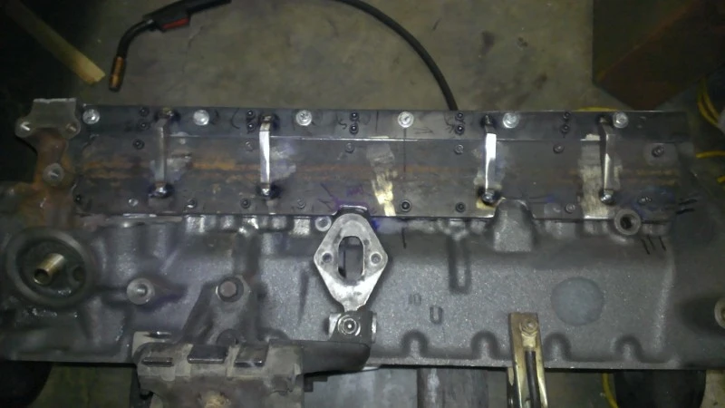

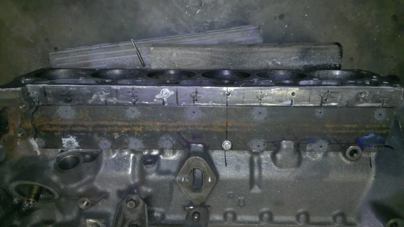

    I bought a kit from an EBay reseller w/ (6) 60 lb hr injectors in it for 224.00.
    I bought a polished Sanden 508 A/C compressor from another for 125.00.
    Then I got on Rockauto, and bought my replacement Harmonic balancer, flex plate, a '00 Taurus 105 amp alternator, and a 95 cobra 15/16 M/C.
    Then I went downstairs.
    For the uninitiated, non- inline 6 cylinder fans out there ( all 99.99997 of you), a Ford 250 has to have its head removed before you can remove the lifters. Conversely, the 300 I-6 has a removable cover plate on the side so that you don't have to do that stupid s hit.
    I decided to make my own removable cover plate for my non- cover plated engine.
    The real reason for the need for that is to be able to gain access to the lifter galley to re-link the roller lifters after I get them in the hole, ( that has never been done by the factory) for the roller cam, ( that has never been done by the factory).
    So in earnest, w/ my Dewalt 1/2" hand drill, and a 1.75 hole saw, I set out drilling a bunch of holes in .250 thick cast iron.
    The next thing that has to be done is, to "flatten" the potential mating surface where the future cover plate will eventually sit. No easy task, when considering the only things I have to do that with is a 4.5" angle grinder, and a regular old mill file.
    It ain't easy being me.:nonono:
    Living in Birmingham makes being able to get steel in various thicknesses, and strengths pretty easy. Several months ago, I picked up a small "drop" of 7/16" thick angle stuff in anticipation of using it for either my intake, or exhaust manifold.
    I decided to use it for the cover plate instead.
    Now I don't know what that steel was originally intended for, but it was the hardeset stuff I've ever tried to cut in my life. I swear, if there is such a thing as diamond steel, I had a 2' long piece of it sitting garage. Standard saw blades were useless, I had to cut it w/ a cutoff wheel on my angle grinder.
    But again, I managed.
    Next came the drilling, and tapping. 26 holes in all, all drilled and tapped at 1/4 20.
    The plate you see on top is glued to the side of the block to add thickness to the deck for the head overhang. The new bottom plate was now thicker than the top plate.
    On purpose.
    Lastly, I added a .125 plate ontop of the top plate to bring the bottom and top to the same plane, so I could add several vertical gussets ( made from the same beryllium-kryptonite I made the bottom plate from)
    The reason for that stems from concerns over whether or not I hurt anything integrity wise. I unfortunately will not know that until after its running, when it starts getting beat on.
    Now because the top plate is glued, I could not weld those gussets in place w/o concerns of hurting the epoxy, so I had to remove it to finish weld it.
    Once done, I bolted it back in place and turned my task to getting the distributor to fit.
