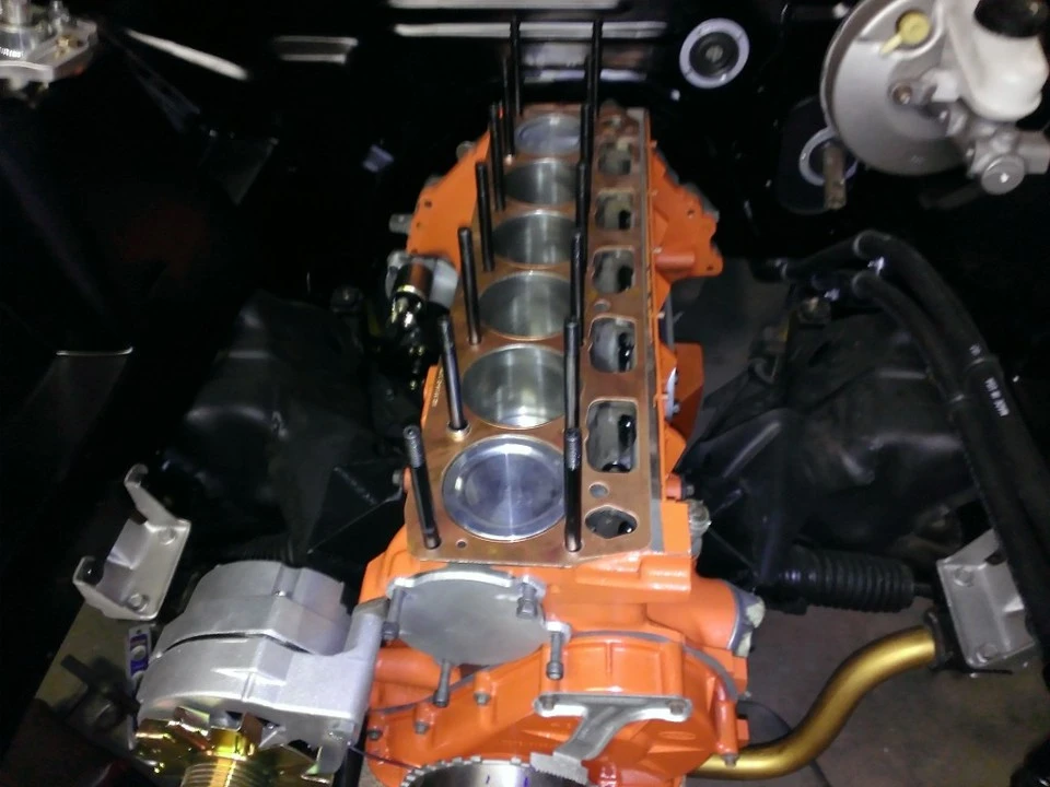

    I get the head back from the Machine shop yesterday, now drilled, and tapped for a 7/16th coarse screw-in studs in an attempt to straighten the mis-drilled stud bosses that they messed up.
    I also have come to terms w/ my head gasket. I paid for an SCE copper piece, and that is what I'm gonna use. I just hope that the Hondabond sealant will do the job and seal the water and oil passages like they think it will.

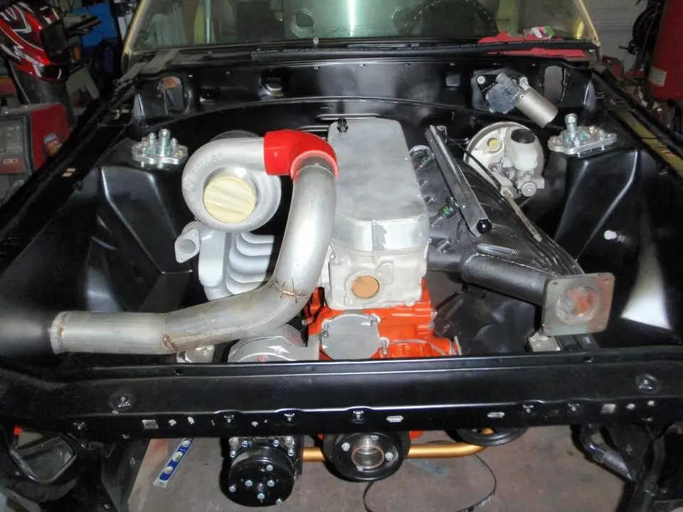

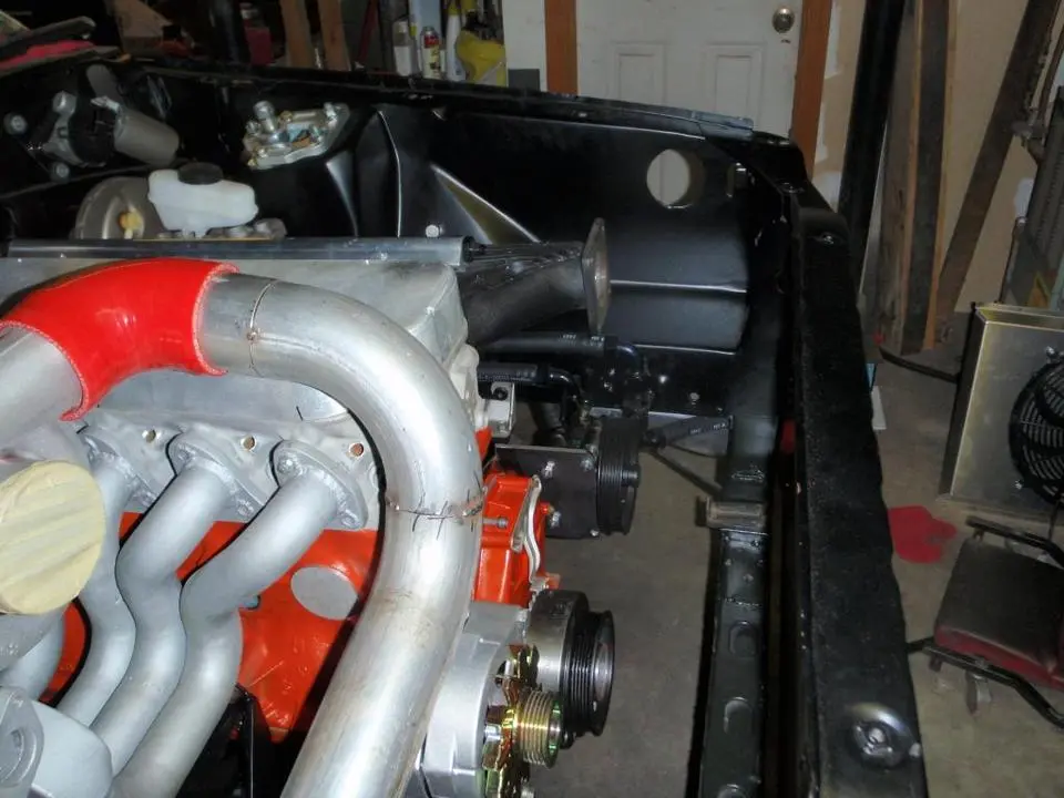

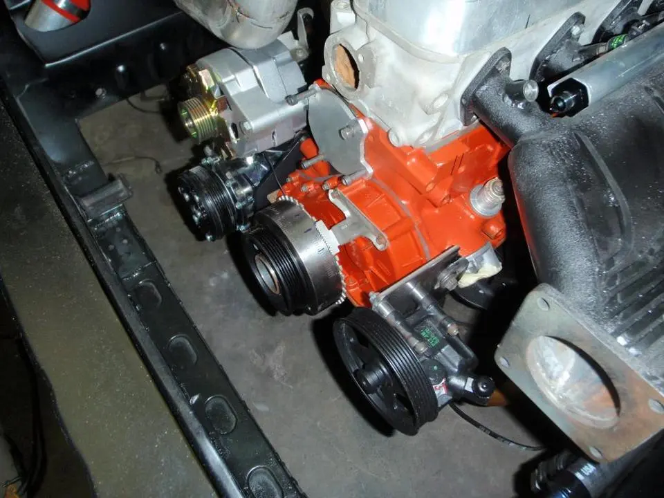

    Desperate to move forward, I decided to completely mock up the engine in the compartment to build the accessory brackets, and hang the power accessories.
    I start by installing the HG in question:
    I'm putting this thing on there dry just to mock up installed height for when the rockers finally get here so I can get the damn push rods sorted out.

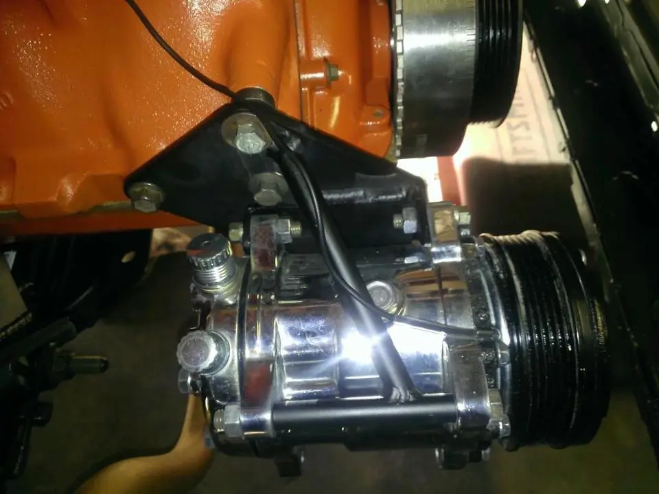

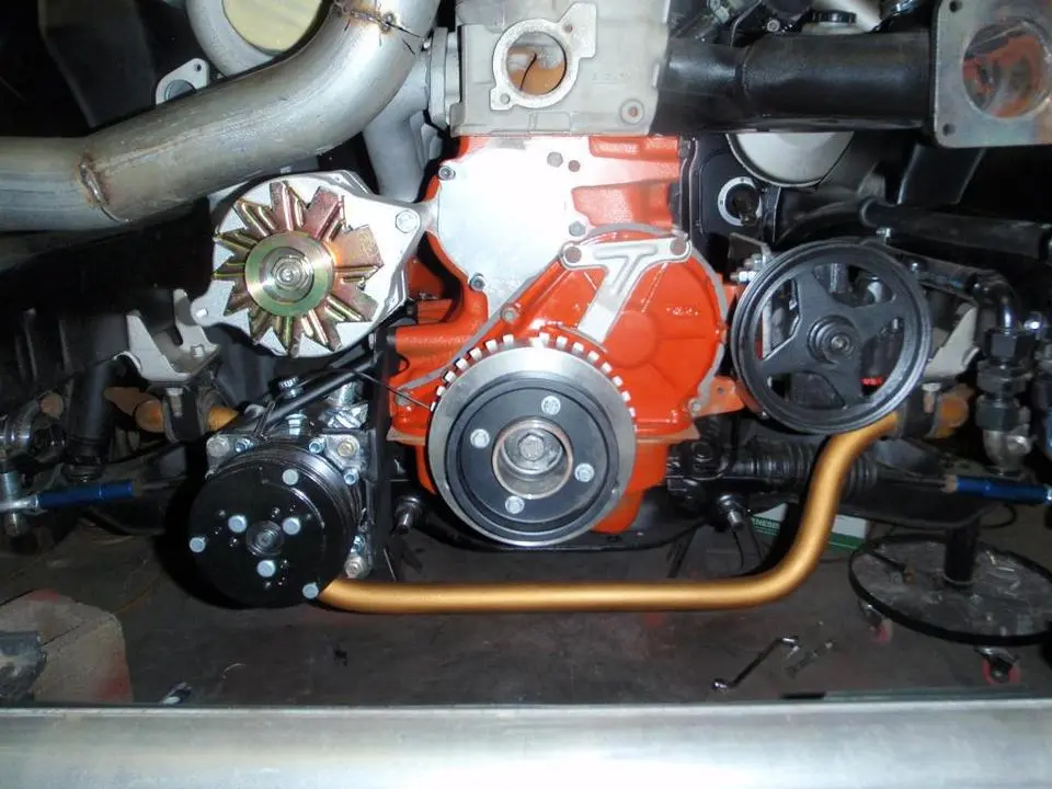

    I started by building the A/C bracket first.
    I placed the alt on top of that, but wasn't sure as to whether or not the exhaust manifold was gonna hit, so that's why I installed the head.

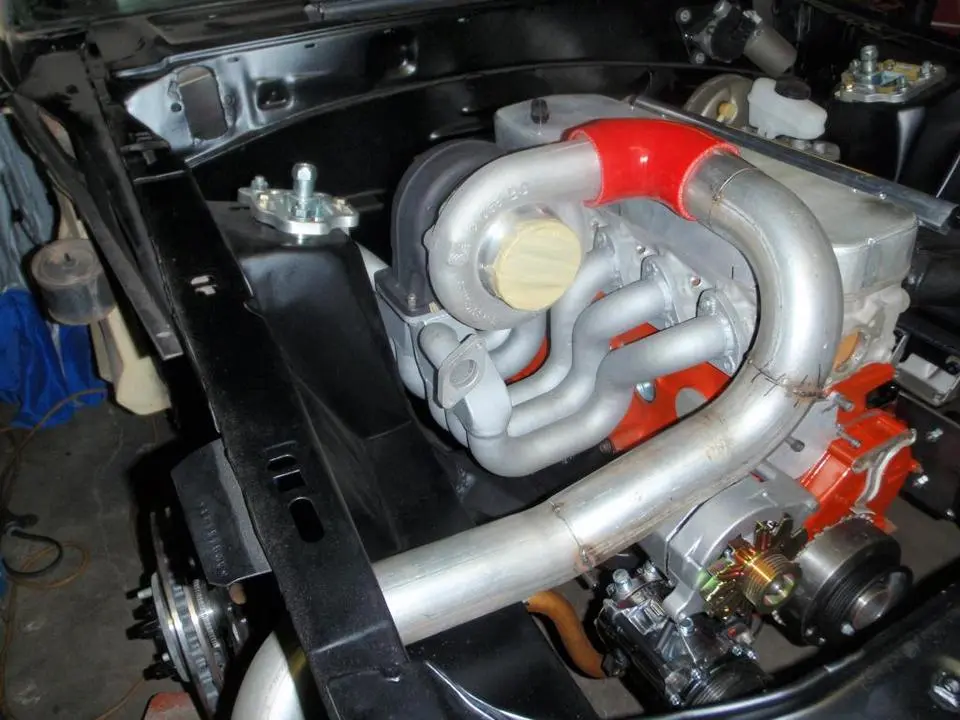

    Course, the head required the exhaust manifold. The exhaust manifold begets the turbo, the turbo begets the cold side piping, and finally, I throw the alt on top of the AC compressor.
    I'm gonna fix the alt in a non-adjustable position, and make an adjustable idler to tension the belt.
    Since there's no stinkin' radiator, I'll take advantage of the camera angle opportunity.
    Next I installed the intake so I could get the Cobra PS pump located.
    Clearly, I got no room to swing the alt anyway.

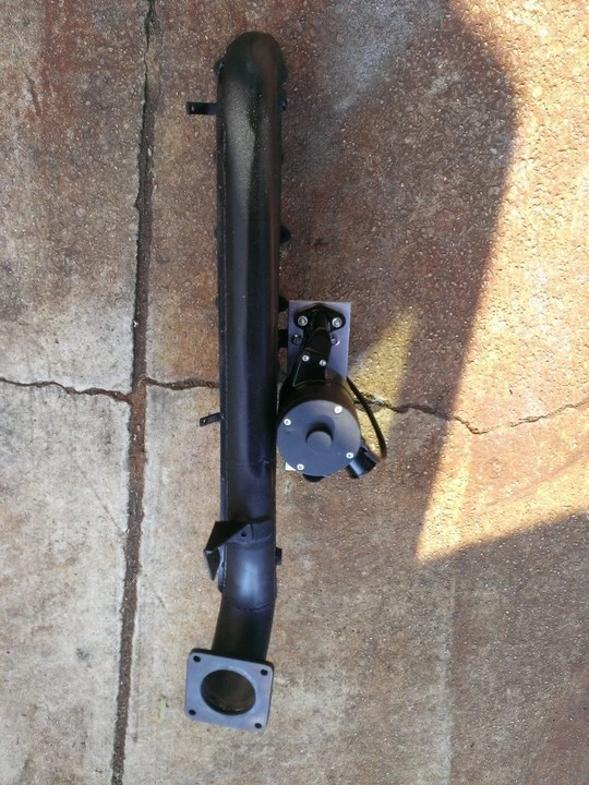

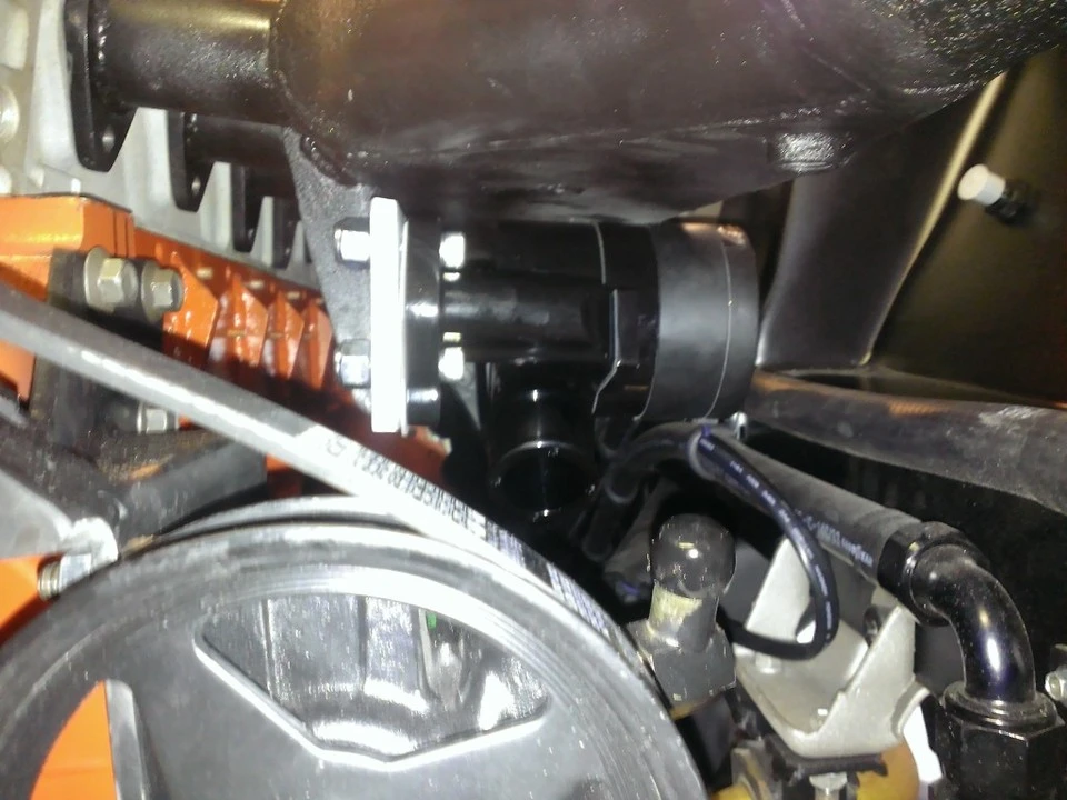

    I then made the block off plate that covers the W/P opening. I'm using a SBC electric W/P that'll hang from the intake in line with the block.
    The mock up wasn't w/o the usual drama though. The Intake will have to be cut up. I'm gonna have to put a 90 on the end, and orient the throttle body at 90 degrees to this pic.
    For obvious reasons.

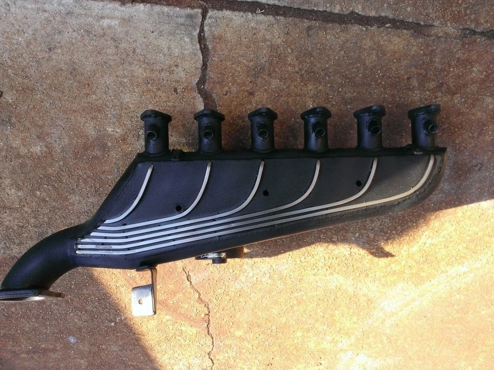

    The valve cover is still raw, but it will get RD's fins, painted wrinkle black, then coated orange on top so I'll have wrinkle orange instead. The head gets the orange treatment too, and I'll probably change the header color to black to match the intake.
    The fuel pressure reg will have to be mounted on the strut tower on the MC side of the engine bay.
    The engine is sat so far back, I cannot get the head on w/ the studs in place, and I have to set the head, then screw in the studs. Because of that, the planned location for the regulator at the end of the fuel rail is a no-go.
    The power steering pump in this pic is only held on w/ one bolt. I still have reinforcement brackets to make, as well as the mount to allow me to swing an idler pulley against the belt. I hope to get that done tomorrow.

    That engine looks quite badass in there. It's amazing what some turbo piping can do to an otherwise mundane engine. The more satin/wrinkled black, the better. The bare aluminum vanes are a nice touch. She's gonna look purdy!

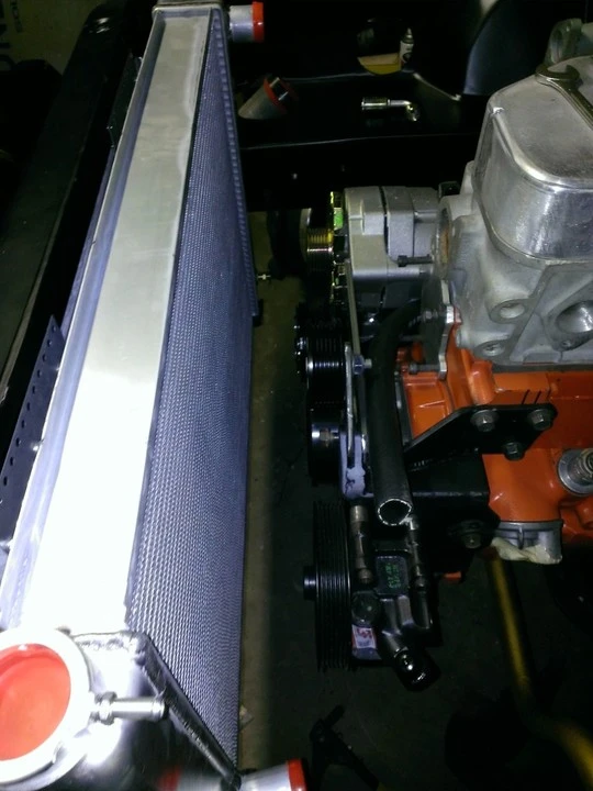

    One full week straight.
    What did I get done after working one full week on the car?
    It don't look like much.
    I completed the serpentine system, now all I have to do is wait on the day that I actually need it.
    After receiving the third Summit branded, Chinese radiator that was visibly twisted to hell, I exchanged that for a Griffin piece instead of the Howe.
    The irony here, is that had I chose the Griffin in the first place, having to butcher up a perfectly good lower radiator saddle wouldn't have been necessary. In truth, to use the Griffin, I had to modify the "modified" mounts, and return them to their original locations.
    I modified the intake manifold to accommodate the 90 degree turn that was required to allow the throttle body to fit.
    I fabricated a plate and bracket system to support a SBC electric water pump, and hung it from the underside of that intake.

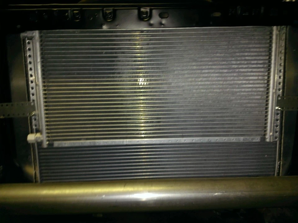

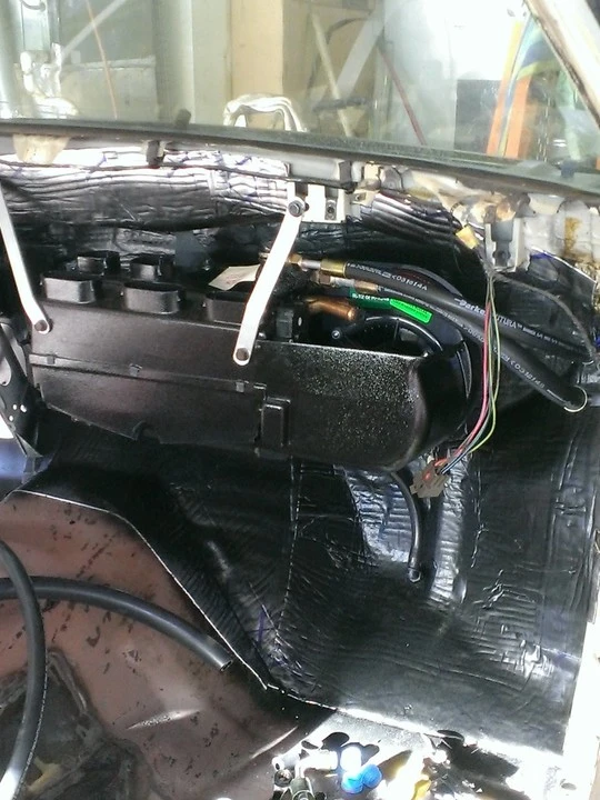

    I hung the AC Condenser in front of the radiator, and hung the evap unit under the dash.
    Before I hung that evaporator, I covered the firewall in the sound deadener junk I bought off of ebay.
    That is all.
    see the SBC pump just peeking out?
    The inlet is almost a straight shot to the lower radiator outlet. I'll run two -12 lines out of the pump and plumb those into the block in 4 different locations, and split one to a -10 that feeds the heater core.
    The whole evap case is a fraction of the size that stocker was. All of the mode doors are electrically actuated, so vacuum isn't a problem. I just dusted the sound deadener w/ bed coating so if by some chance the carpet doesn't cover, there wont be so silver beacon under the dash.
    As big as the condenser is, I should have no problem w/ heat exchange.

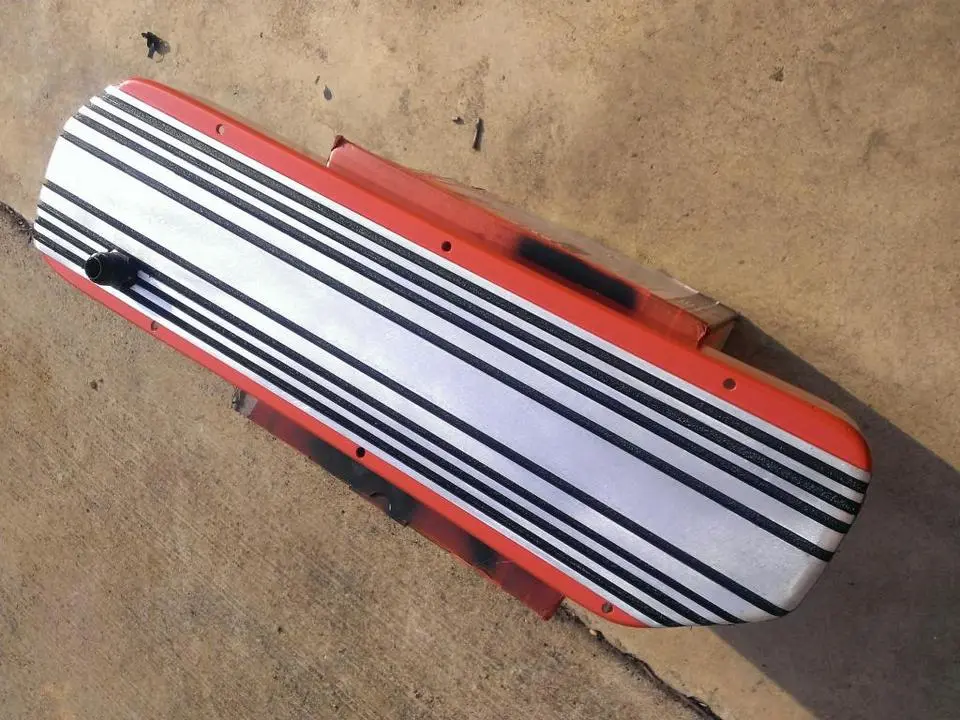

    Created @rdharper02 's fins. Glued them ****es on too. I tell ya, I don't know how long, or whether or not this thing'll even hold up considering the entire thing is glued together. After the fins were dry, I ran a router w/ a carbide round over bit to trim the edges down. While I was doing that, the bit snagged one of the outside edges of the last outside fin, and ripped the fin clean off the valve cover, sending it sailing across the driveway.
    Now that did give me pause for concern about how well this thing will hold up, but I dismissed the thought.
    CONCERN
    :think:
    (How many more times am I gonna have a router in the engine compartment, using it to mill edges of over hanging aluminum bar anyway?):thinking:
    **Now I got to use the two new e-motes,.....scratch that off the list.
    It's not bad, and it's not great either. But it is better than the raw original version I first built.
    Two more days, spent building this thing that I won't have to scramble around as the end of the build nears.

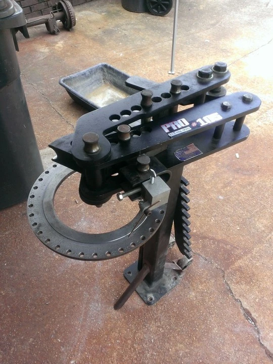

    Bought back my tubing bender cause I'm gonna need it for the interior.
    200.00 w/ an 1.250 4.5 radius die.
    I paid 399 for the thing w/ the degree ring back in '08, plus about 200 for the die. Save for a little surface rust, the thing is virtually the same condition as when I sold it in '12.
