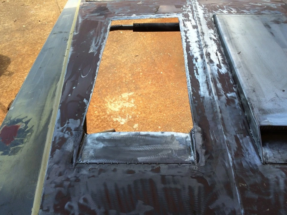

Given that I said that I wouldn't unless somebody could see it (and @jrichker saw it straight away) that left me with the only option available to me.
To cut the old piece of junk off of the hood.
But first, I had to convince myself of that.
It's made from .20 ga steel. Using steel that thin goes against my grain as it is just a giant pain in the ass to work with. Since I had it laying around, I used it. What I got was a piece that ended up w/ an "oil can" effect for what ever reason.
The YouTube solution was to use a torch (an oxyacetylene combo is what I used) to heat a small dot to cherry red, then quickly quench that spot w/ cold water. That process is supposed to shrink the metal, and "tighten" it up so the oil can effect gets pulled out.
I did that.
While it worked, it left the top of that scoop full of dips, and bumps.
This morning, I decided to see if it could be saved, so w/ a hammer and dolly, I tapped and pecked, pounded, and banged on the thing trying to get it to flatten out.
The oil can effect returned.
I got the torch back out and heated up several more spots.
The oil can effect was gone.
Only now, there was a surface that looked like it had been through a meteor shower. Now I could come to terms w/ cutting that oversized, warped assed piece of s hit off the hood.

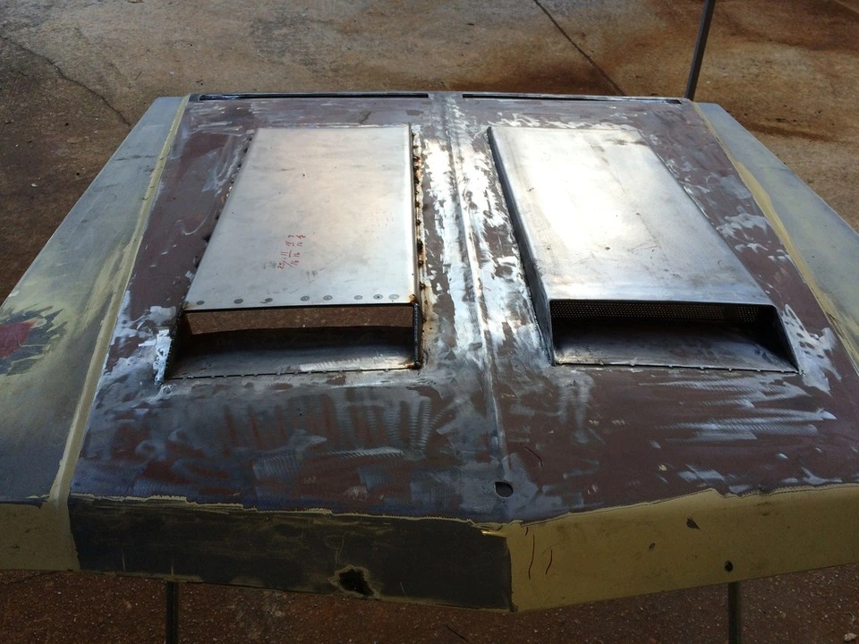

So I cut it off.
This is what it looks like w/o the scoop on top.

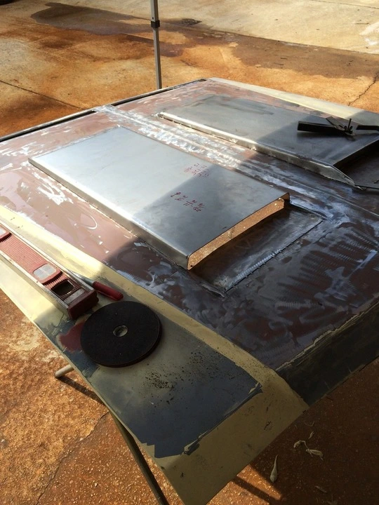

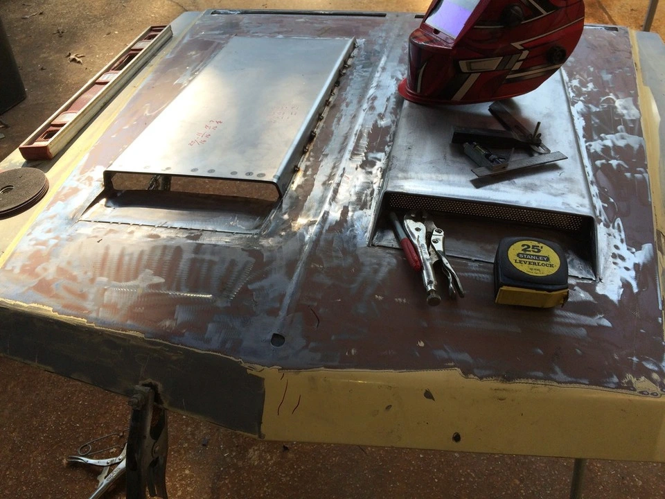

So now that that was behind me, I set about cutting, and bending the new piece.
* For some strange reason, this stuff cut like 16 ga.,...and it bent like 16 ga.,...but it measured like 18ga.

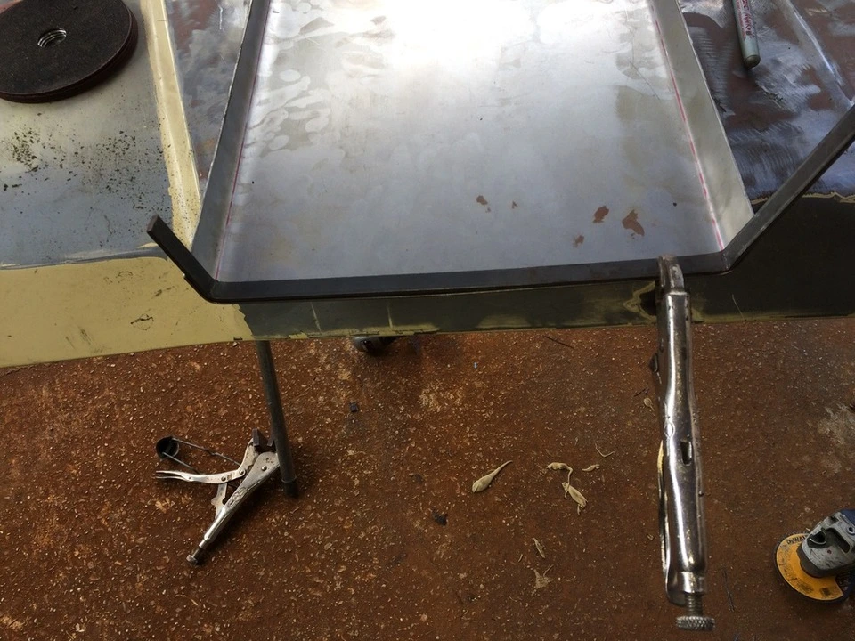

The pic above show the thing after bending, and then the front 1/8" x 1/2" reinforcement that goes along the leading edge to give me a "stop" to put the grille against.
So now I got this piece tacked in place, and only requiring the little triangle dudes that make up the front transitions;
Still have to build the grille insert, but the left, and right G nostrils match each other.
