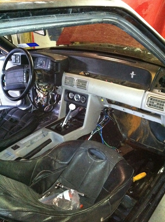

  12. On the bright side, I did manage to get most of my dash and center console back in. I thought about waiting to do the console until I got new carpet, but decided not to.
    Uploaded with ImageShack.us
    Still have a loooong ways to go in the interior department. I am by no means proud to show off any of this car yet. But this is a progress thread, whether it moves forward or backward, hahaha
  13. Those seats dude,..........:nonono:
  14. LOL... Meh, I know a guy that does seats.
    Ill change them eventually, just for you, Mike.

  17. Hey, I appreciate the consideration,.....but no amount of seat foam and new fabric can fix those,.............................sorry.:shrug:
  18. Mike does seats for free. :nice:
    88LX5.Oh likes this.
  19. Carbed (for now)
  20. I know, I know. I'll get some different seats eventually. They may look like a bag of a**holes, but they aren't too bad to ride in.
    Aside from that, I'm not sure if I'll get any work done as far as finding and fixing this leak today. I've got a pinched nerve or something in my lower back that is giving me fits, to say the least.
