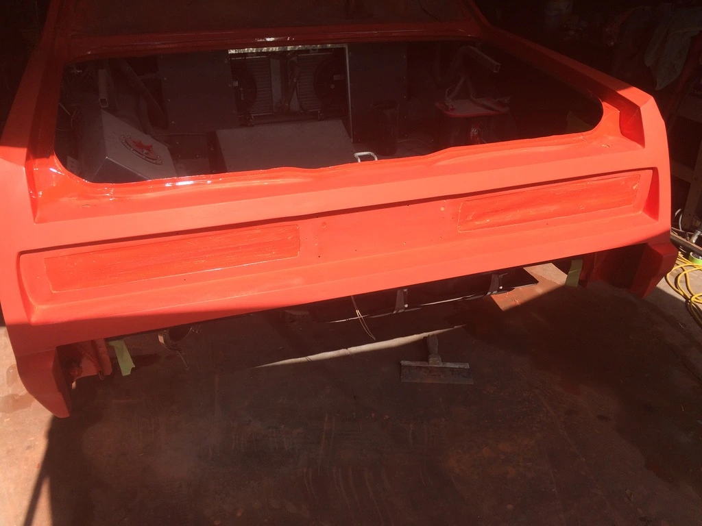

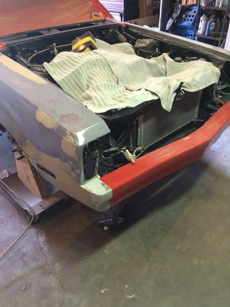

Well,...we bolted on the front bumper, and the fenders,.and started shaping things up.
So that brings me to a point where I gotta wait for filler to dry.

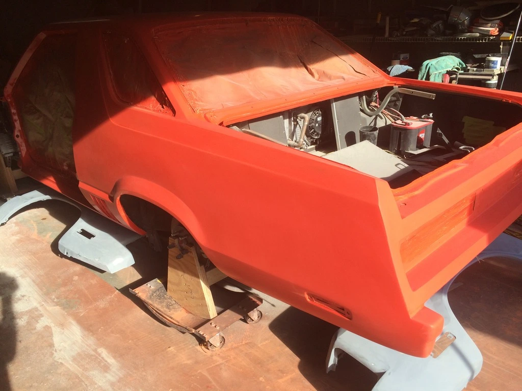

Next out comes the trunk. I expected that it was gonna go smooth, as it was basically completed..
I sprayed two coats of primer,......Why the hell has this become so easy,...and spraying the good stuff resulted in such a bad thing?
I mean,......Orange peel?......
There aint no stinkin orange peel.....

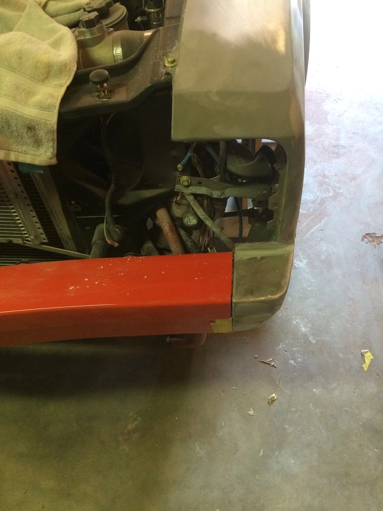

The fenders get focused on today. I'm happy to say that they are almost ready for primer. I was gonna do just that, but it kept on doing the surprise sprinkle thing, and the fenders would've got caught in that. Additionally, The stupid assed rattle can green etching primer that I used just wasn't dry enough to sand, and it kept clogging the paper. My day in the garage ended at 2:30.

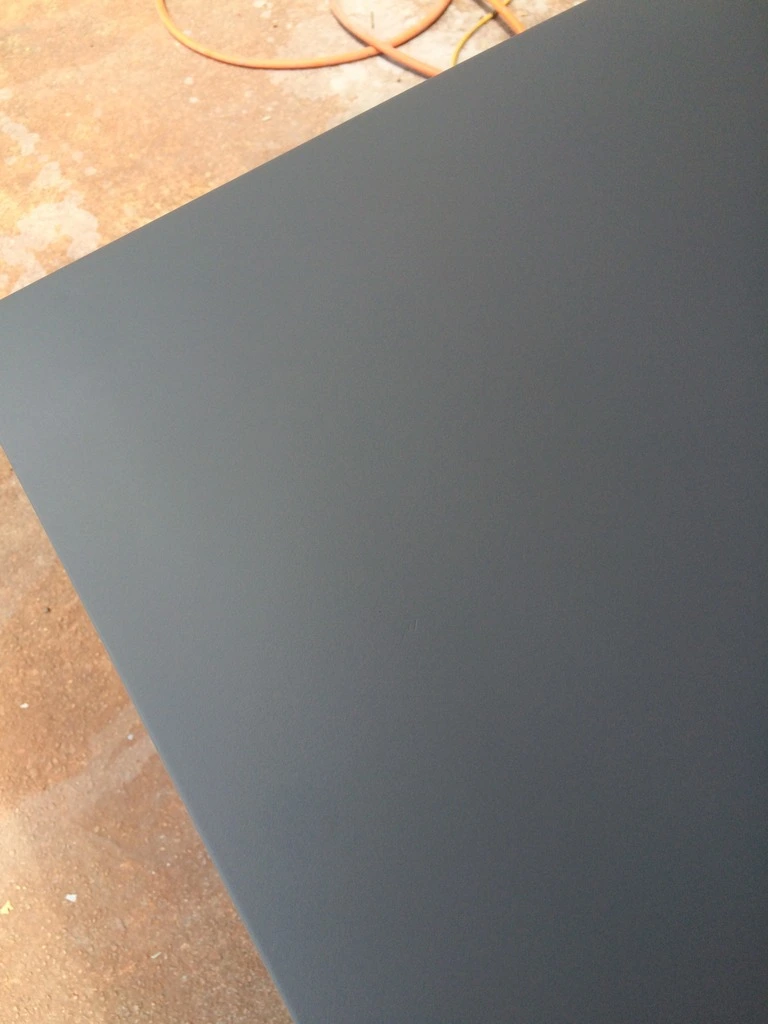

I was thinking in the interest of saving time, that I'd paint the undersides of the trunk and hood in lieu of your eventual arrival here.
Additionally, there are the small pieces that got hurt that'll need a recoat, so maybe buy an additional qt. in addition to the gal?
And,...In addition to that,..I've got areas that are gonna get painted Satin black:
Excepting the hood, the Tail light panel; grille, all grille mesh ( exhaust, vents, gills,) and the top of the doors. Painting these before hand will allow us to mask those small areas off so the orange will butt up to it, as opposed to having to mask off a whole bunch of orange to paint a small amount of black. I was just planning on rattle canning those areas But I'll leave that to you to tell me whether or not to go through the process, and use spray-able paint there alternatively
The hood will also get a significant portion of the center painted satin black, but that two tone I'm gonna have to defer to you. I can/could do that on the bottom of the hood so again that'll be done. I've had really good luck with that satin, It is the paint that is in my engine compartment, on the dash, and door bars,..so I have sprayed it before.
Your thoughts here DavedaGerman hater?

The key to me is painting orange first and then go back and put the black on after that cures. Doing it this way will leave you a far less defined paint line. Plus the black will have the appearance of a factory styled decal. Much more professional looking that way Mike. I've masked off countless panels to spray a matte/semigloss finish after painting the vehicle, it won't be a big deal.
I would put the black on after if it were my car Mike.
If you want to paint the little parts that need orange ahead of time that will need the black on it as well, then I'll show you the way I mask things up that works for me.
The extra quart of paint couldn't hurt.
Go ahead and jamb the hood and deck lid. That'll save us time.

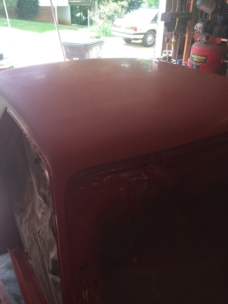

That "progress" brought me to lunch time. I took a break, and came back down. I drug the fenders outside shot them w/ a couple of coats of primer, and put them in the sun to dry.

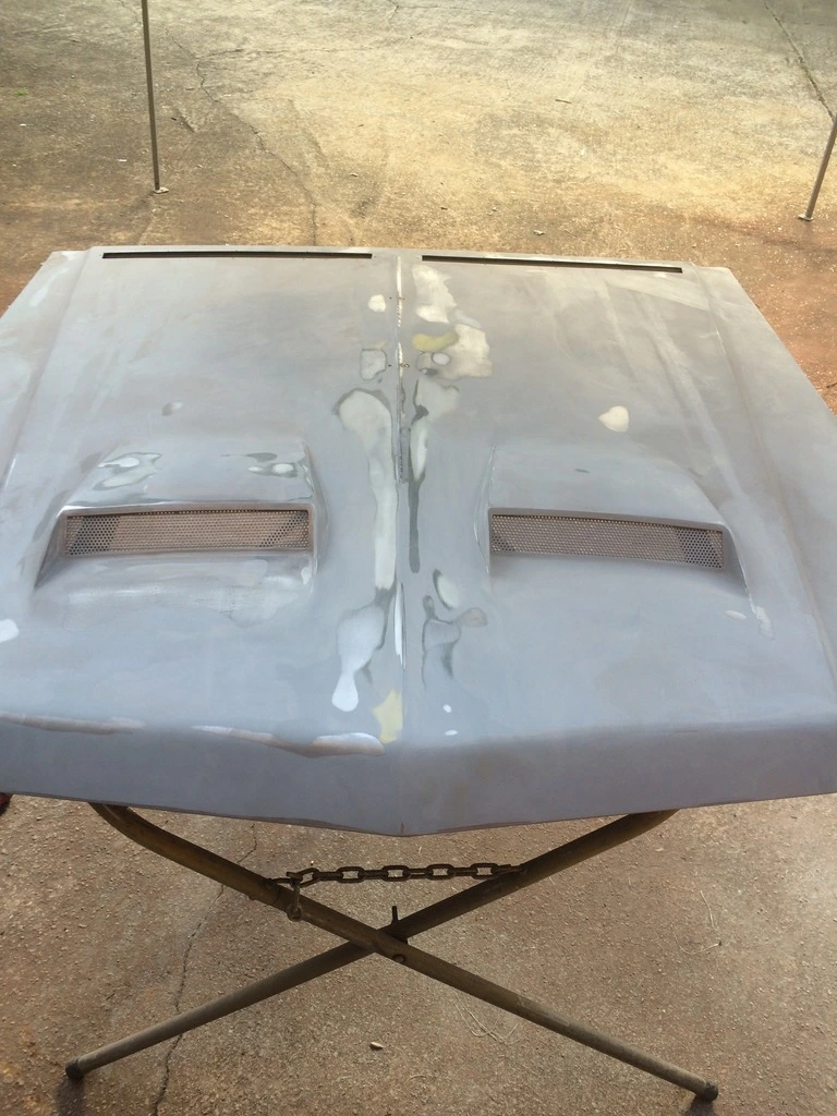

Then,......the hood. The wonky ass center line, primer needing to be stripped back off,....oil canning, stinkin' hood.
This Hood.
I started sanding the thing, but since there is no under hood structure, the thing just flexes like mad. Nothing to be gained by going any further until I fix that.
Why is there no under hood structure you may ask,......Well,......because the center rib had dents in it. The under structure obscured the center rib. I had to cut it away. When I did that, that left the hood very flimsy.
I came up with a Home Depot solution.
I welded a shelf standard in the middle of the hood. ( Kinda looks like a scary Halloween mask don't it?)
It burned through the bondo on top, but this hood is such a mess, I wasn't close enough to care about that.
But it don't oil can anymore.

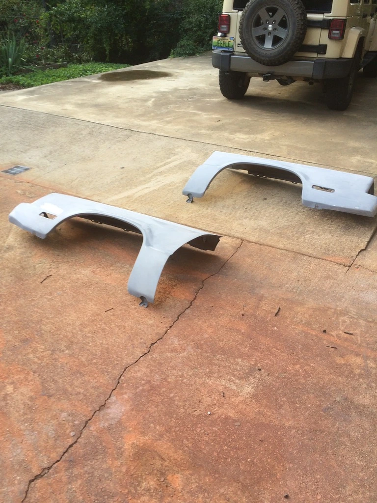

But, what about the fenders?......You keep saying you're working on the fenders,.and those stupid things are never in any pictures...
Ok......you're right.
Here those dorky looking things are.
