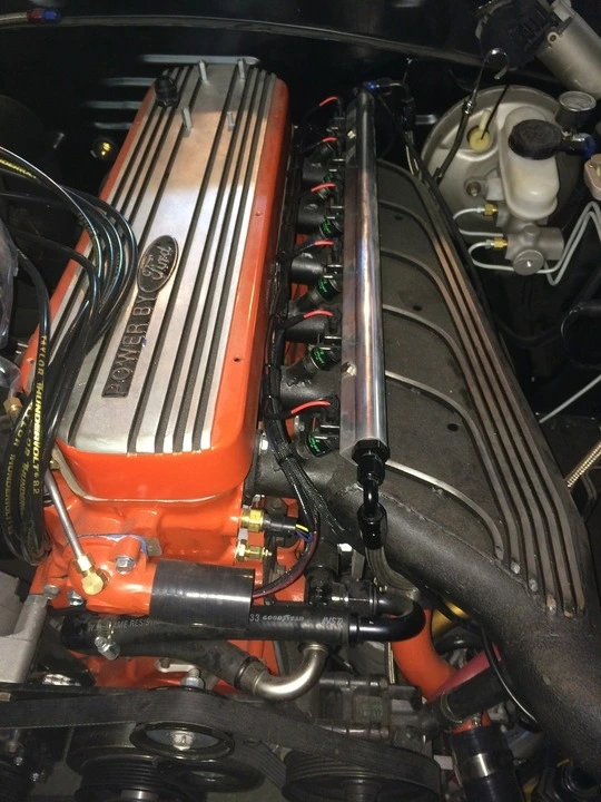

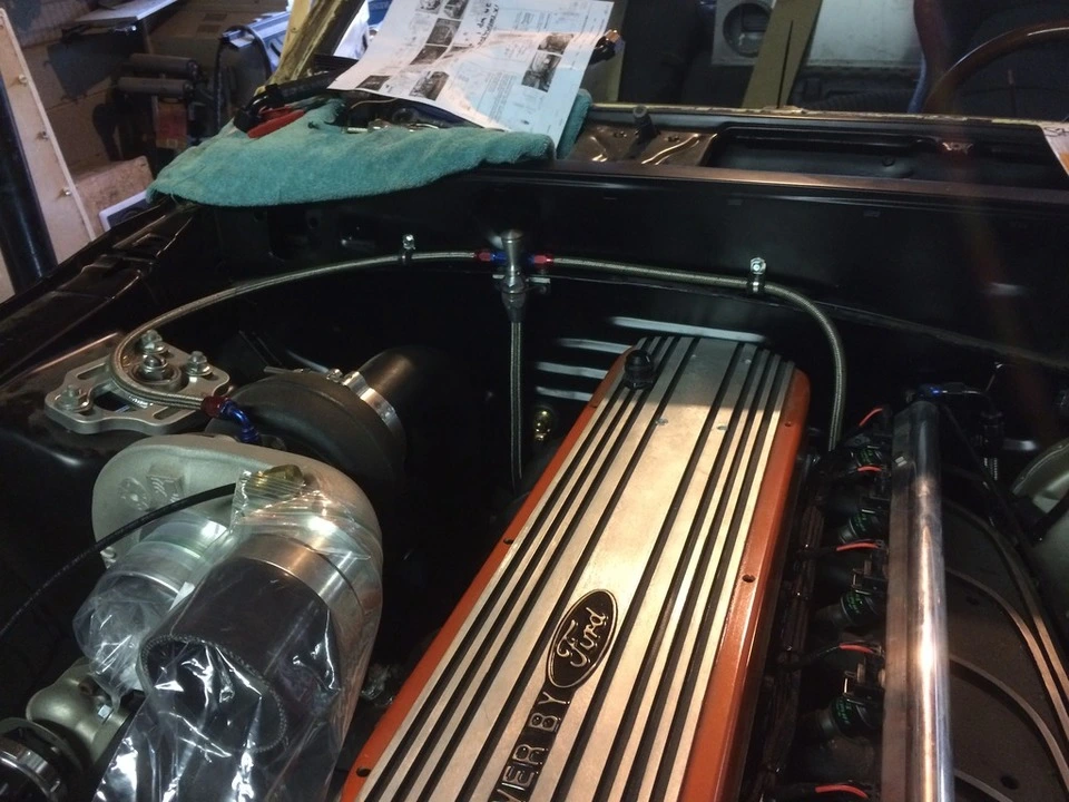

Got most of the engine wiring done (at least under the hood). Structuring the wire is by far the most time consuming part of the deal. Making sure that every wire splice is exactly as long as the other conductor so that the wire will bend uniformly. Couple that to the fact that I do stuff twice (or more) if I don't like something, and seemingly I spend all day to do little of nothing.
It looks all tranquil and peaceful-like now. In that wire bundle is the VR signal from the EDIS, power, and ground for the same. CLT temp, MAT, TPS, FIDLE, TACH, water temp, oil press, and six injectors. Version 1 had the injector harness wrapped in about a mile of black tape. I shoulda reminded myself before hand, that I absolutely HATE wires wrapped in black tape. So I cut it all open, and did it over. (one example of me doing something twice). I still have to add the water pump, and the cooling fans. They require a relay, and are wired back into the MS board in a place I'm not yet certain.
On the passenger side I'll run a separate grommet for the A/C compressor, and the electronic boost control solenoid, on the Driver's side, the wires for the WP, Cooling fans, brake light switch, and all of the chassis related junk will come out there.

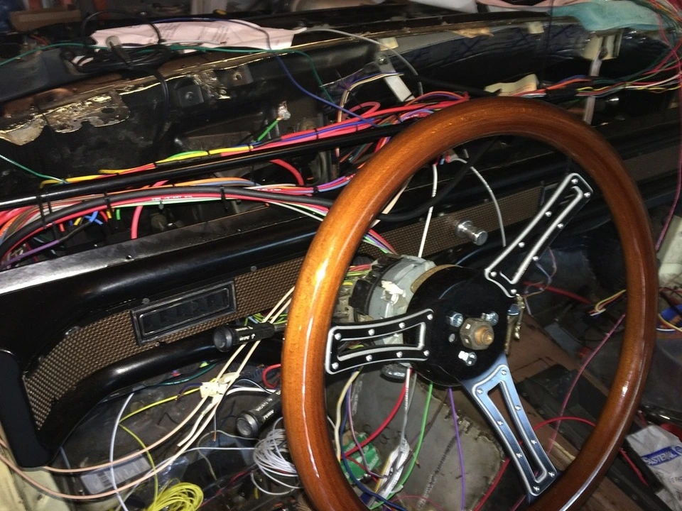

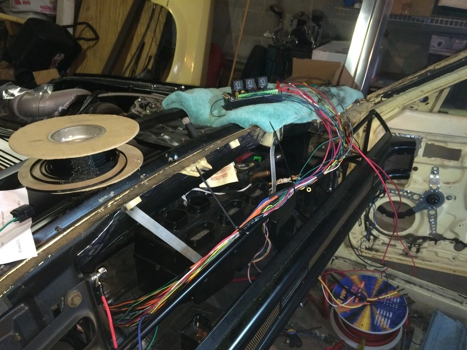

Counter to the tranquility under the hood, is the mounting Chaos that is starting under the dash.
I figure I'll bite into it a little at a time, and do each area (i.e. the engine bay) one at a time.

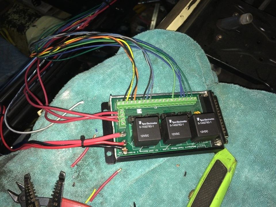

Fortunately, I built the dash to be easy to wire. The relay board actually mounts upside down (when it's mounted) that way a fuse can be seen by removing the lower right panel. But until then, I'm able to wire the thing standing up.
Tomorrow won't be so easy.

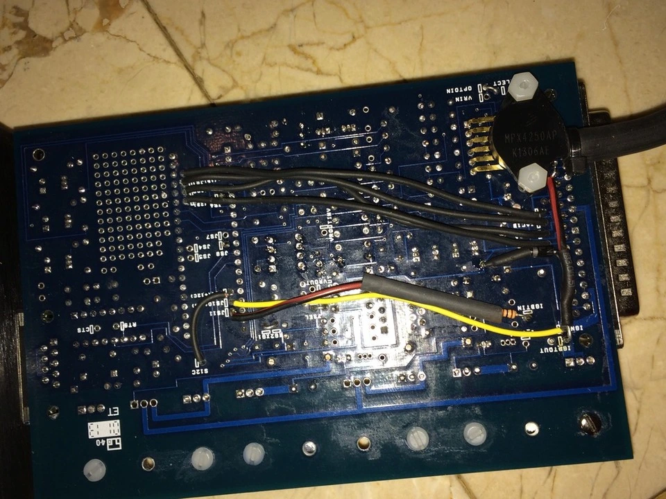

On Saturday Night I opened up the MSII to modify the thing for an electronic boost control circuit. The assy, of the entire MS is well documented on their website. So well in fact that most of the questions that come up are answered for you. Everything is laid out in fairly plain english, with a small explanation if necessary to why you have to do something to the board one way or the other.
Evidently, the boost control circuit is too simple for that. I have looked for hours for a similarly easy wiring diagram, WITH explanations for why you do what you have to do to make the thing work.
No luck. Just a schematic. No "hook this here", and "jumper this there" instructions when you go to "boost mod wiring diagrams" on the DIY autotune website.
If there is a complaint coming from me about megasquirt, how you are relegated to ask for help (via email) is LAME.
Evidently, however many guys are working to resolve the questions are not enough, and where as you might be on hold for an hour waiting to talk w/ some other tech,...you can wait a day, or more to get your question answered, God help you is the answer still doesn't make sense, or they didn't answer all of your questions. I bitched the guy out I'm working with for glazing over my questions, and only offering the most cut and dried answer his poor little tired fingers could muster. Over the last ten years, I've bought three of the damn things, spent close to 2 grand on do it yourself "kits" and when you try to get more than a one sentence answer for their tech guys,..you're asking too much.
Oh well. I guess I'll wait till he gets good and ready to respond.

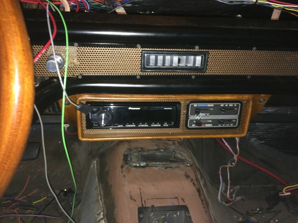

I did paint the center main gauge bezel black. ( I actually let it sit for an entire day, and painted it w/ a new can of paint that dried to the touch in 3 hours, and could be "handled" in 5. So I was golden.

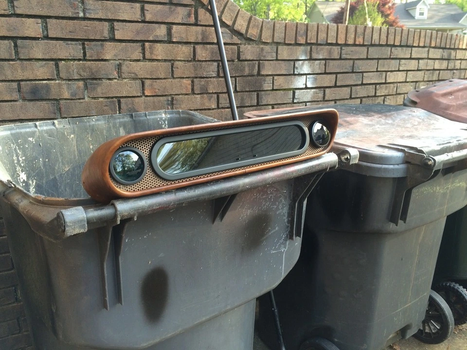

The only pic that will be featured in today's update will be of the gauge pod, now dressed in black, w/ a different boost gauge that more closely matches the Innovate.
Kinda says......."Dave,......are you there Dave?"
^^ This look like the beginning of an animatronic trash can, honestly I'm a little freaked out. If I was out in the garage working over the car only to turn around and see this trash can tapping me on the shoulder, I would likely pee my pants.
All kidding aside, I really like the way the gauge pod turned out. I also feel your pain with the wiring, it's one of my least favorite things to do for sure!
Ever watch Doctor Who? Looks like an Alabama Dalek.
Evidently, an "Alabama Dalek" is a robot w/ a trash can for a body that got ran over in the street and has no lid because of that?;)
It never looks that way when you are taking the pic, but when you actually look at the "rendition" that's when see stuff like robotic trash cans w/ antiqued, leather covered gauge pod heads.
But thanks for pointing that out to me,..now my already "vivid" imagination will allow me to create an imaginary artificial intelligence living organism in the shape of a busted ass trash can that I can talk to in the garage while I'm working.
I think I'll name him Trashy MacPherson.:rolleyes:

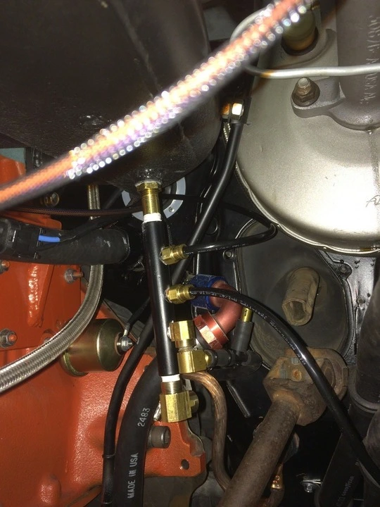

Everything is getting really tight under hood. I woulda thought that an I-6 in a fox engine bay would've been like a small fish in a big pond, but it's turning out more like a whale in a swimming pool. Everything I'm doing now seems to interfere w/ something that was done months earlier.

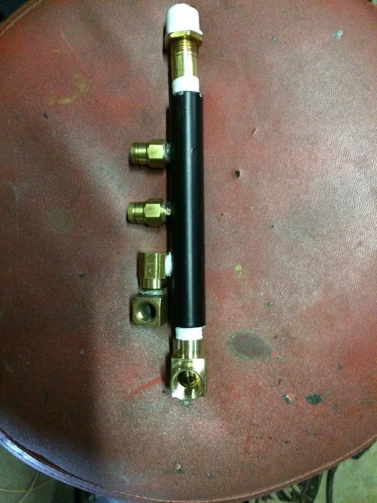

The vacuum log is one case in point. There is a 3/8"NPT female pipe fitting at the back of the intake manifold that was intended for a vacuum tree screwed into it from underneath. Between the myriad of hoses that now live under there now, and the recently added engine wire harness going through the firewall back there, adding that vacuum tree proved challenging at best.
If I can get a camera up there to do that any justice you'll see that for yourself. But for now you're just gonna have to take my word for it. It's getting to be a real pain in the ass.

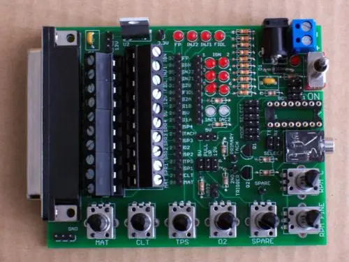

I come back into the house and hook my Megasquirt to the "Stim" board I also built form a kit to verify that the thing works, now that I am programming in variables.
i.e. The water pump stays off until the engine reaches 150 degrees. There is an additional "condition" programmed in that will not let it come on even after the engine reaches 150 or above IF the engine RPM is below 500. (i.e while it is being cranked to start/restart it)
i.e. The cooling fan comes on at 180, and goes back off at 170 (I'll probably up those numbers after I get it running right) Additionally, there is still the same condition to restrict it's operation below 500 RPM.
i.e at any engine temp below 145 the fast idle solenoid opens, and closes @155.
Most will remember that I was waiting on MS tech to respond to my questions about the boost mod. Although they did eventually respond, the damage was already done. I had went ahead w/ the circuit mods on my own. If it don't work right I'll deal w/ it, for now I buttoned the thing back up.

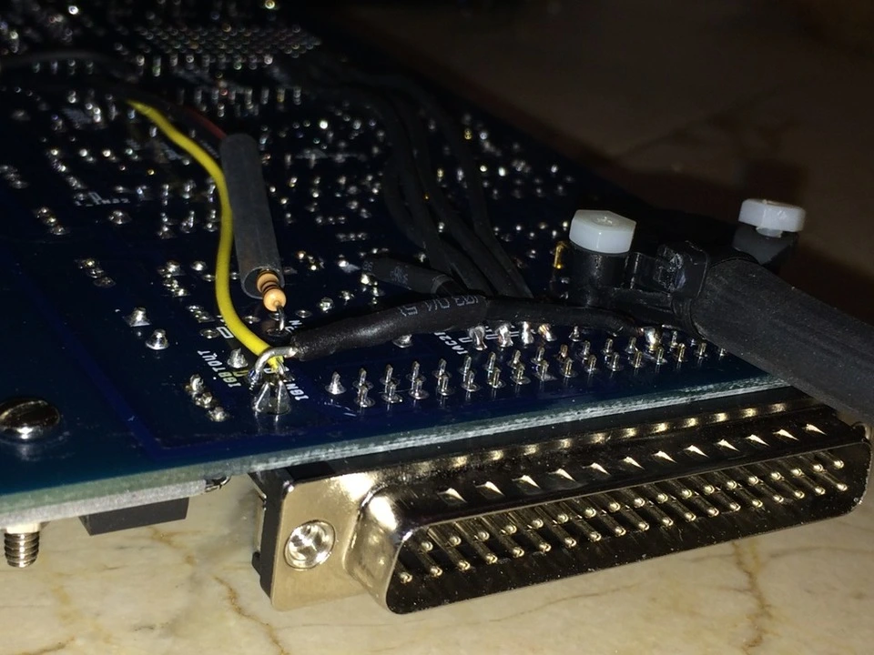

This is what the boost mod looks like. Any mod made to accommodate the user configurable parameters looks like this. The four black wires turn the
IAC stepper provision into those programmable outputs instead. Since I'm using a more primitive "on/off" idle valve, I don't need the IAC stepper. Not using that lets me re-purpose those outputs so that two of them now drive relays that control the water pump, and the cooling fans.
All this to say that now the ECU is hooked up to the stim to check all that junk out. (didn't I say that already?)
The stim looks like this. All of the knobs and lights there to simulate a running engine. This is an upgraded version that even allows you to duplicate an EDIS-6 ignition system.
So the test begins.
My Injectors are batch fired, w/ 3 of them firing at once. In programming, you can opt to have each bank of three fire simultaneously, or alternate. I chose to alternate them.
I start Tuner Studio, turn the knob that simulates RPM, and the led's that represent start to ping-pong, indicating that each bank is firing alternately.:nice:
The led that simulates that the fast Idle solenoid is open, and letting in additional air is lit. I turn the coolant temp knob up till the gauge in Tuner studio says 155, and the light goes out. 2 down :nice::nice:
The fact that the tach gauge on my computer responds to the RPM knob means that the modifications to accommodate EDIS as my ignition system is successful. :nice::nice::nice:
I turn the coolant knob back down below 150, and put my multimeter on the output that simulates one of the now re-purposed IAC outputs. Turn the knob up to 150, and the output sends a 12v signal to my meter. That means that the water pump just turned on. Check :nice::nice::nice::nice::
I continue to turn the knob up past 180 and check the other port now dedicated to the relay for the cooling fan,... the meter again reads 12v. I turn the knob back down to 170, and the meter goes back to zero. I'm Golden.:banana:
The entire ECU is set, it checks out completely. I can now put it in the dash. Huge load off me.

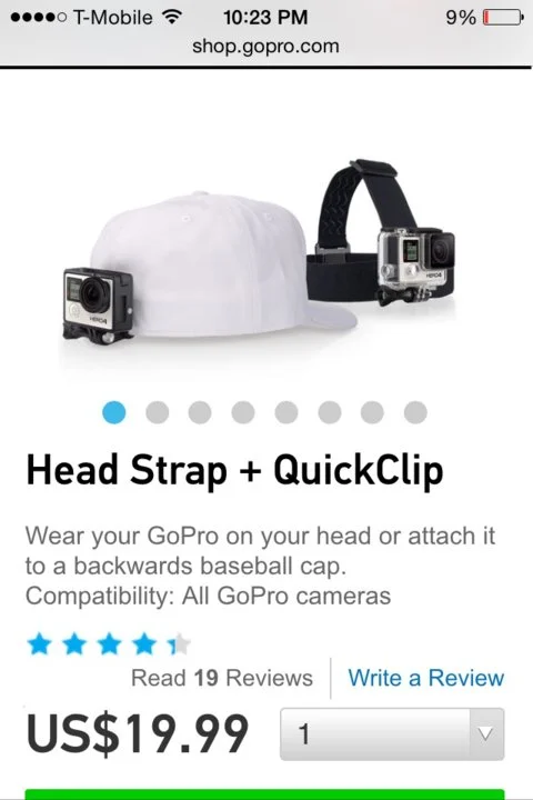

I really hope you fire up the Go Pro on start up day. Enjoy your time off at Work :rolleyes::D
You know I got one,.....I just gotta get one of those head band attachments to be sure that I never cross in front of the lens. (I'd just freeze up, and stand there)
I've thought about it, and maybe if the thing was attached to me where it didn't get in my way, I'd use it. We'll see.

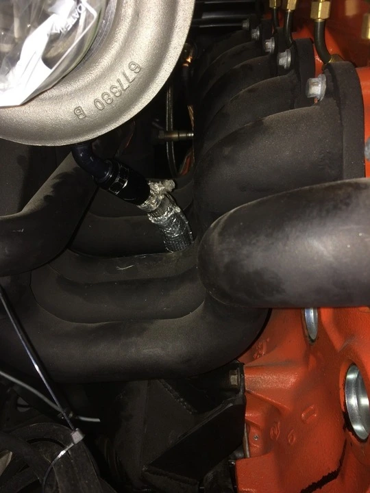

I removed my oil drain line, and wrapped it in some left over heat shield crap I've had laying around for 10 years, and put it back on.
No longer concerned about melting it.
I plumbed the oil feed line to the turbo, and installed the transmission dipstick tube.
