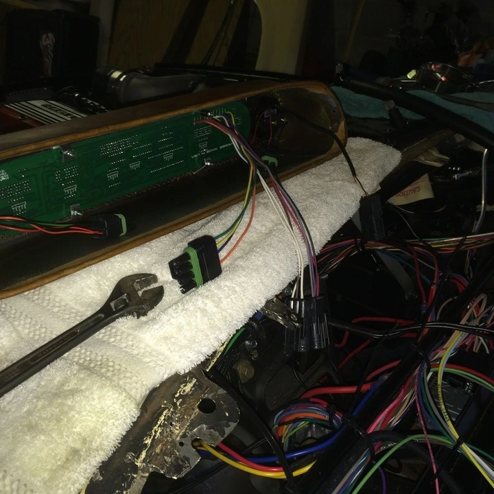

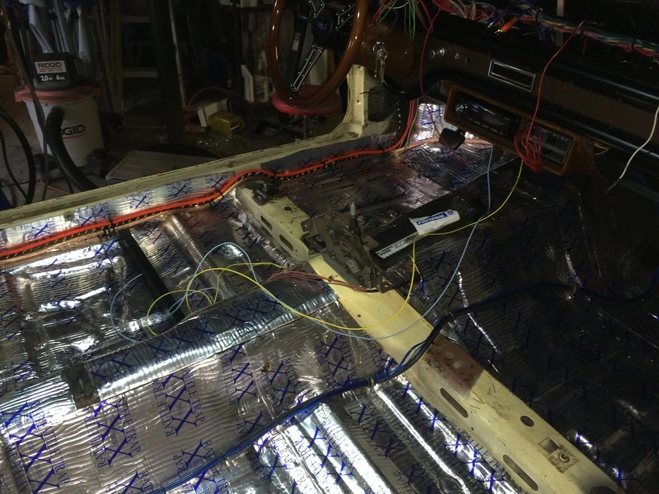

I decided that I was gonna get back on the wiring, because I wanted to finish up the column and get it buttoned up. I started off doing just that. I got the wipers working,....but not to factory spec, I have three positions,....low, high, and off. What's missing from that is the magic that is the "park" mode, where the wipers reset themselves instead of just stopping where you turn them off. (How to make that work is beyond me).
Bottom line is
#1. I don't care.
and
#2. If this car sees more water than what it gets from washing it, that'll be a miracle. So for now the fact that I have working wipers w/ both speeds is 21st century stuff.
I figured out the headlight circuit, and I now have working park, headlights, and high beams.

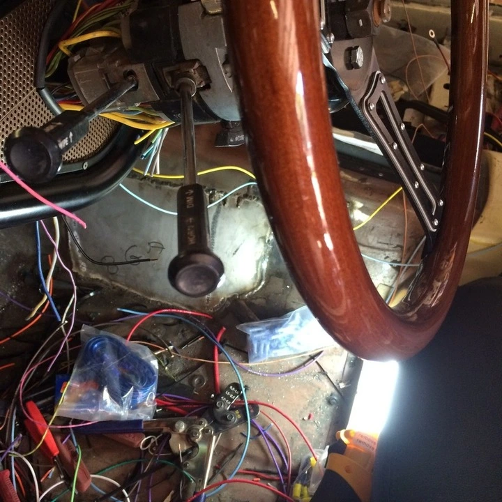

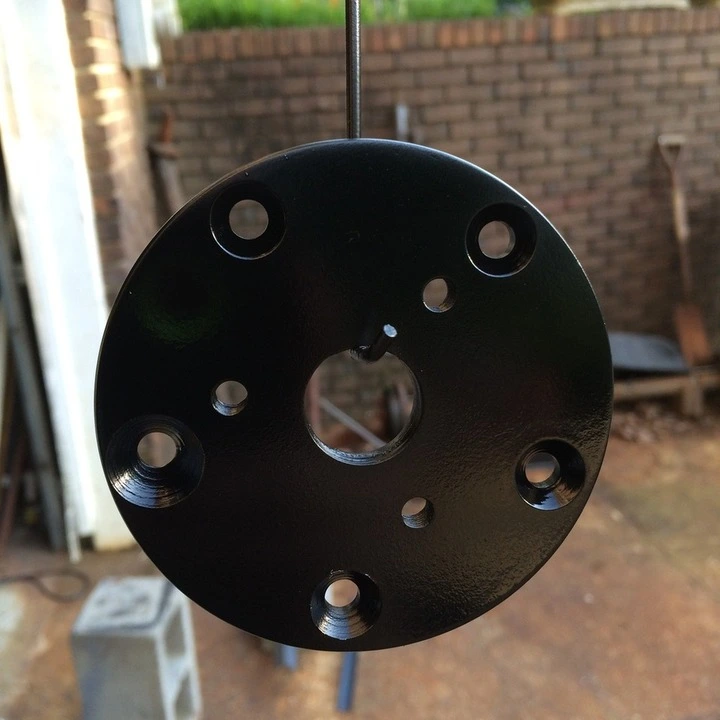

See, when I first hooked up the low beams, I had nothing. I hooked up the high beams and I had that, but no lows. I thought "you dumb bastard, all you gotta do is dim the lights back down to low beam. But I couldn't. That stupid new steering wheel is so close to the lever, it wont let you pull it forward to dim/brighten the lights.
Now when I had the other wheel, I had a black gloss billet spacer that spaced the wheel back 2". This wheel doesn't use that spacer, it won't fit.. So I had to make an adapter to allow me to use it.

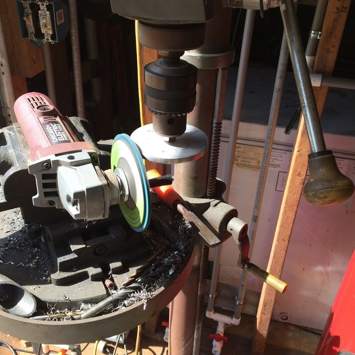

I transferred the circumference of the spacer onto a piece of 1/4" aluminum, and cut it out w/ my portable band saw. To get it perfectly round, I drilled a hole in the center big enough to getva 7/16 bolt through, then chucked that dude up in my patent pending, redneckified, poor mans' Bridgeport.
This thing worked like a champ. W/i a minute it was perfectly round.
I'll tell ya this, If nobody comments on this, I'm just gonna stop posting. I deserve a cookie for that one.
I drilled it full of holes, hand sanded the thing after that, shot it w/ some rattle can, and Viola' a spacer/adapter:

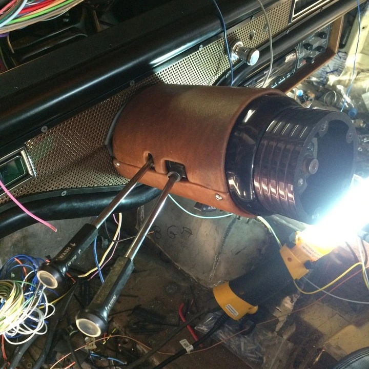

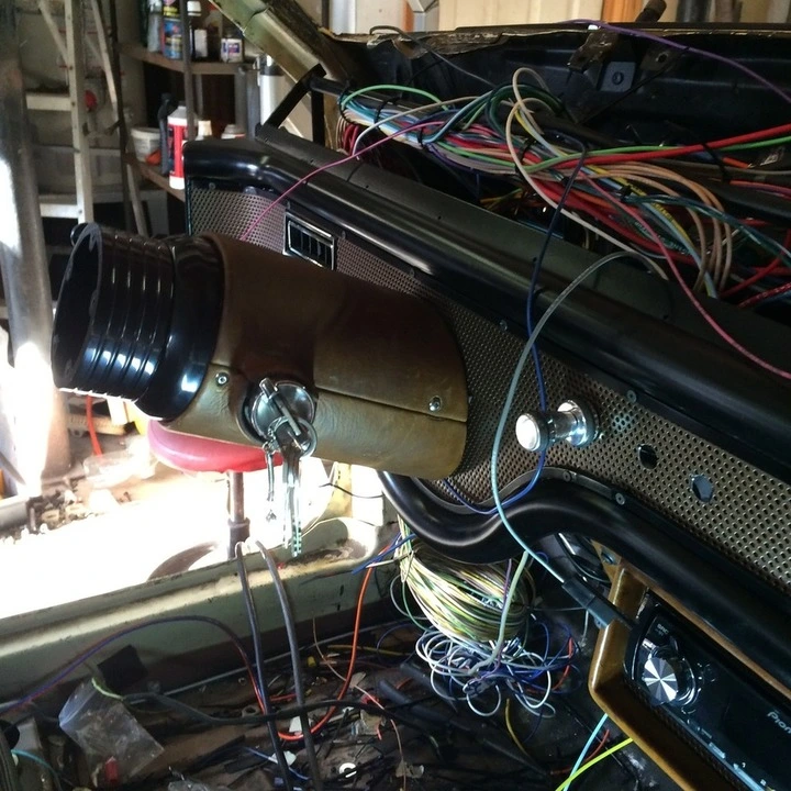

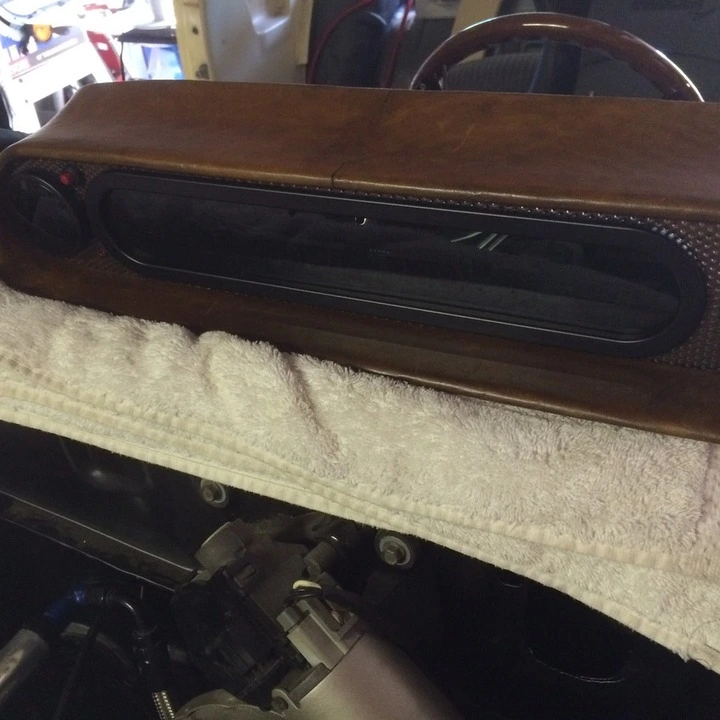

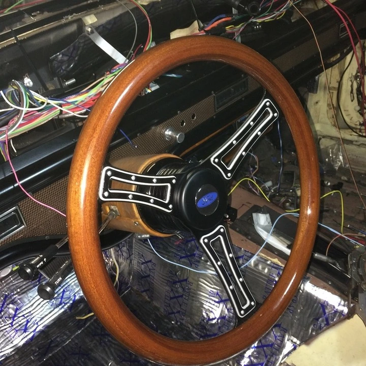

Now that I had the column all wired, I wanted to close it up. Months ago, I made the column trim out of steel. Today, I decided to wrap that steel in leather.
(Big mistake)
The holes are drilled and tapped for the thing in it's naked state. Covering the thing in leather add's at least 1/8" between the two halves, and now none of the holes come even close as far as lining up. Lets not even mention what kind of a pain in the ass it was to cover, now the stupid thing wouldn't go back together.
I had to modify. I had to adapt. I had to overcome. I made it work.
Not perfect by any stretch of the imagination, there are some raw edges in a couple of places, and I think the steering wheel is gonna rub. But since I didn't have the screws to bolt the adapter onto the spacer, that'll just have to be another bridge I cross another day.
