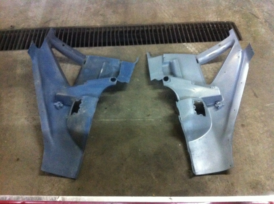

    I painted some interior pieces using LRS rattle can interior paint. I was actually surprised at how well it worked out and how good the paint covered. I figured one can per big interior molding but 1 can alone almost covered both pieces. I had enough left over to do 3 more random interior pieces.

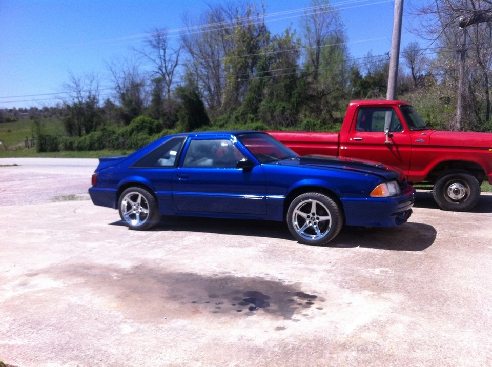

    And here's the car sitting all pretty now. Pictures obviously don't show the difference, but in person there's a HUGE difference between what it looked like right after paint, and what it looks like now.
    I also put new hatch shocks on and put my quarter windows in. Made sure to use plenty of 3M window weld on them so they'll seal up good. I've ordered new windshield molding and roof rail moldings as well since mine were all mangled and nasty. And I'm going to order springs tonight so this thing will sit nice and low lol. If everything goes right, I'll probably have it back together in the next couple of weeks hopefully :D

    What color did you paint the rear interior panels? I think the first picture is probably a little off but the RH panel looks silver. I'm guessing it's grey?

    Yes sir it's grey. They look really good in person, but of course cell phone pictures don't capture everything perfectly

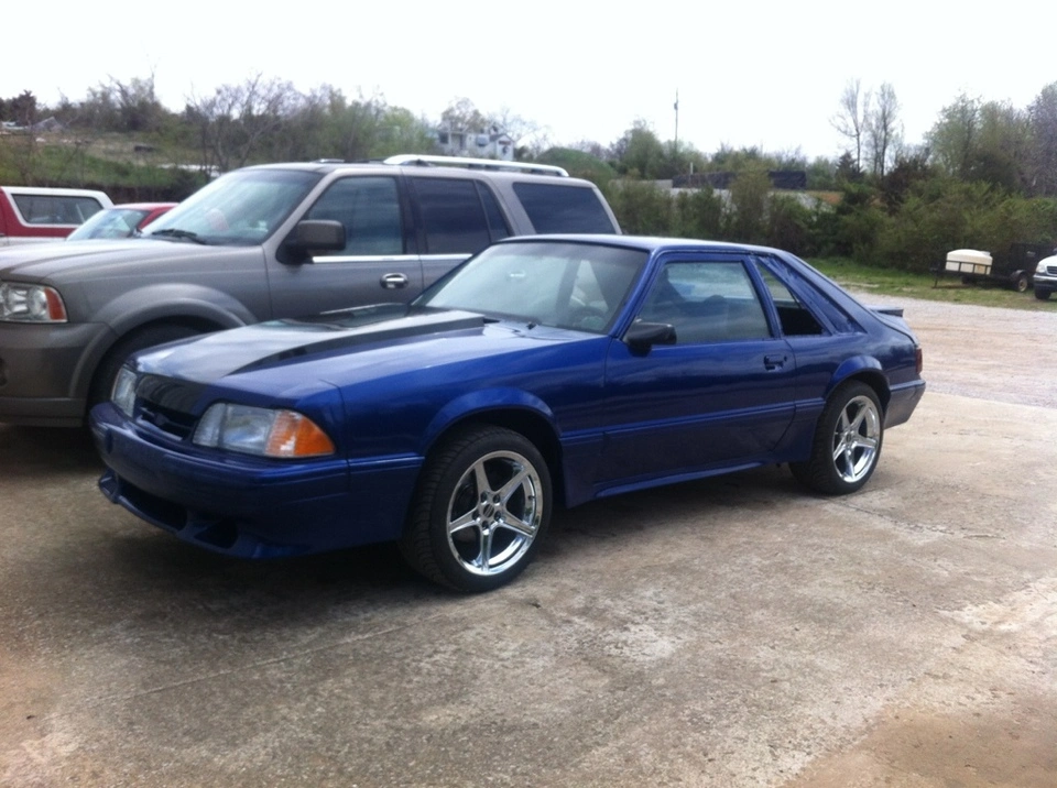

    Here it is with some actual sun light on it. The quarter glasses make it look so much better :p

    I just realized you didn't paint the window frame black, kinda gives it a t-top look in the pic.

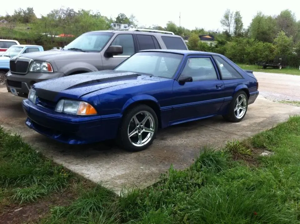

    Here it is after lowering it. I lowered it an extra 3/4 of an inch in the front after this picture was taken by swapping around some of the components of the coil overs. I haven't taken any good pictures of it since then. It's been rainy and there's pollen everywhere so my car looks like a giant blue-yellow turd right now. And I'm basically burnt out on it. I've got a popping out of the passengers side exhaust that I just can't seem to resolve and I'm getting coolant in my oil. I'm thinking I messed up months ago when I had to swap lifters out. I think I messed up the intake gaskets somehow when installing the intake. That's the only thing I can think of, because I'm really hoping it isn't a head gasket. Oh and speaking of the intake, I'm getting oil in the upper plenum. I'm pretty sure when I put the engine together, I left the screen out for the PCV valve and it's allowing engine oil to be sucked up into the plenum. So pretty much I'm going to be ripping the intake off for a second time. Hopefully I won't be pulling heads off.

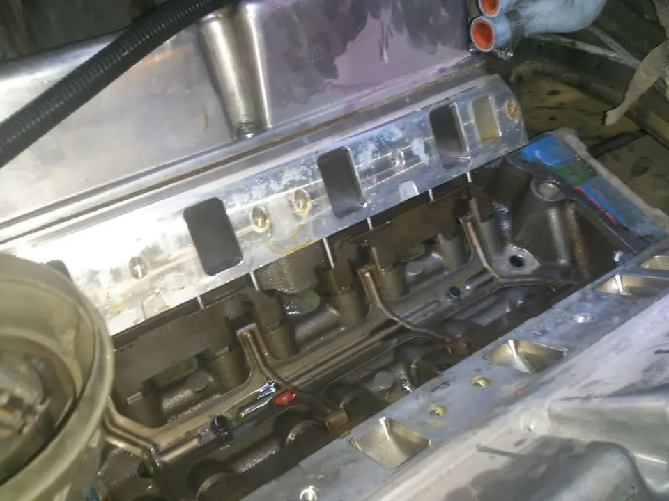

    Well tonight was the first time I've worked on my car since my last post. Took the intake off to check to see if that's where my coolant leak was. Sure enough, had antifreeze up in the lifter valley. And one of the tabs on the head gasket that holds the intake gasket up into place was all bent and mangled up. So what I'm thinking is that back when I had the intake off last, I bent the tab and the intake gasket wasn't being held into place properly, and got it misaligned when putting the intake back on. And I'm hoping that I'll also resolve the popping out of the passenger side exhaust after I get the intake gasket situation all fixed up. Because I'm pretty sure the messed up intake gasket was on the passenger side (the bent head gasket tab was on pass. side). But I honestly couldn't get that lucky. So my next post will probably be b*tching about this thing again :lol:
    If this fixes the popping and my coolant leak, then all that is left is interior and a few little miscellaneous things :)
    Oh and what's the point of a thread without more pictures?
    random picture of engine with intake off. You can see the antifreeze tucked up into spots in the lifter valley
    And I guess some more noteworthy things to bring up are that I ran my speedometer cable finally and I fixed my chewed up trans harness. I should have just bought a used harness, repairing mine was an absolute pain lol
