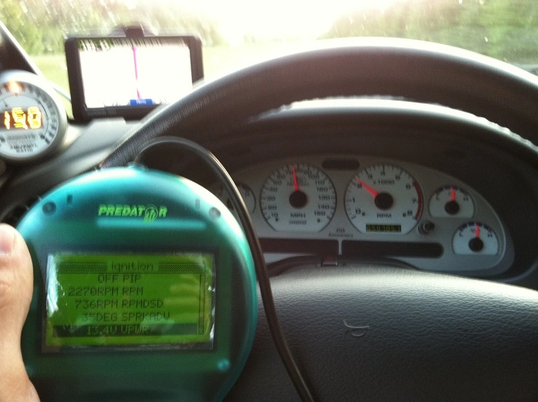

With 4.10's I've hit 113 in the 1/4 on a 26" drag radial. Was turning right around 6100 according to the tach.
I also have seen 25mpg highway with 3.27's as well as 4.10's. This will always be a never ending debate, but any N/A 2v needs a steep gear.
