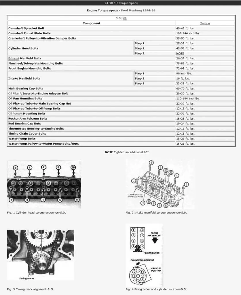

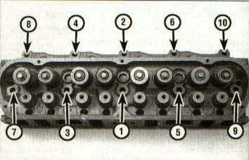

  1. Does anyone have a list of torque specs and sequences for an 89 5.0?
    Particularly, lower intake to cylinder heads and upper intake to lower intake.
    My list has been eluding me, any help would greatly be appreciated.
  2. Thank you sir
  3. You need to PM that to young Skywalker, Mad. He needs that desperatley.
