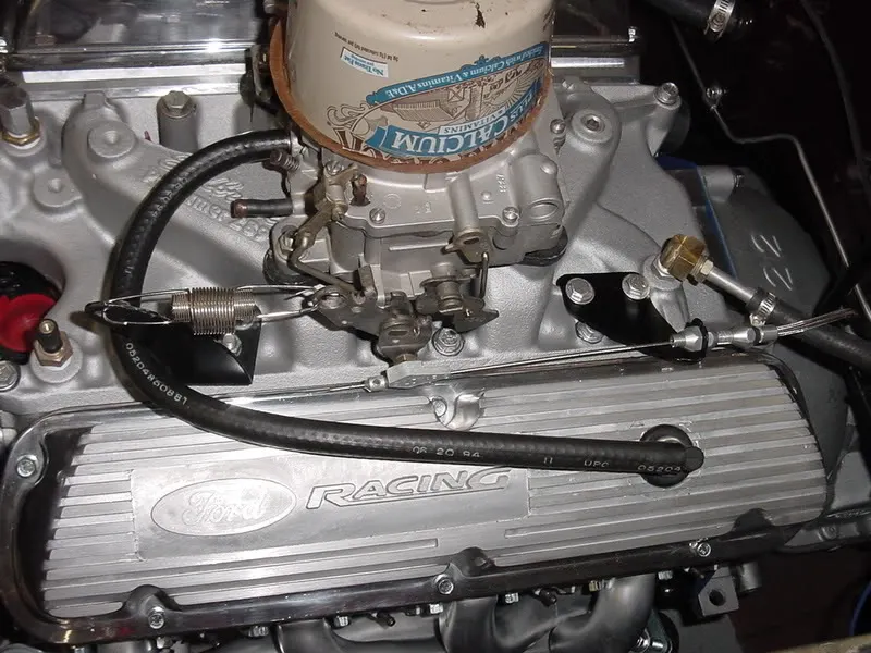

The placement of the pivot on the carb depends on the length of the arm on the trans TV shaft. Measure the amount of throw on the trans and compare it to the distance on the carb lever. You may need this:
On mine it worked out where I could use the existing hole on the Edelbrock and I made my own cable bracket.
