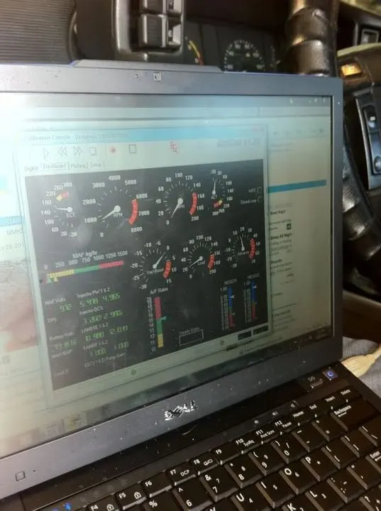

    The twEECer pays of itself. We used it to check out the 92GT we were buying, don't have to send the MAF to get recalibrated, we won't need any type of custom burned chip after mods. It's such a great tool.
