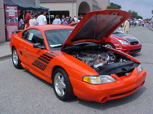

  4. is it possible? in fact yes, just about anything is possible given enough money and time. is it practical? in this case i would have to say no. it would be more practical to find a 94-95 with the V8 and build that instead. now if you were doing something more like this;
    then dumping the V6 is the way to go as everything needs to be redone and custom built anyway.
