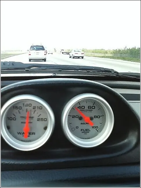

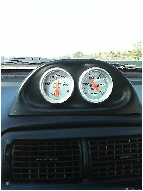

  8. I ran 2 bottles of water wetter in my 94GT and C&R Aluminum Radiator from Steeda. My car rarely went over 210 degrees and I used Auto Meter gauge to track. These pictures taken while in July with 100+ Temps in South Florida. It really does work.
    This with a 347 Stroker, AFR 185CC heads, Holley Intake, Custom Crane Cam, 75MM Throttle body, 1-3/4" Long tubes Ceramic, P.M.S. tuned.
  9. What was your formula % and coolant/water color results after 6months??

  16. Distilled water like 60/40 really. My car was never a daily driver. The aluminum radiator, 180 stat, water wetter and this mixture was just perfect all year around. Here in South Florida we don't deal with cold weather at all.
