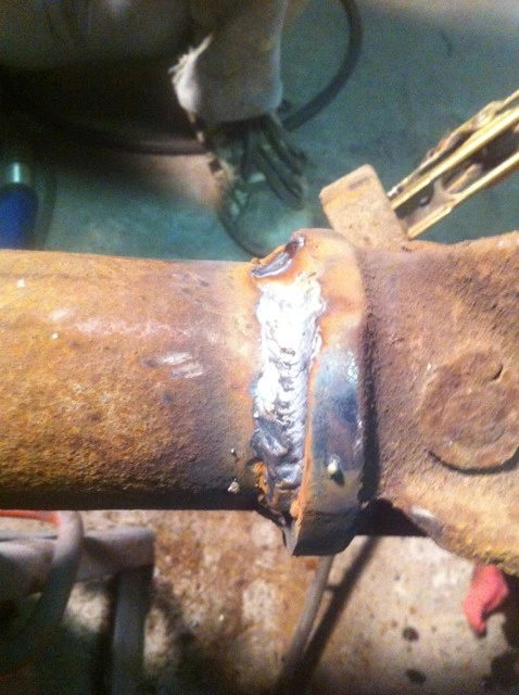

  9. what seals are you even referring to , I did mine it wasn't too bad , go slow low heat , tack 4 spots do a stitch , let it cool do another stitch etc ... axle seals are on the outer part of the tubes on the axle side and the pinion seal is on the back if its gonna leak you will see it .Mustang and fast fords has a write up on it
  10. ImageUploadedByTapatalk1355441032.538152.jpg one of the stitches
  11. you want to weld in small sections at a time. instead of a steady hot bead around the tube that will distort it. weld in sections and then fill it in.
    Edit: doesnt matter now
  12. That's what I did I described that too him . I went in 4 small sections and just made 4 tacks as a reference

    this is a MUST do if your going to run a stickey tire on an 8.8 housing! your axles tubes are held in with just 2 plug welds on each tube and these can and do break out from time to time
