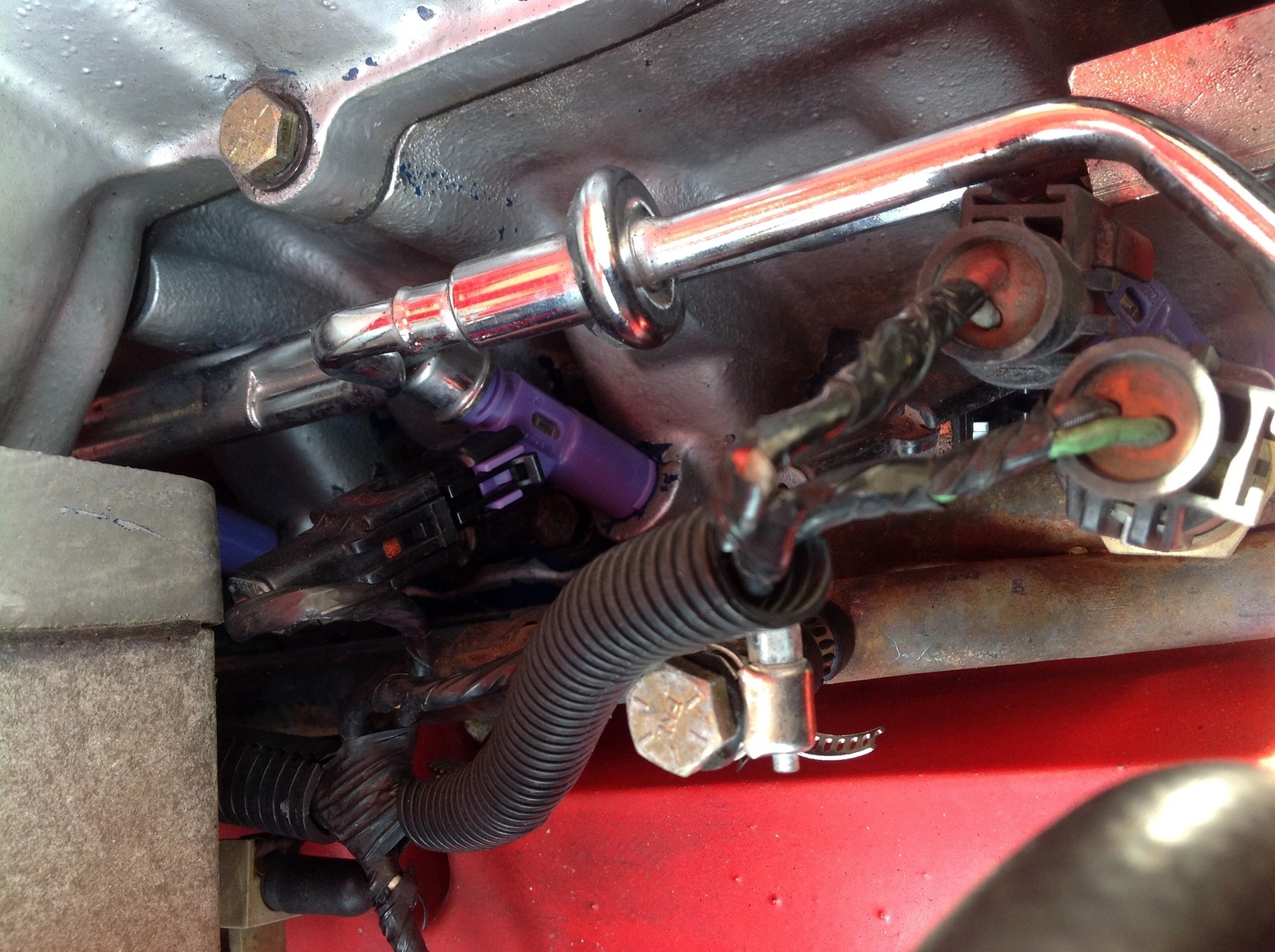

  1. First off if this has already been answered I'm so sorry for repost but I've searched for a couple days and can't find a solid answer. I have an 89 lx coupe 306 (possibly stroked as well) I recently picked Up. The guy claimed it was "ready for a turbo or supercharger" what's throwing me off is that it has purple injectors on it. They clearly say fomoco on them and the serial is 9l3e-fa. Anyone know what lb they are? I've seen some say 24 and some say 64. Thanks in advance to everyone
  2. There definitely lighter purple than that

  4. Just uploaded a pic in my last reply
  5. 51st pic in my link and @Noobz347 also found them, deeper lighter shades are common on web pics.
  6. I think I found the ones you saw. Link says 24 lbs. yet I've seen other say 64. Can't seem to find anything solid on these damn things
  7. Crap finally found em. They are 24lbs. Thanks everyone. For some reason that was giving me hell

  9. Didn't realize there were so many different purple injectors. And with no pics I wasn't sure what I had.
