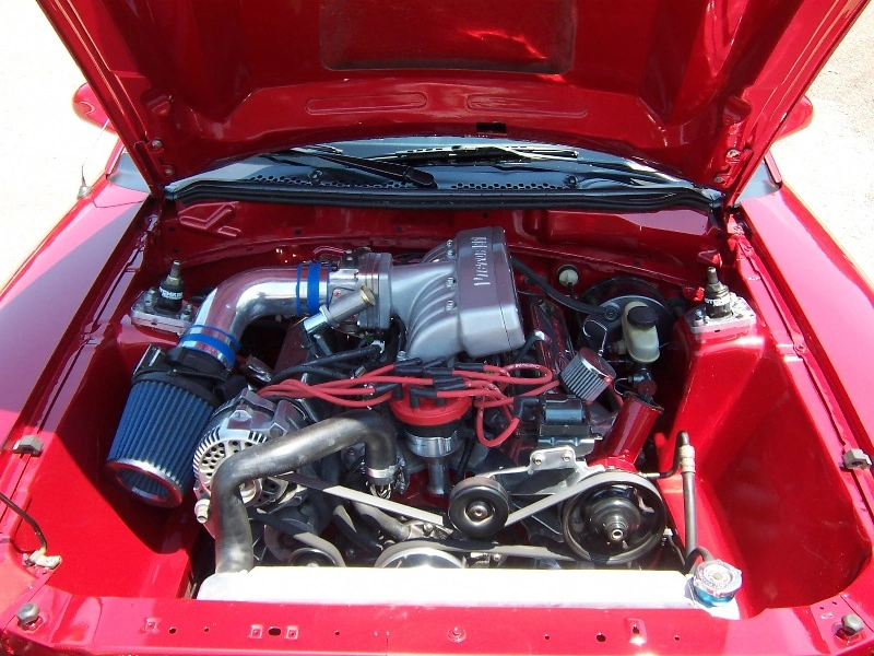

    Low5.0 do you have pics for your Victor 5.8 set up?

  10. 75mm opened up to 80mm. I like it, but I've never had anything else to compare it to. IMO, the TF box intake is better, but you have hood clearance issues with that one.

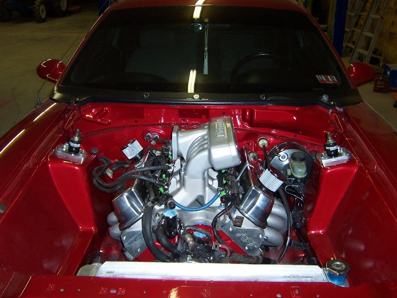

  16. If all of this does happen and I hope it does then I dont plan on keeping these heads anyway. I wanted to go w/ a set of AFR 205's, I would also do a fox style set up for the TB. Like Low5.0 said I need to talk to Ed and see what he thinks Im not making a dedicated track car b/c I still drive it on the street often so driveability is important. My goals are to run 11's and net 400+ RWHP. According to Rick at RNH performance the Victor 5.8, AFR 205 (Ed cam) combo will give me those goals.

  18. Ive never been over 339 so I guess it will suit me for awhile. Im also going to run the fox set up w/ an accufab 90MM TB and have Tmoss port the upper/lower and open the upper opening to a 90MM to fix match the accufuab. I got an e-mail back from ed and he said the cam I have now will work fine he just wanted to see me upgrade the spring kit to suit the AFR 205's. So over all looks like everything is planned out now just just a matter of saving up and getting it all
