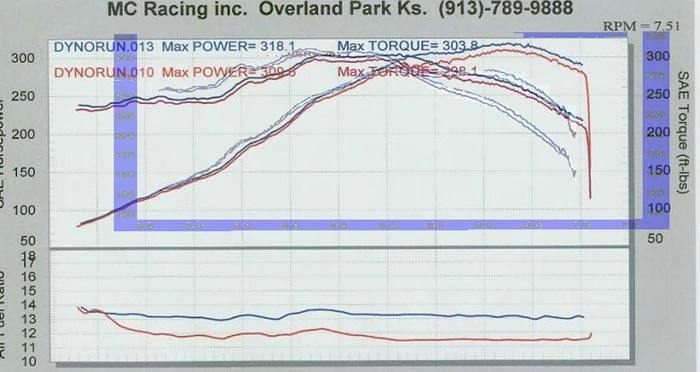

  8. It takes quite a bit of bolt-ons to hit 300+ rwhp on an '01.
    I had:
    JBA 1 5/8" ceramic headers
    Magnaflow catted X-pipe
    Magnaflow Cat-back
    Steeda U/D pullies
    C&L Hi-Flow Maf & K&N filter
    WMS ceramic TB to MAF tube
    FordChip custom tuned EEC
    and my ending dyno was like so:
    [​IMG]
    I'm assuming that he has most - if not all - of the same (type) mods on his car.
    Note that the rwtq of my completely modded '01 4V isn't even close to the '03 4V with just a K&N filter?
    This is (one of the reasons) why the '03 Mach 1's are consistently faster in the 1/4,
    in addition to the better 3.55 gearing and lighter weight due to the solid axle vs IRS.

  12. Angus, nice #'s
    one thing to note however, is that even though your Mach 1 makes more peak tq..compare the curve of the tq between the two from 5k-7 rpm.... the moded 01 has an advantage on the #'s
    one thing that is funny is, noone ever said the Mach1 is slower than the 01 in the 1/4, only that it is close enough to come down to a drivers race.

  18. here is a bad photoshop....
    but its Angus's Dyno sheet.... see what I was talking about from 5-7krpm... peak doesn't do much
