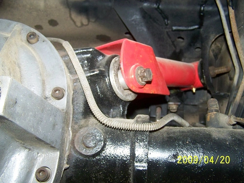

    On the UCA, take a look at it. One end has a bushing. The other end is open. The bushing end bolts to the body UCA mount. The open end bolts to the axle. On the axle, is a bushing. If yours are dry rotted or torn, you should replace them. Not needed, but a decent idea. Crawl under and take a peek at the condition.
    Here's an example, your's will look different, but the bushing is pressed into ears on the axle

  20. Mustang5L5 may very well correct me on this one but when I swapped my stock UCAs last year the kit I bought from MM (with the same part number as you listed) included the axel bushings - I believe...
    However, unless your upper control arm axel bushings have been replaced within say four-five years I recommend you to change the bushings anyway.
    The replacement bushings from MM are much better than the original ones as far as fox bodies are concerned.
    Regarding the MM tool, if you cant rent it then buy it - you'll understand why when you are under there doing the swap!
