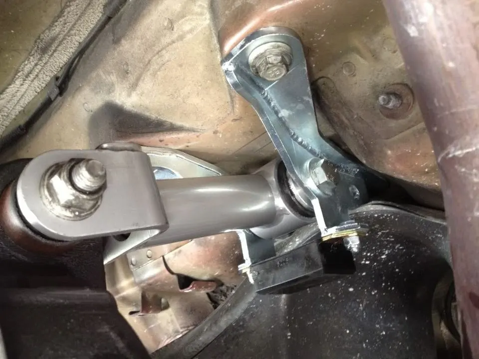

  10. I will be installing a Spohn Del-sphere UCA in a few days by itself and will report back.
    Axle windup (main cause of wheel hop) is controlled by the upper and lower control arms. Since there is only one UCA vs two lowers, it's reasonable to say that the upper will have a bigger effect.
    Avoid the temptation to put upper or lower arms on with poly bushings on both ends. The arms need to twist as the suspension articulates. Poly bushings do not allow this and will bind.

    I just installed a Spohn adjustable poly / del-sphere panhard bar today. I'm happy to say that I haven't noticed any increase in NVH from the change.
    It's also worth mentioning that when I installed it, it was set to the factory length, but I did have to clock the del-sphere joint. With the mounting bolts torqued down and the car at rode height, the del-sphere joint was near one side of its range. A quick tweak with a wrench and it was right in the middle.
    I had wondered whether it was necessary to include an articulating joint in the panhard bar. But after seeing some misalignment between axle and chassis side brackets and then factoring in axle wrap, it makes a lot of sense to do so.
