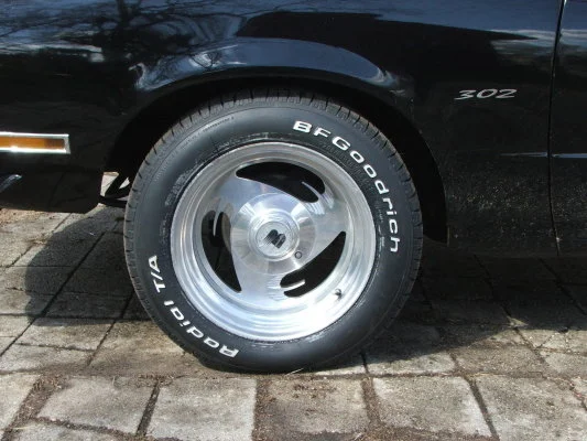

    Sparxx, I know you were looking for a bit of stagger in your tire/wheel choice. With the one tires that Vamp_77 is using, you get about a 1 inch diameter difference between front and rear:
    Front: P215/60R14 = 24.2 in. diameter
    Rear: P235/60R14 = 25.1 in. diameter
    If you go to a wider rear you get slightly more:
    P245/60R14 = 25.6 in. diameter.
    These numbers are off of the BF Goodrich Radial T/A table here:
    BFGoodrich Tires | Radial T/A® | Tire Sizes & Specs
    If you were to drop the front by an inch (by cutting 1/2 coil from your springs), you could get significantly more rake than you could get with just tires and wheels.

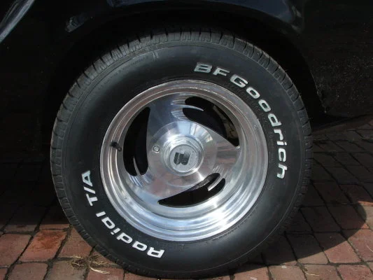

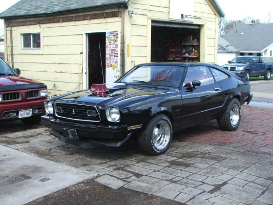

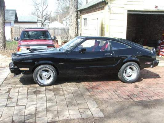

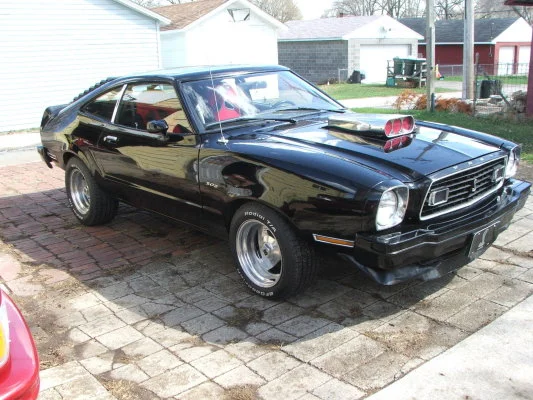

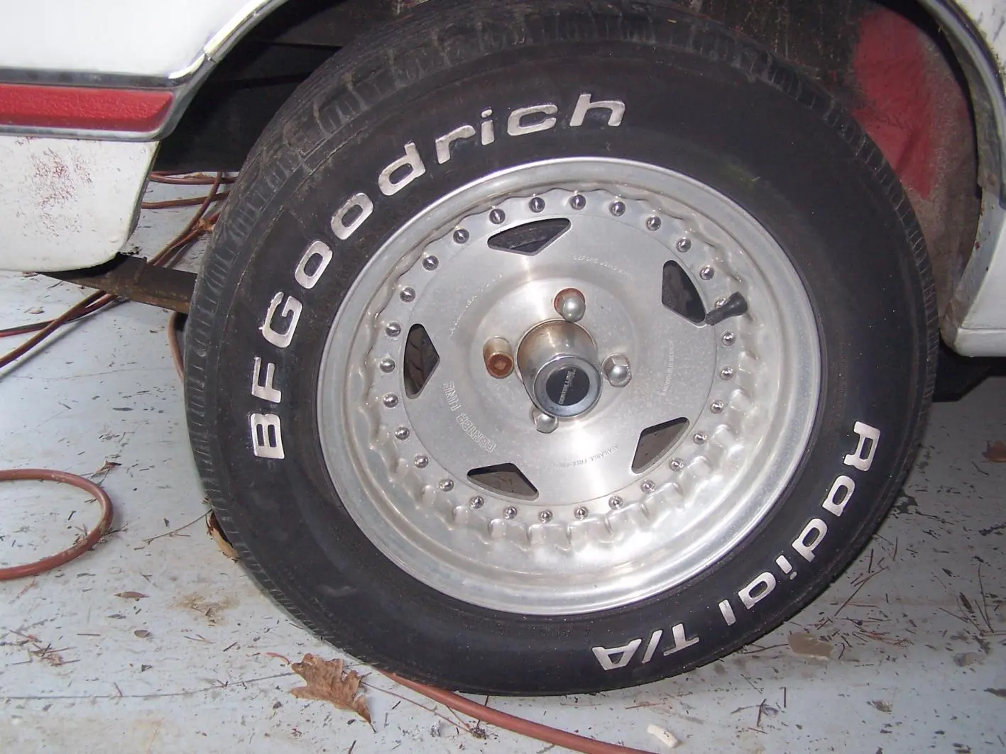

    Ok finally got a new (new to me) rims and new BFG Radial TA's mounted and on the car. The rims are Billet Specialties 15x8 with 4" backspacing. The front tires are 205/60/15 and the rears are 245/60/15. I have air shocks in the back and they have about 80 psi in them in the pics. With them down to 15 to 20 they are really close to the top of the wheel well. Questionable if I would drive with it that way. Other than that I did roll the inner lip alittle just for peice of mind. The fronts I also rolled the fenders and had to bend the lip at the rear of the wheel well. I then moved the rear of the inner fender all the way back. So far haven't had any problems.
    [IMG]
    [IMG]
    [IMG]
    [IMG]
    [IMG]

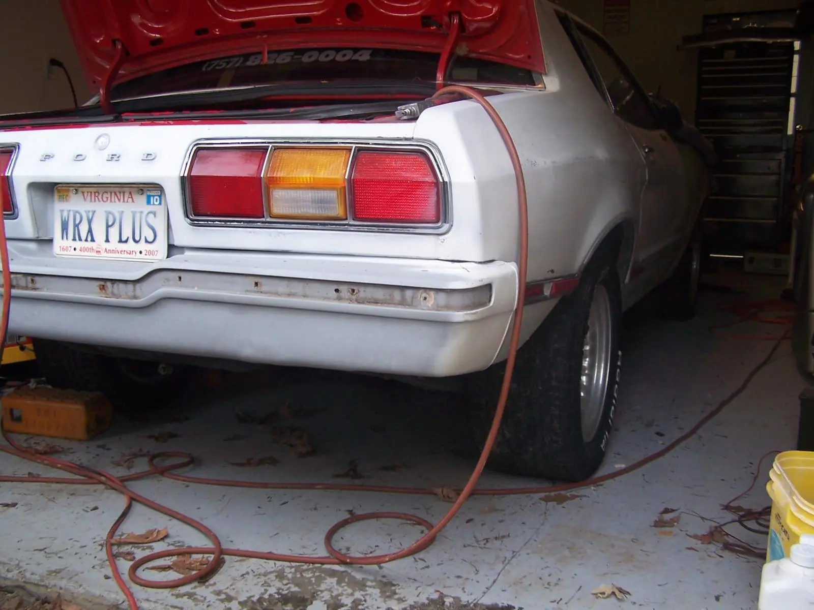

    Here's the pics some one asked for, I've been offline for several months, working and modifying my car, it's all to peices right now.
    The fronts are 155 80R15 and the rears are 265 50R 15, there are no spacers being used, and for clearence I had to remove the bolts from the frame mounted bump stops. The rear is spooled with 3.55 gears (4.11 for race days). The only time I get tire rub (on the springs) is hard acceleration 90 deg. turns on a bumpy road (like from a stop light or sign).

    For some reason the site is only allowing me to post 2 pics.

    oh we need more pics if not email me some more. i plan on running the 265-50-15 on an 8" wide wheel with 3.3/4" back spacing.if not the 265 then maybe the the 275. i like the low and wide look :nice: BTW on the front i will be running 236-60-15 on a 7" wide rim and yes my car is lowered.
