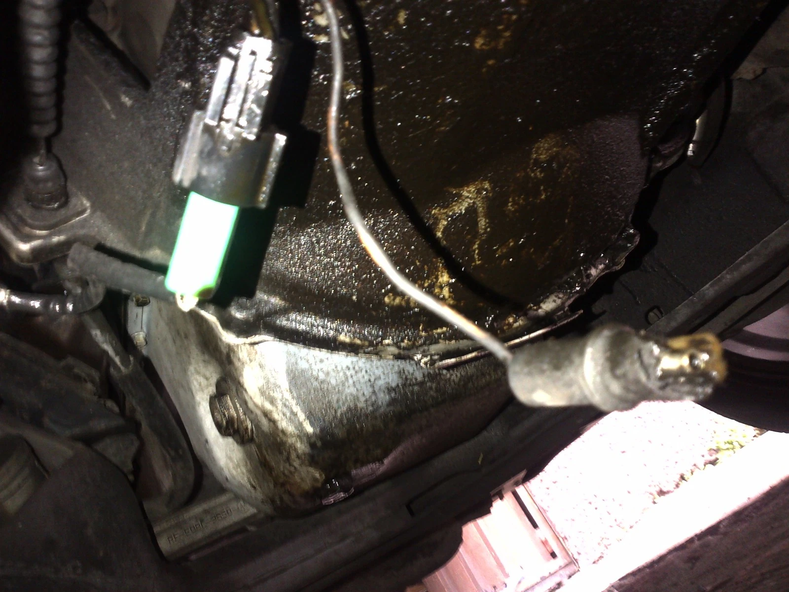

    there are 3 wires going to the oxygen sensor connector (driver side), but along with those 3 cable is a cable with a piece as seen in the photo, where it is connected and that connector is?

    Neutral safety switch.

    Maybe Im missing something, but that broken connector in the picture is not for the NSS. Its for the Low Oil Level Sensor.

    Definitely the Low Oil Level sensor. I just got a new O2 sensor harness and it has the 2 O2 sensor connectors and 1 for low oil level sensor.
