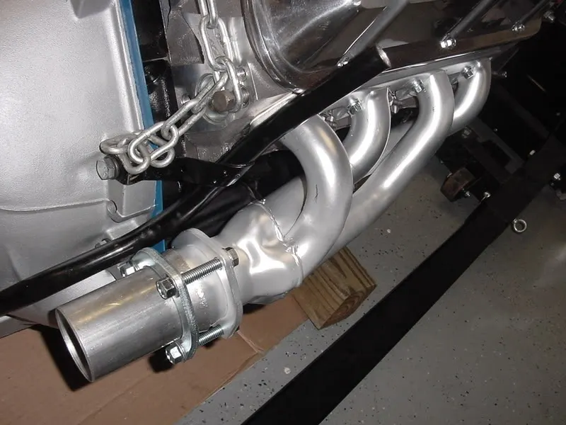

The hedman long tubes will not fit out of the box. not to worry, not many long tubes under $500 will fit. i ended up cutting it near the collector and rotating it to clear the bigger trans. i also had to make a notch to clear the shifter linkage. it scrapes on the big speedbumps, but its too late to return em.

only the drivers side needs modification. the passenger side is fine as-is

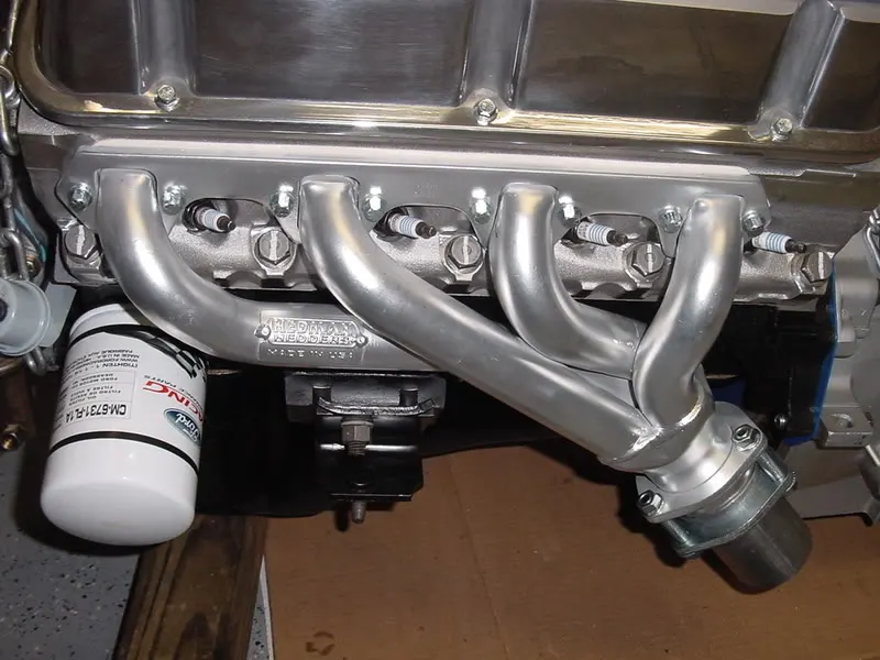

i need to also mention, that i had an older set of black-paint hedman longtubes that fit the driver side fine, but the passenger only works for C4s. if you get into a bind and want my driver side header, it will work.
if you want the easy route... just give up a few horsepower and get shortys or mid lengths.
i saw doug thorely mid-length headers at a swapmeet that looked like theyd work
