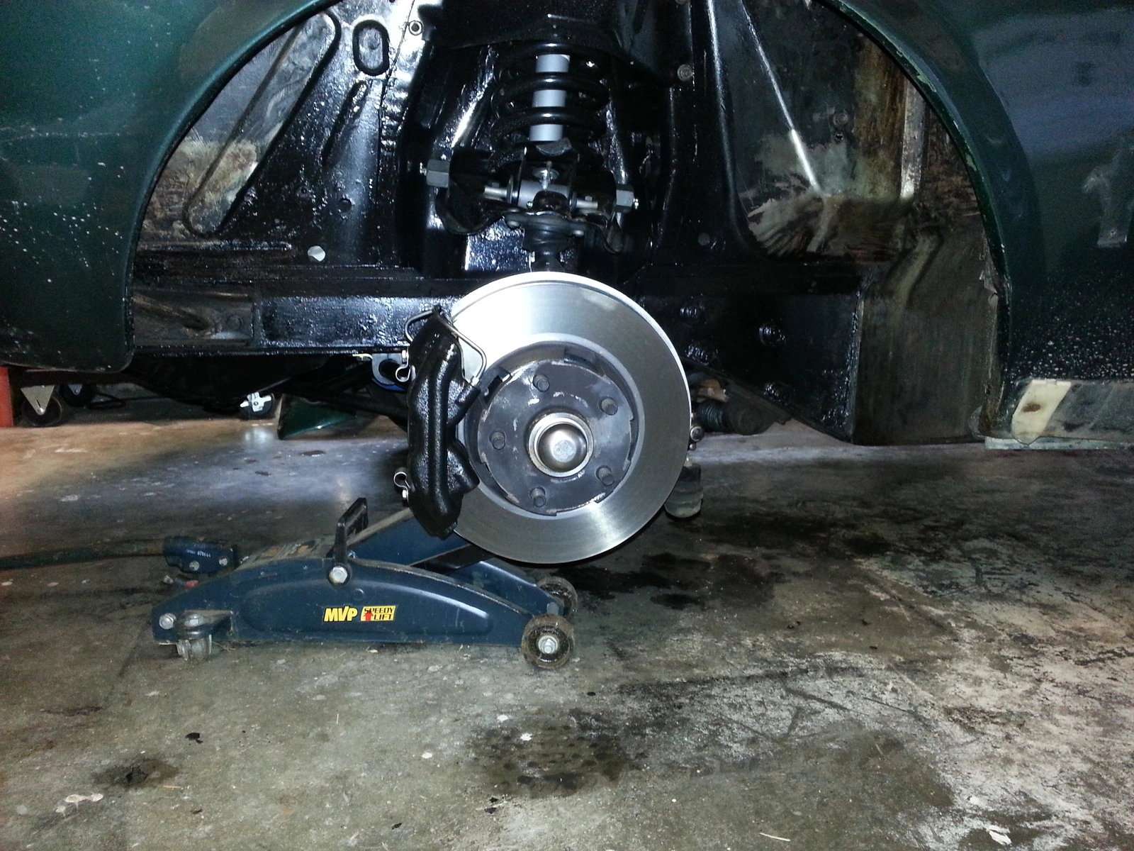

  6. I just used brake kit from SS brakes did not have to change anything 20130205_140038.jpg
