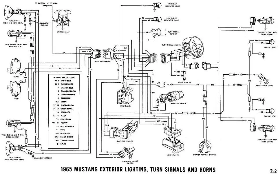

have seen posts regarding this question, but after about an hour of trying to research them, I'm giving up an will ask the questions again. We've installed a FR tilt column in our 65. for the wiring, we're running into some problems. this vehicle does not have an emergency flasher. In following FR's wiring guide ( which is questionable) having some problems. We have a new main harness which is for gauges. Currently we do not have the brake light switch wired to the column
When we turn the ignition switch on, BOTH rear turn signals come on and flaah. This is with the tun signal switch in the "neutral" positon. The front turn signals do not come on at all.
According to FR the wiring should be:
Color
FR White - Brake light Switch to - Must green/red
FR D. Green - RR Turn Signal to - Must orange/blue
FR Yellow - LR Turn Signal to - Must green/orange
FR Purple - TS poweer to - Must white/red**
FR Brown Hazard Power Must not used
FR Dk Blue - RF Turn Sig to - Must white/blue
FR Lt Blue Lf turn Sig. to - Must Green/white
**Our main harness does not have a white/red wire.Currently we're using the blue wire from the flasher to the FR purple wire.
Several months ago, someone posted a different wiring diagram other than the standard diagrams and that appeared to show power coming from the fuse box thru the flasher and going to the turn signal switch. this wire is blue - note all the color codes on this particual diagram match all the standard wiring diagrams.
any help or links would be helpful
Thanks Ralph
