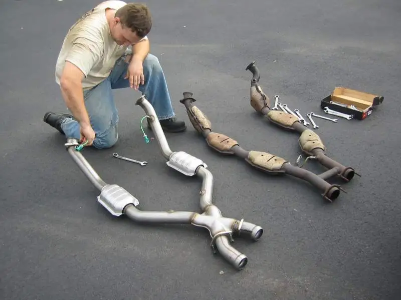

My biggest problem was that one of the nuts that connect the x pipe to the cat back was lost. The UPS box had a tear in the corner and the nut had fallen out. We tried a few hardware shops but none of them could match the threading or thread type. So I drove around with only 3 out of 4 nuts on until Magnaflow sent me a few moreSRT Handz said:Hey JonJon,
