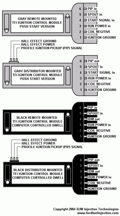

  3. I went on fordparts.com and it listed part# DY425 for 90-93 Manual transmission,DY504 for 90-93 Auto transmission,and DY1284 for 87-89 but it didn't state whether the 284 was for manual or auto and didn't even list the DY1076 module at all.Rockauto listed both DY1076 and DY1284 modules but didn't state which one fits the auto and which one fits manual.It has to be the right one cause a auto module won't work on a manual because the manual module has to allow the push start feature I believe so you can roll start it if the battery is dead,etc
